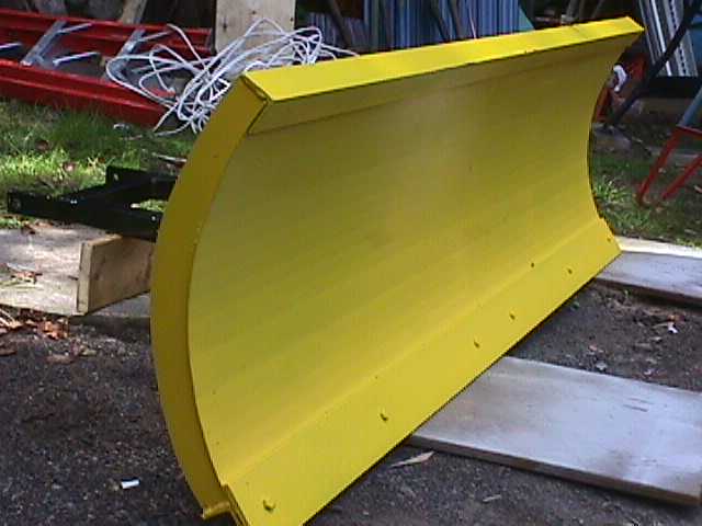

Have followed lots of discussions on tractor plows and added my 2 cents from time to time.
Decided I wanted to be ready for the white 'yuck' stuff.
In keeping with my thoughts I went for a 'straight line' push setup to avoid light stearing.

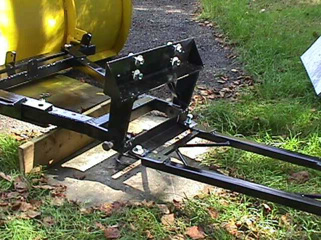

Here is everything all lined up for attachement.
I decided not to do the traditional 'turntable' arrangement due to the narrow frame on my tractor, but still wanted the possibility of plowing off to one side.
This pic is in the straight 'push mode'
   / SNOW PLOW for my MT180D
Another rear view in straight push mode.

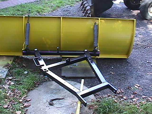

This pic shows the plow angled to the right.
What I did is essentially create a custom channel to extend the left side.
The push frame is made from 2" X 2" X 1/4" sq tubing and the hinge (rt side) and left extension are 1/2 X 2" with the pins being 3/4" graded bolts.
All ears and pivot stock is 1/2 X 2" with 3/4" pins.

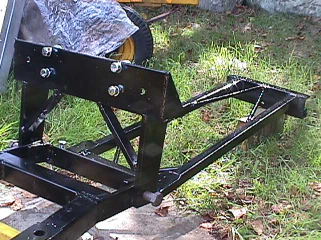

Tractor attachement rack.
The top is 5/16" 3 x 3 angle stock with the down legs 1/2 x 3" stock.
I cross braced and used 3/8 2 x 2 angle at bottom.
This bracket is attached to the front tractor 'bumper' with 4 1/2 bolts.
Nect pic will show how I transfer the stresses back to the loader frame.
Since my tractor has a beefy loader frame, I opted to transfer all the loads back to the main cross member which is factory designed to take much abuse.
The cross member is 1" thick by 2 1/2' solid stock.
I fabricated a channel to 'cup' up against that cross member.
The arms are 1 x 1" x 1/4" wall tube with 3/8" tabs (gussets?) where they bolt to the frt down rig. Bolting is grades 1/2" bolts and the tubes were trimmed so that they but up to the down frame so as to not rely only on bolts.
Notice the cross bracing.
Tricky part was to be sure to clear frt differential and wheels in all possible position combinations.
Since I could jack the frt end up with the loader the task was relativly easy.
While everything is painted, trust me that all was trial fitted before prime and paint.

Your plow design and fabrication is looking good, and I'll be anxious to see a pic of the plow on the Mitsubishi.
Maybe I missed it, but how wide is the blade?
Before I get swamped with ??'s
The blade is 6' wide and 22" high (tractor is 4' wide) so that when angled I wont be compacting my snow banks.
The intent was to clear the light falls with blade and then use the blower for heavier stuff.
There are 5 ribs made from 1/2" stock and the blade is 1/8" from an industriel work bench top.
The cutting edge is 3/8 X 4" galvanized flat from scrap yard.
Blade has 2 x 2 X 5/16 angles top and bottom.
Total costs as follows: (Cdn $)
Bench top $10., Recycled steel $40.00. Curving of the blade by a shop-$35.00, cutting of the 'ribs' (incl stock) $75.00, Bolts
about $25.00 . Springs $12.95 ea
My labor, including painting about 24hrs.

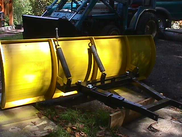

As requested, a pic of my project plow mounted and awaiting snow.
To note, a short length of chain links the plow to the FEL cross arm.
The lift of the plow is then accomplished using FEL lift valve.
   / SNOW PLOW for my MT180D #12
Looks to me like your good to go for the snow. That plow ought to save you a lot of serious backbreaking shoveling.
   / SNOW PLOW for my MT180D #13
That is a nice looking piece of work. Well built and strong.
