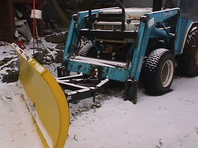

As requested, a pic of my project plow mounted and awaiting snow.
To note, a short length of chain links the plow to the FEL cross arm.
The lift of the plow is then accomplished using FEL lift valve.

Looks to me like your good to go for the snow. That plow ought to save you a lot of serious backbreaking shoveling.
   / SNOW PLOW for my MT180D #13
That is a nice looking piece of work. Well built and strong.

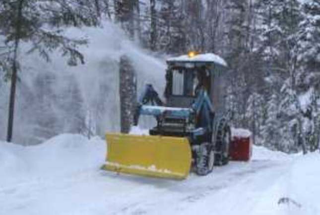

A followup:
We had a 16 1/2 dump of snow Friday.
Now, that was a real test.
In the straight push mode I was able to push so much snow and piled it almost 4 ft high!
In the slant mode I did find that the front wanted to go to the side a bit but it was managable. I could actually turn into the pile.
Remember now that with 16+ inches that snow would come over the top and I was pushing a huge mess in front.
I found that I could push as well as with my truck, but just less in width. (truck has 8"blade)
The neat trick that worked wery well was that I'd peel snow from both sides of the drive into the center and then make one s l o w pass with the blower hence totally getting rid of the stuff rather than building up snow banks that eventually close in the driveway.
Up here, by Feb our drives end up half width with huge banks that are no longer manageable.
I deffinately have proven to my satisfaction that the low level straight line push is the only way to go.
No jacking up the front end and no noticeable loss of stearing control.
As a matter of fact I did most plowing in HI range, 1st and 2nd gear and in 2 wd mode!--meaning that I was operating as much as about 10mph. Not bad at all! (19hp tractor)
Sure, I'll admit a few mods req'd. Minor; I had to lengthen the lift chain linkage as it interfered with a loader arm and also had to beef up the blade ilt return stoppers as I underestimated the brute force those springs hammered back after a blade dump.
All in all a deffinate success for a DIY project.
Remember, Cost was $220 and 20 htrs. A new Fisher plow sells in the $5000. range around here.
El cheepo's (WallyMart and Cosco) do offer manual plows at about $1200, but nowhere as strong as my DIY nor fitted for a tractor.

My neighbor emailed me a picture of me at work!

Bit of an update:
My snowbanks at the road are about 4' high and 5' wide at the base as the result of a heavy snow season and the city constantly attempting to keep the road wide.
Now I wanted to punch holes into the banks so that when the plow passes he would unload there rather than in my drive.
I added a small mod (remouvable chain restrictor to over ride the trip springs action) that allows me to 'bulldose' without the trip springs dumping the blade.
Well was I surprised when I attacked that packed pile of snow!
You'd think that my little 20hp MT was actually a small bulldozer!
Using 2nd low gear and feathering the lift as I pushed I could actually bull over that 4' pile of compacted snow.
Because of the low mounting and straight line push I never lost traction and still had fair stearing control, and that is with 6' of blade.
Last winter I tried same thing with the 4' FEL and would merely have the front lift off the ground and loose total stearing control.
I now have to make the dump defeat over ride into a 'more estethic installation.'
Also I did a very detailed inspection of all attachements, pivots and welds to find that nothing has bent, twisted or otherwise 'let go'.
I have accumulated approximately 50 hours with the setup so far.
Most of the plowing done has been in 2nd high with perfect stearing control.
(unless the leading corner in angle mode catches hard icy snow bank, as would be expected with any plow)
Extreemly pleased.
