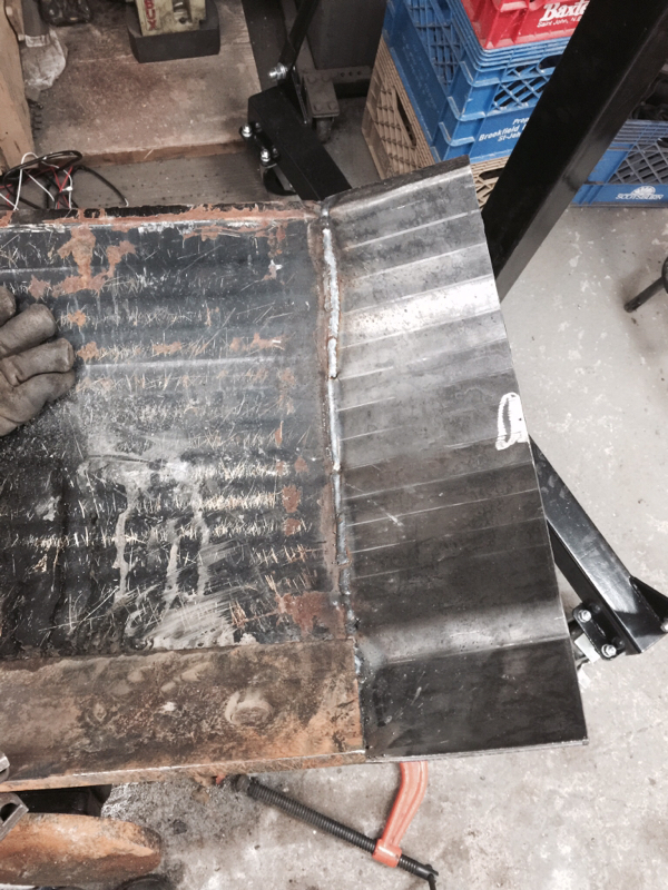

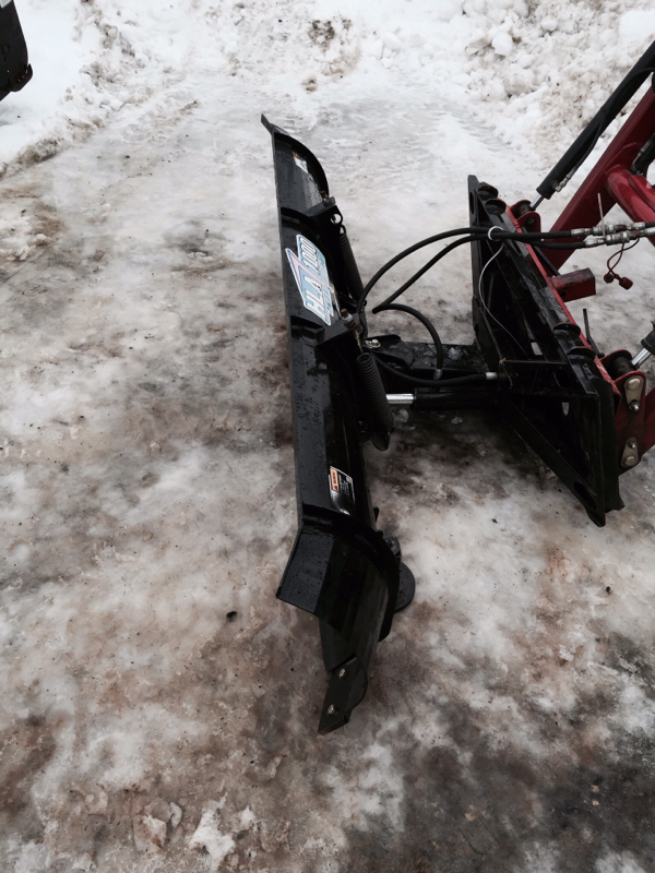

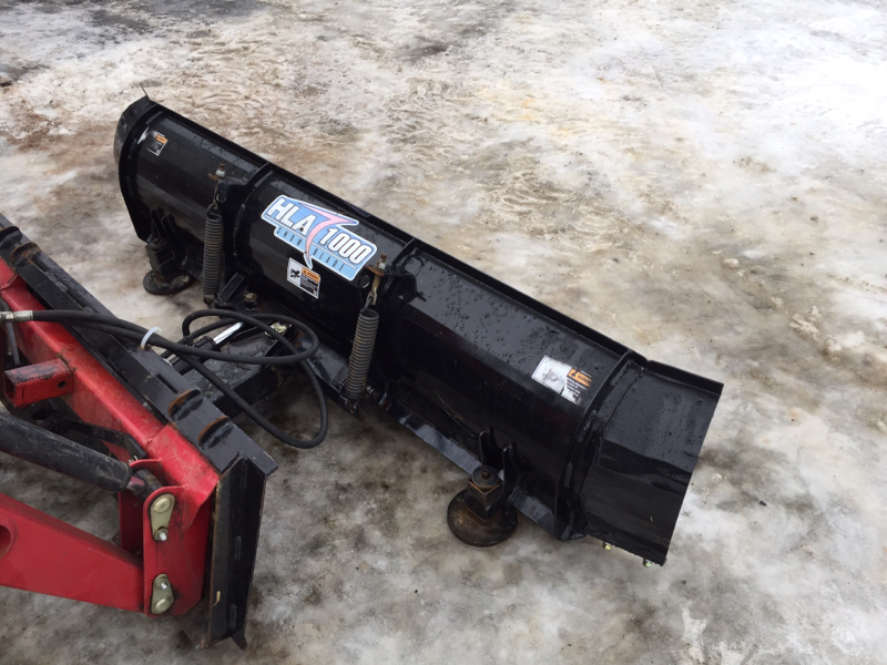

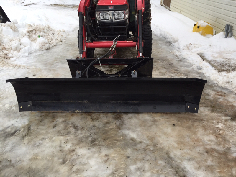

Wanted a wider plow with some wings on the side to help reduce the spillage I get when plowing.

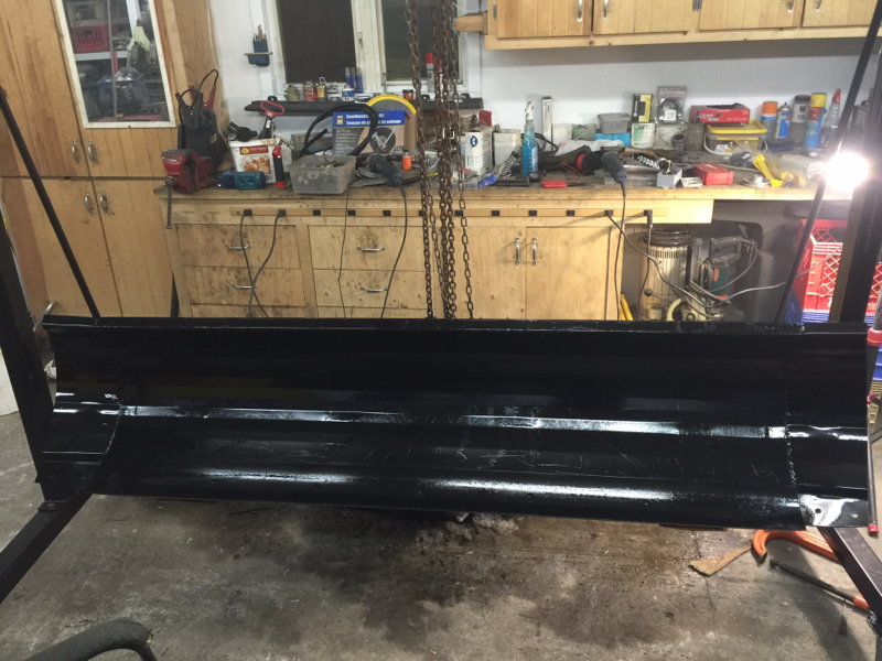

Started out bending up some 3/16 plate to match the profile of the blade and then cut them to marry up at the angle I wanted them.
After that it's was a simple matter of welding them on.
And a coat of high gloss paint so the snow won't stick.
All mounted up with the two small cutting edges bolted on.

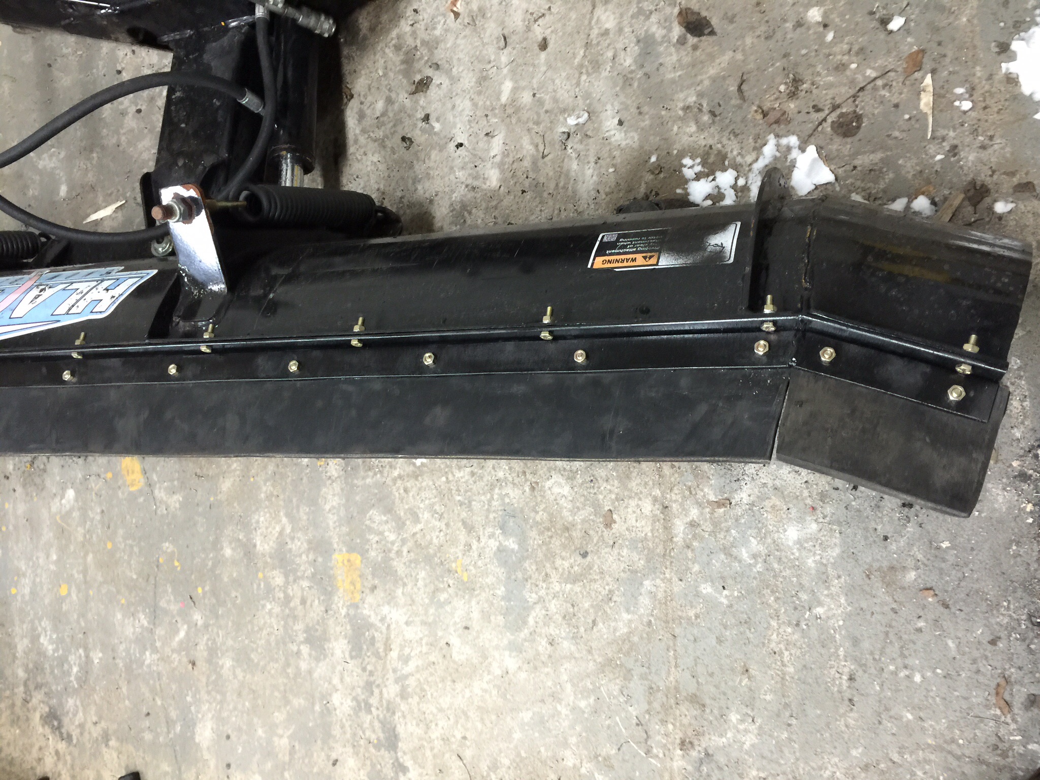

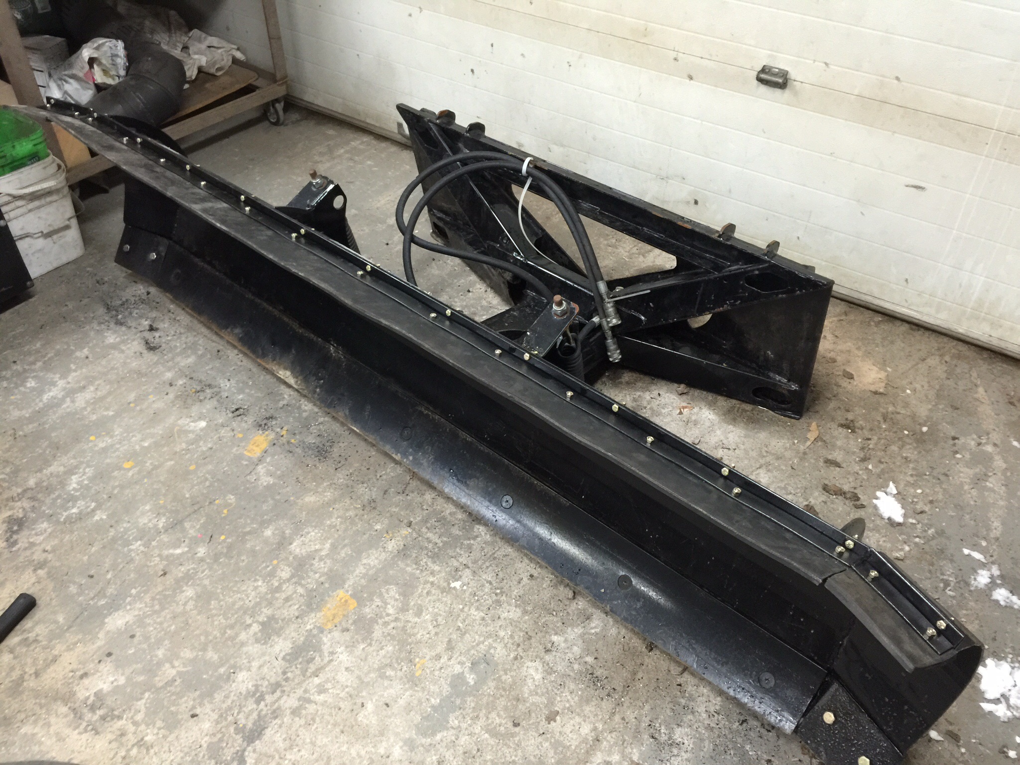

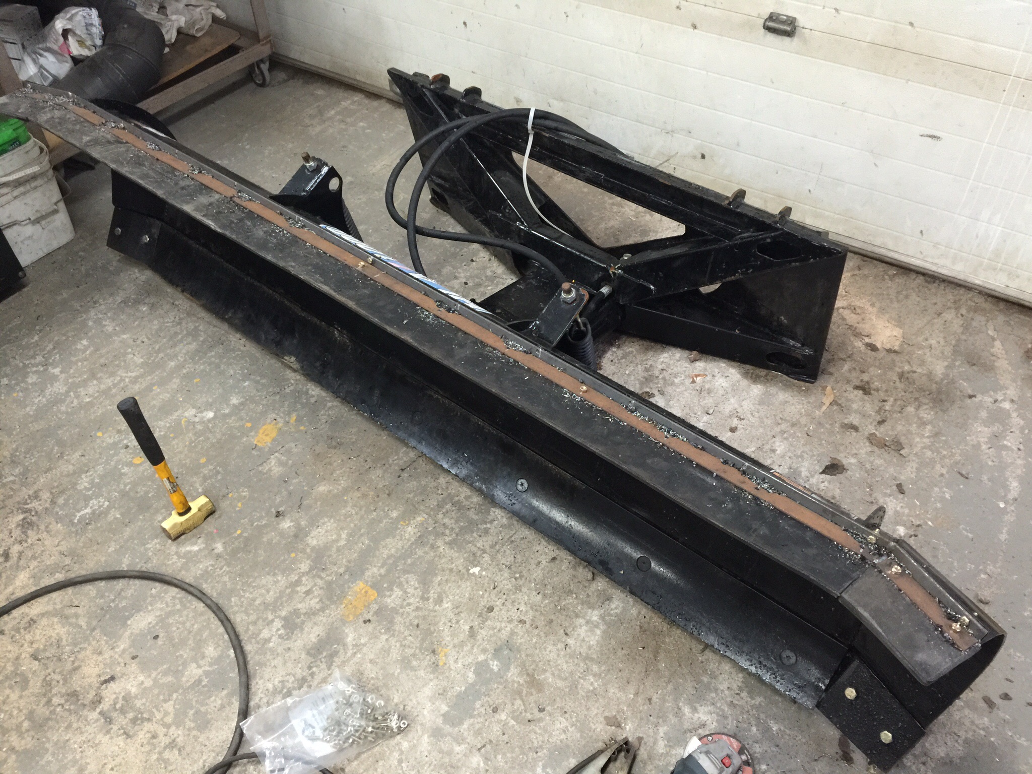

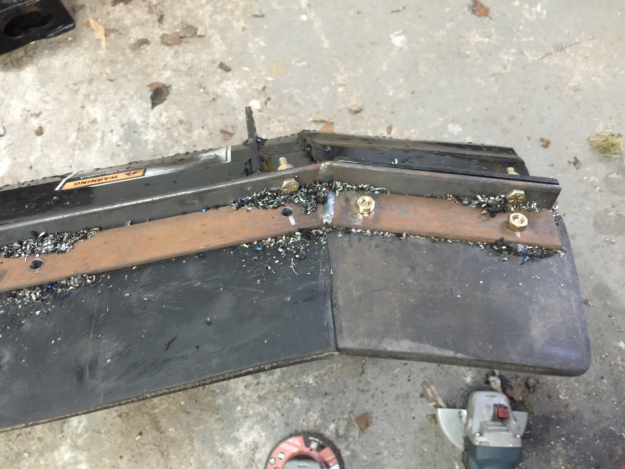

Next I wanted to add a snow deflector to the blade. I bought a 4" strip of convayer belt and a length of 1 1/2" by 3/16" angle iron and a length of 1 1/4" by 3/16" flat bar.
I had to add a piece of angle iron to he front of the balde to get the right angle for the snow deflector. I also cut the angle on the ends to match the wings I added and then welded the ends solid. The angle was then bolted to the plow. Once the angle was bolted on I cut the flat bar to match the angle of the angle iron. Then I added the convayer belt and clamped and drilled everything for 1/4" grade 8 bolts.
All painted and ready to go.

Nice job. That should allow you to carry a lot more snow without it falling off. I've heard the HLA blades are good quality. Was that a 6' blade?
/ Snow plow modifications
The blade is 78". I was going to buy a 90" 2000 series but it was a lot more weight and money. The blade does a lot better job carrying the snow. Very pleased with it so far.

Nice, I'm thinking you should have added some sort of braces at the back of your wings,
if you hit something solid with that wing, it will bend at the weld.
If it's just for your driveway, you should be good.

Nice, I'm thinking you should have added some sort of braces at the back of your wings, if you hit something solid with that wing, it will bend at the weld. If it's just for your driveway, you should be good.
The wings are one piece 3/16" plate bent on a press. The shape itself adds a lot of strength to the blade. The wings matches up perfectly to blade and is welded solid. I had planned on adding braces but I decided to test it first. I plowing a few driveways and a commercial lot with it and ran it into a concrete step (on purpose) and it didn't make a mark on the blade. I thing I will leave the braces off for now. If I bend it I have the tools to fix it.

Looks like a good idea;my thoughts if I did this I would only do one side,some times you want the snow to roll off(roadways ect.)
#11
When I added the wings they were angled so that the snow still rolls off the end of the blade when angled. The added benefit is when it's angled the outer edge helps hold the snow in so you can take a larger cut with creating windrows. I also have a hydraulic angle blade which makes life easier.
