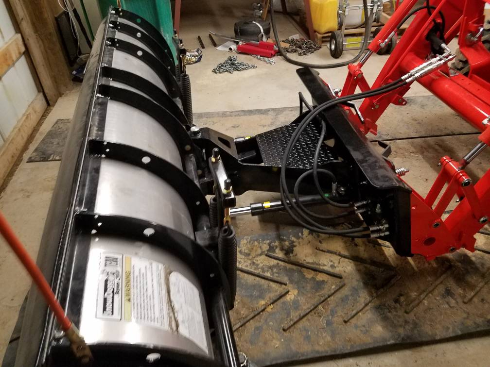

In my opinion, the best way is to remove the bucket and mount it directly to the loader arms.
Having the bucket on there adds considerable length, because you need the plow far enough out front, to have room to angle it.
Ideally, you want a way for the plow to float. And, some slop in the angle mechanism, so it can rotate up or down from side to side a few degrees to better follow the ground.

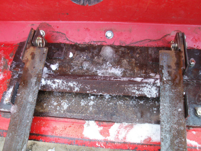

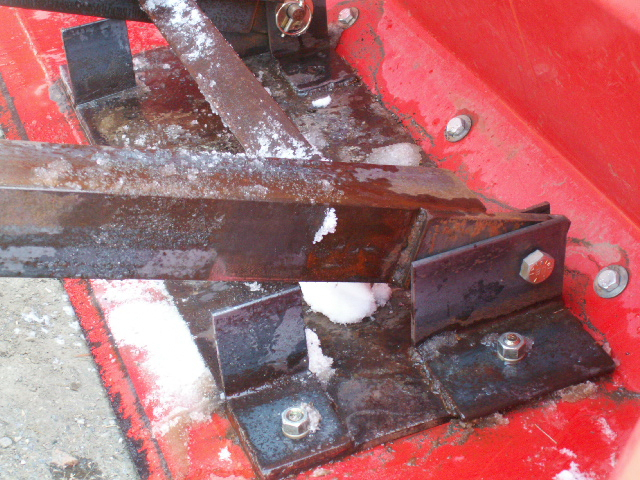

When I had L2800 with plow attach bucket I came up with this.

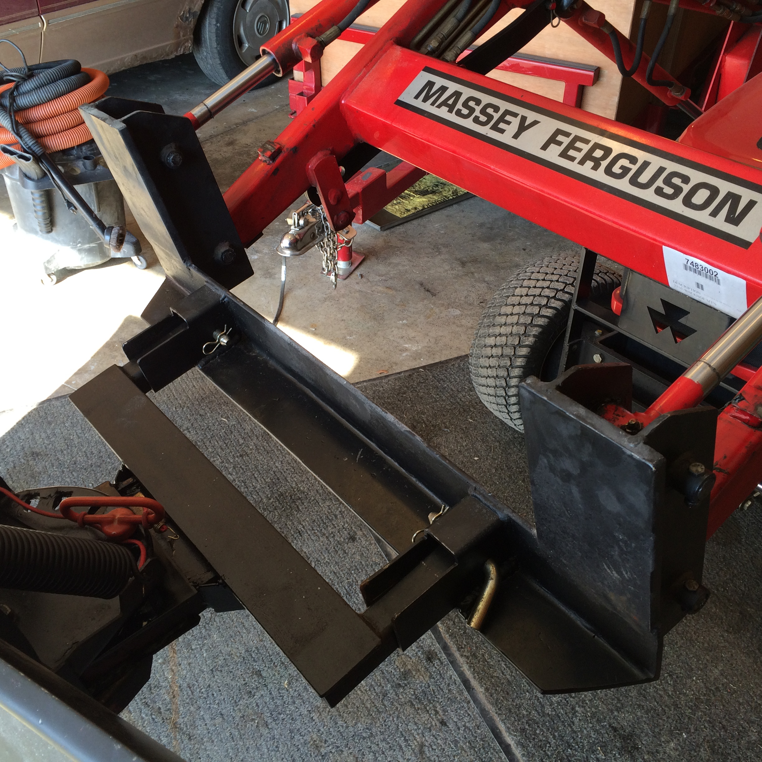

My next door neighbor gave me an old snow plow that's been sitting around for at least 15 years I've lived next to him. I want to mount it the FEL on my Bob Cat CT235, use the curl hydraulic hoses for the angle adjustment on the plow. What's the best way to modify the plow frame to mount it to the bucket?
My plow using the "underslung" mounting has been very satisfactory.
You may want to do some investigating before trying the normal loader hydraulics to control the angling. Since I used the existing third function on my tractor, I didn't bother trying to grasp the issues. Apparently some (or all?) loader hydraulics won't work for that.
