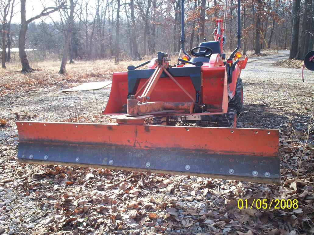

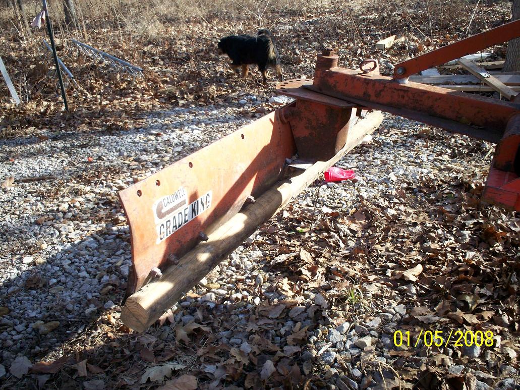

I use a landscape timber bolted to my blade to keep from tearing up my gravel. This would probably work for your trails too. Run lag bolts from the front through the bottom holes of the cutting blade. I don't need no stinking skid plates!!:D :D :D
