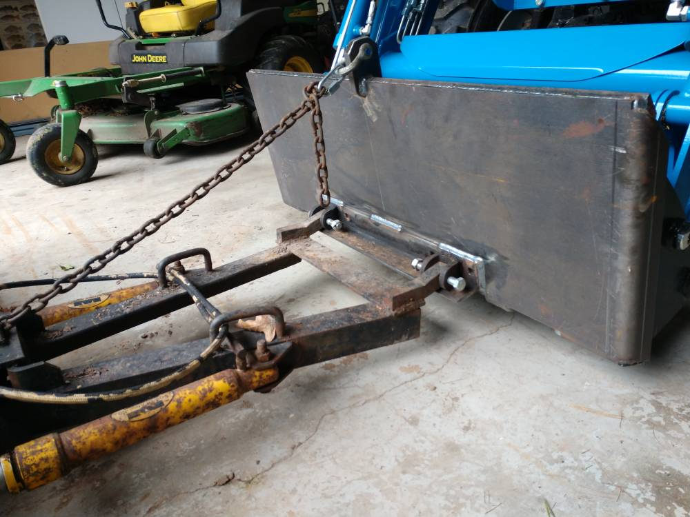

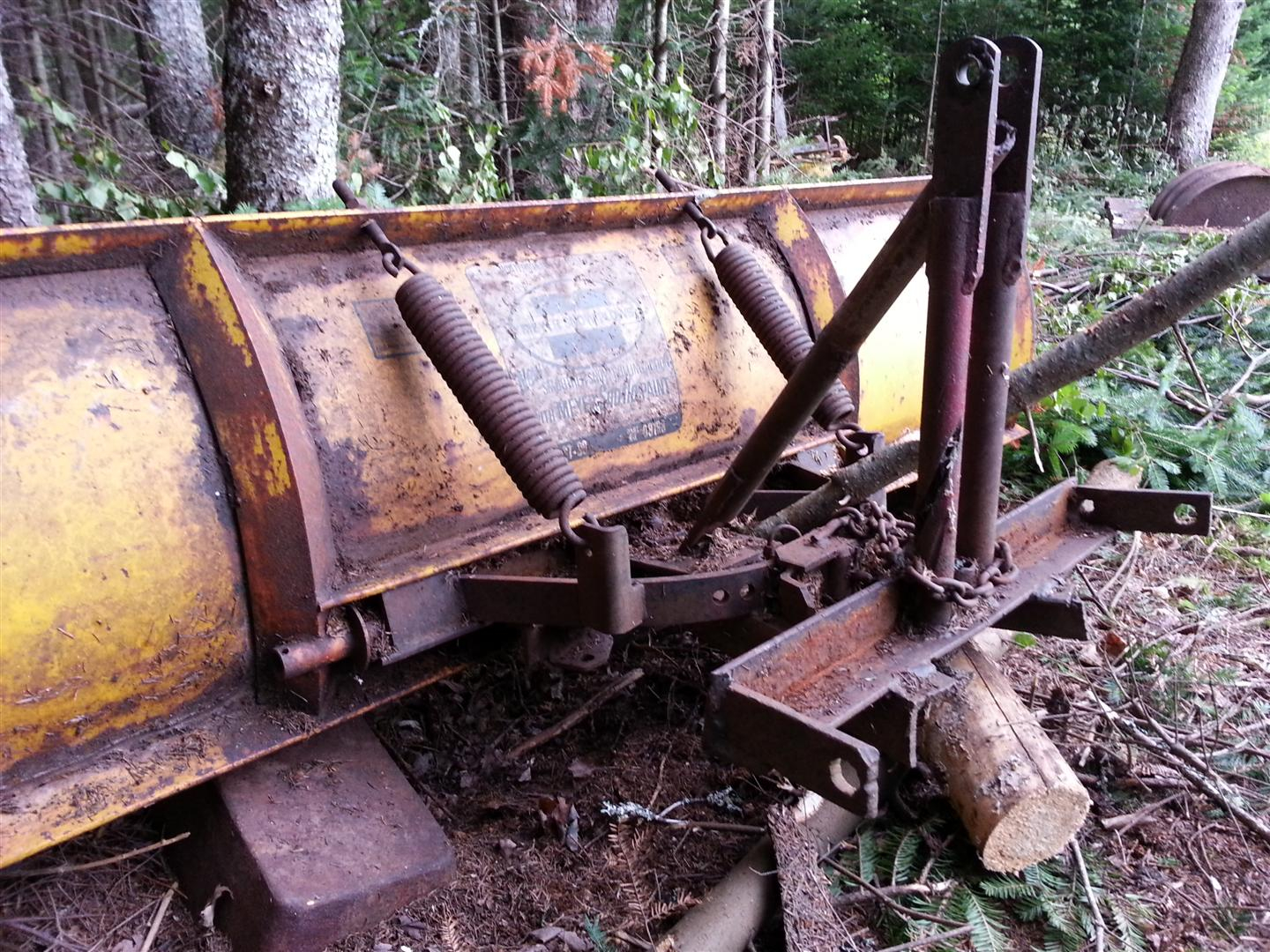

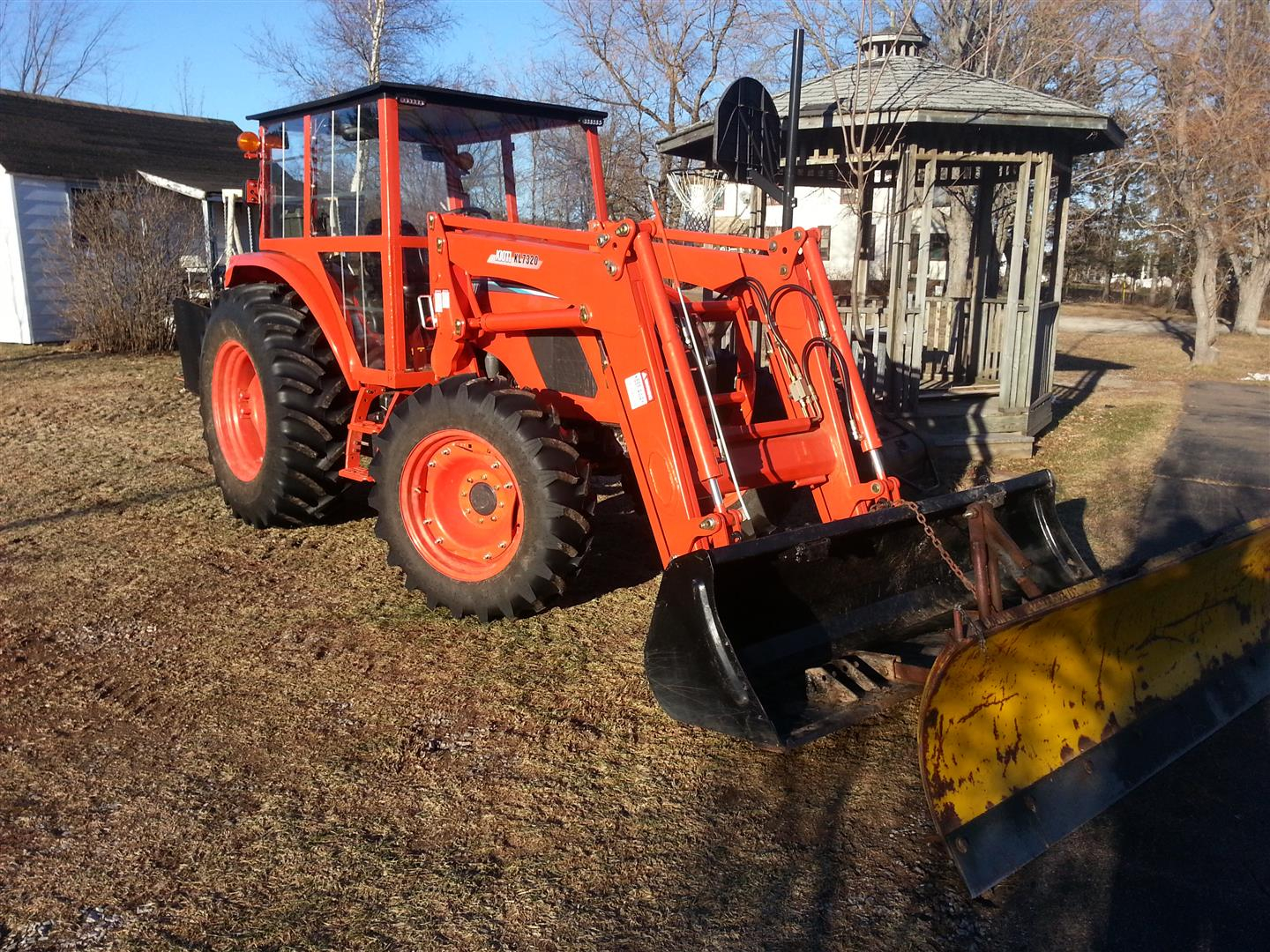

I have an old Meyer plow I converted to SSQA and use it on my tractor. Works great. The heavier the tractor the better it will plow. Mine is setup with a chain lift which allows the plow to float independently from the loader. View attachment 750681
Similar to BoylermanCT, my old half-ton plow is mounted with two receivers on the bottom of the bucket (just two pins to secure). These receivers allow the plow to move up and down considerably. Then a chain is used to allow the plow to hang with just the weight of the plow when touching the ground. This prevents the additional down pressure of the loader arms. I tried securing the plow with a solid link instead of the chain and the down pressure is way too high.

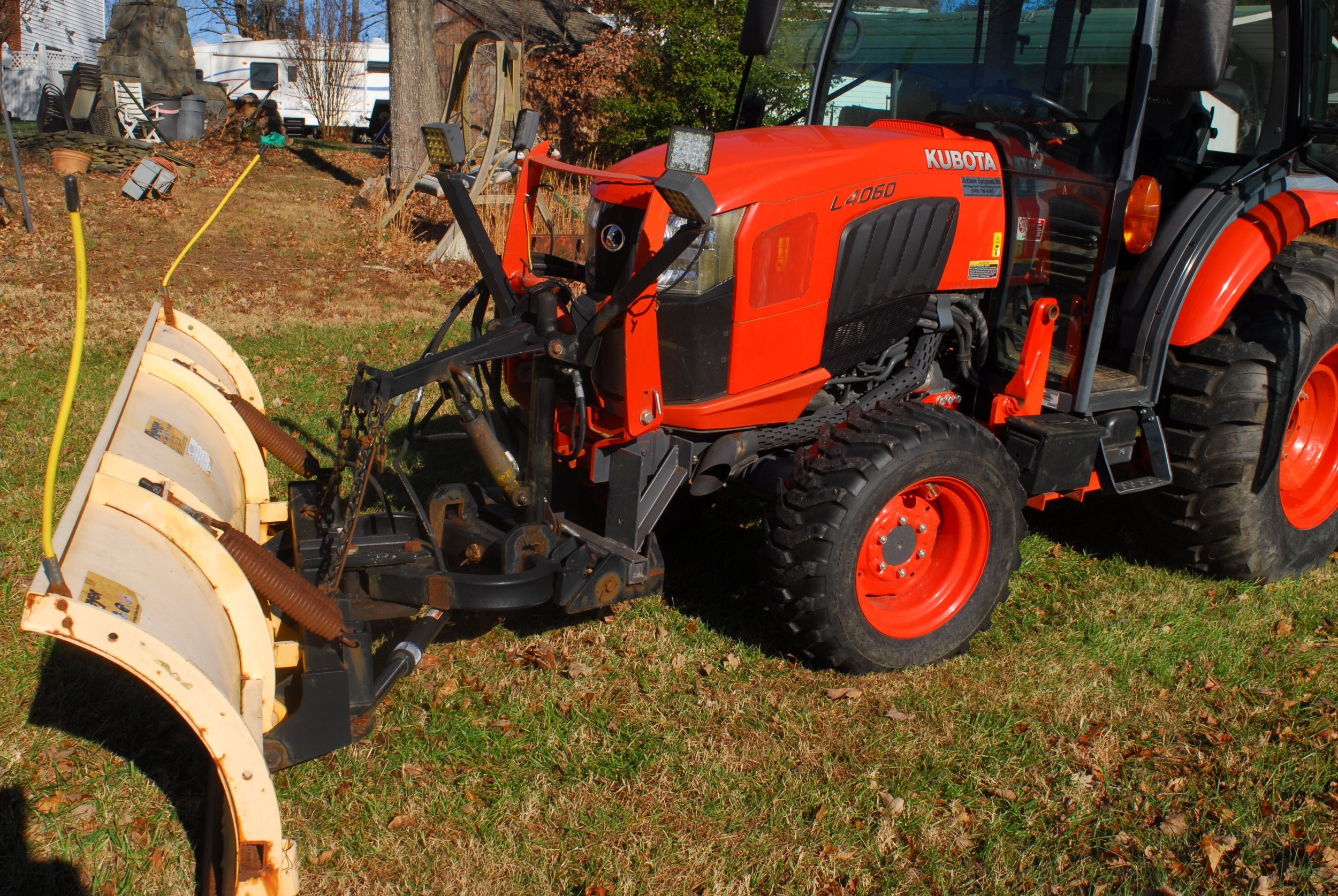

I have used a Meyer ST90 plow attached to the loader on my L3010 and like others have said it was easily pushed around by the blade because of the "lever" effect of having the blade so far forward.
After trying that for a couple of frustrating years I added a fixed mount to the tractor and used the loader valve to control the plow. When I eventually moved up to the L4060HSTC I upgraded the plow to a 9 footer.
For me there is no comparison with the direct attach plow being much easier to maneuver and better at moving snow. The only downside is having to remove the loader to attach the blade, but that is no big deal to me.

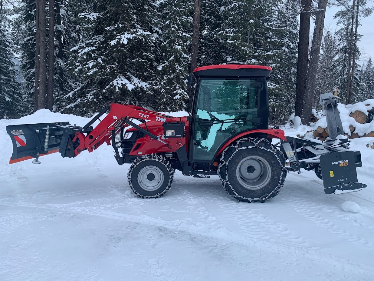

   / Snow plow on FEL #27
Yup, go for it. Mine works great:

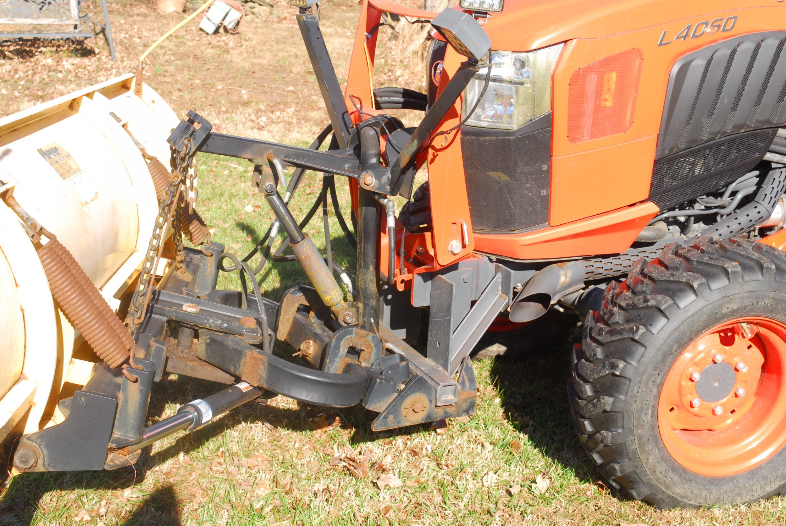

   / Snow plow on FEL #29
I run a 7' SSQA plow on my Kubota L4060. It does not float, but there is an inch or two of slop that allows me to put the blade on the pavement without floating the fel arms. The only time I float the fel is when there is a large dip in the pavement.
Last season I put an UHMW Polyethylene edge on the plow, and I really like it. Cuts very well, doesn't scrape the pavement, and it's wearing very well.

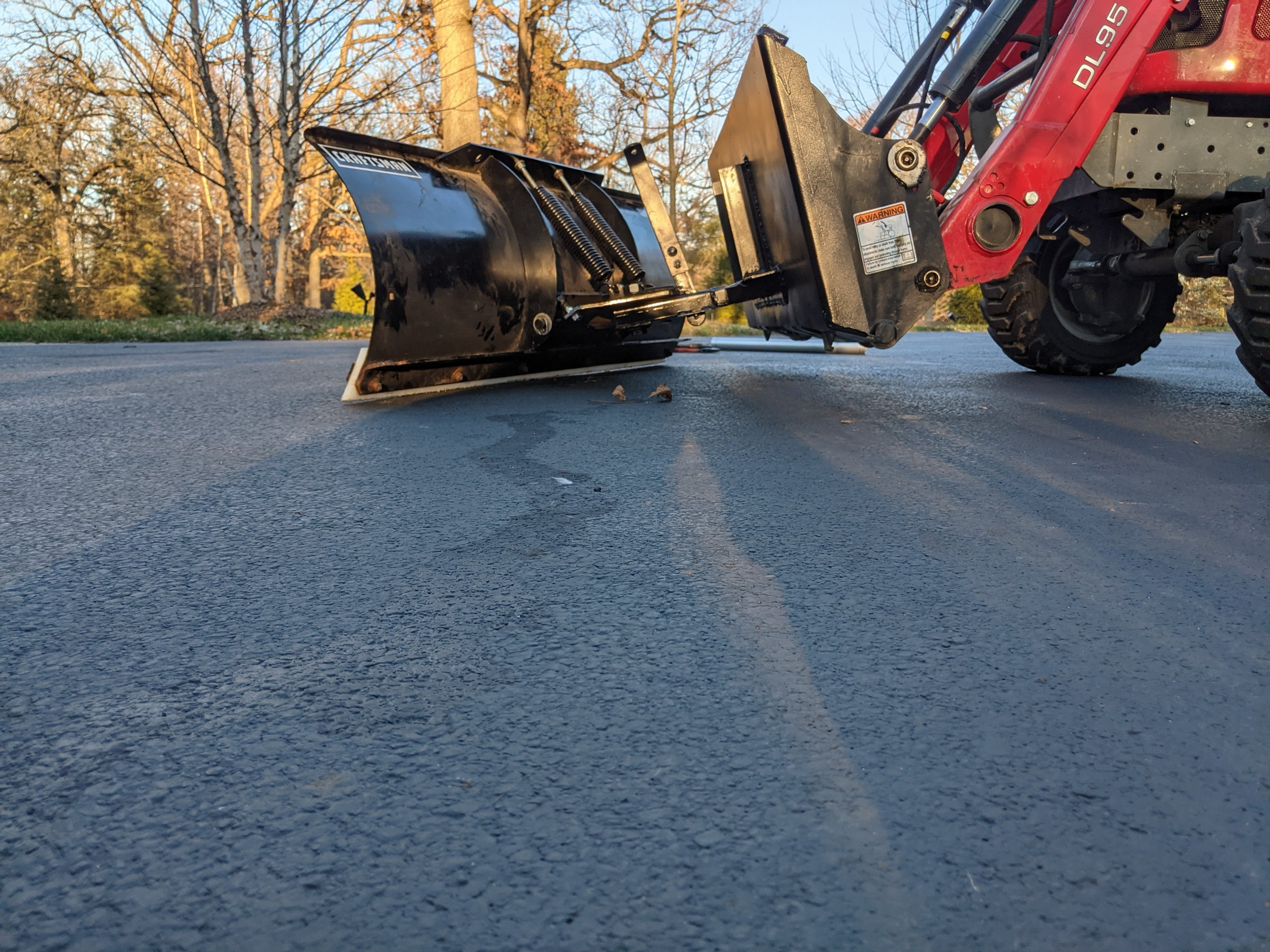

Can someone running a snow plow on their loader provide feedback on how well it works? I have an L2250 with FEL and am contemplating mounting a snow plow from my skid loader on it. The plow works great on the skid loader, but that's all I use it for. I'm thinking about selling the SL and fitting the plow to the tractor. Thoughts?

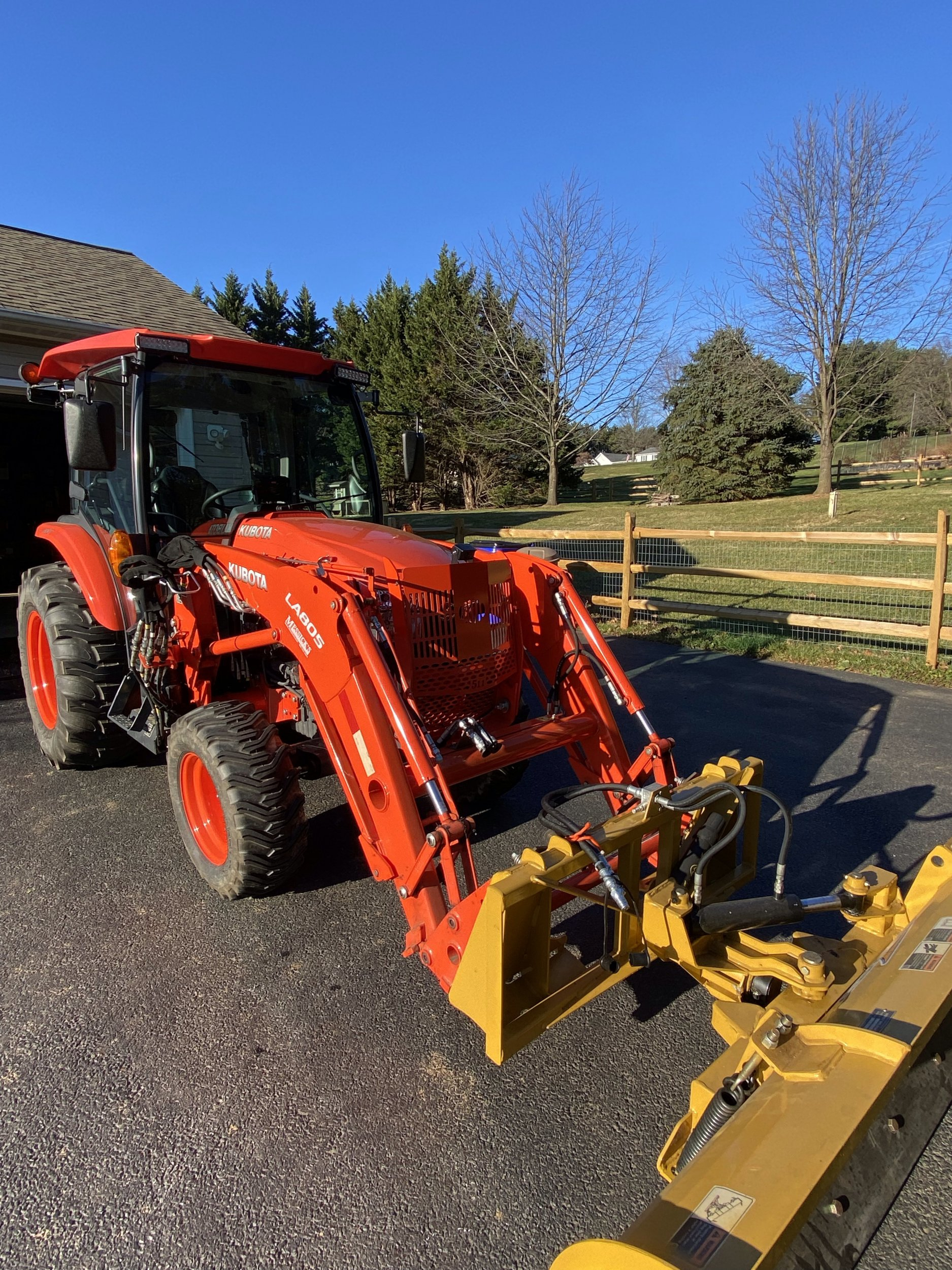

I have one for mine. Saved me a ton of time over the rear blade for snow. I have a 3rd function so I got the one with hydraulic angle so it saves time adjusting the angle. The nice part about the FEL is you can use your tilt to adjust the angle of attack for different conditions and surfaces.
