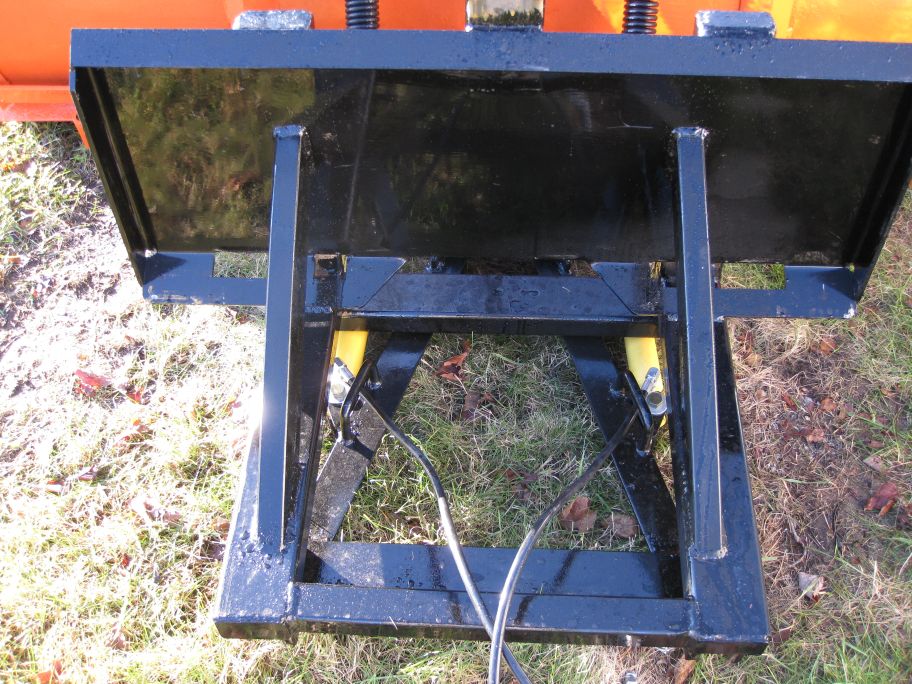

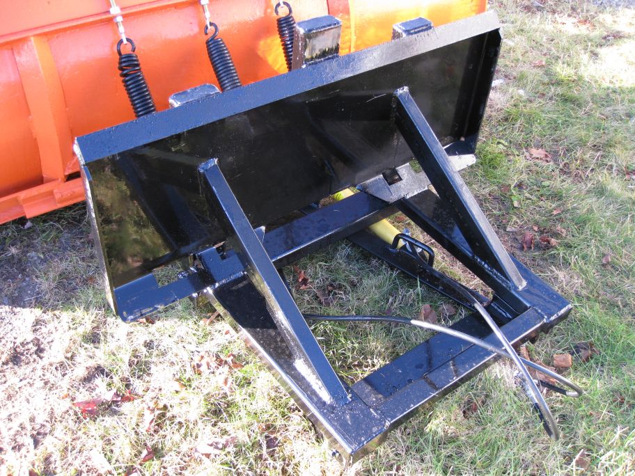

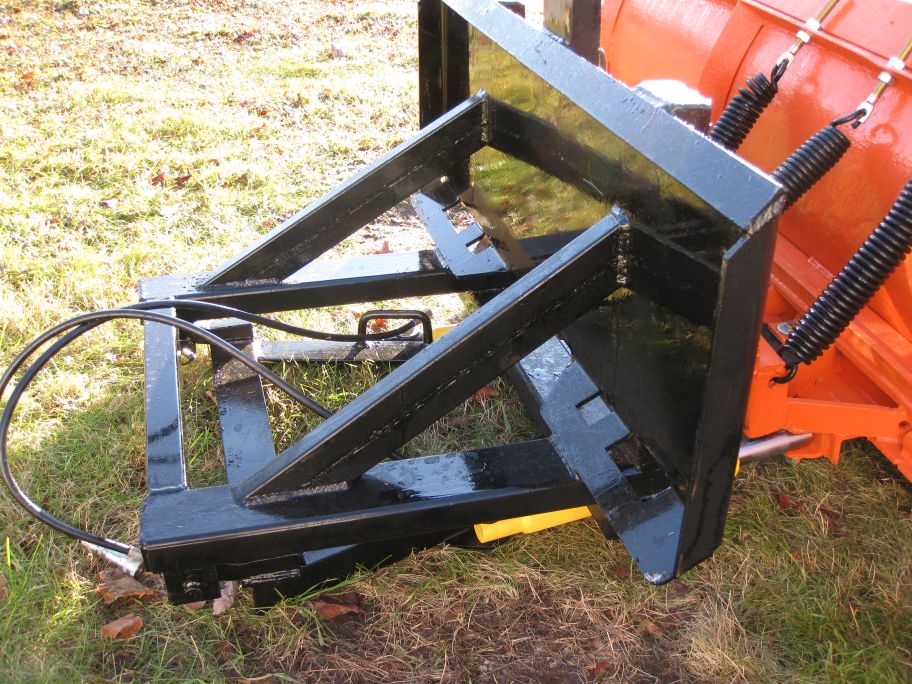

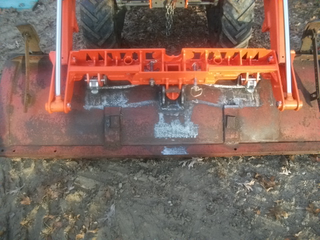

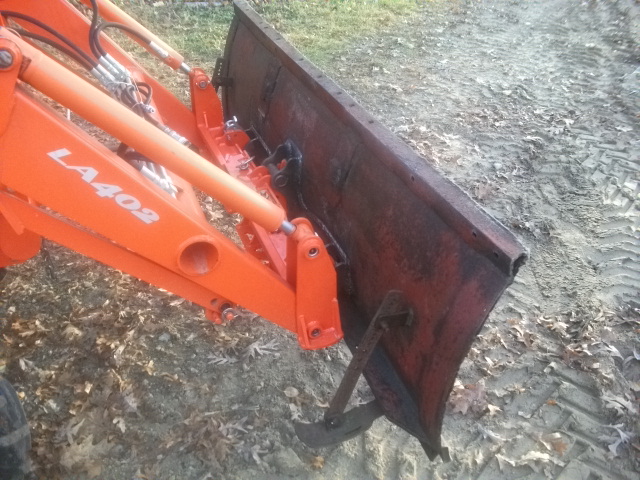

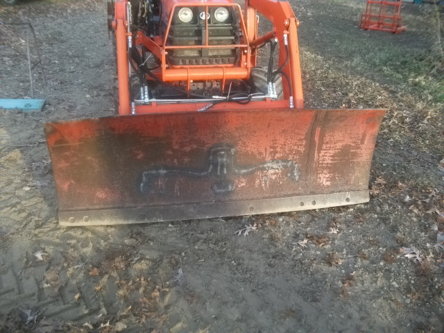

Here are the pics of my snow plow. I also turned my rear loaded tires and gained 3 inches more width. Now if i need chains i have no problem with clearence, BOY THOSE LITTLE TIRES WHERE HEAVY. It was almost too much for one person.
Do you have a picture of the back of the QA plate (i.e. blade off the tractor)? I really like your design. Not sure my welding skills are up to the task, but might be able to have someone weld it for me. More details greatly appreciated.
   / snow plow pics #14
Ditto.
Wedge

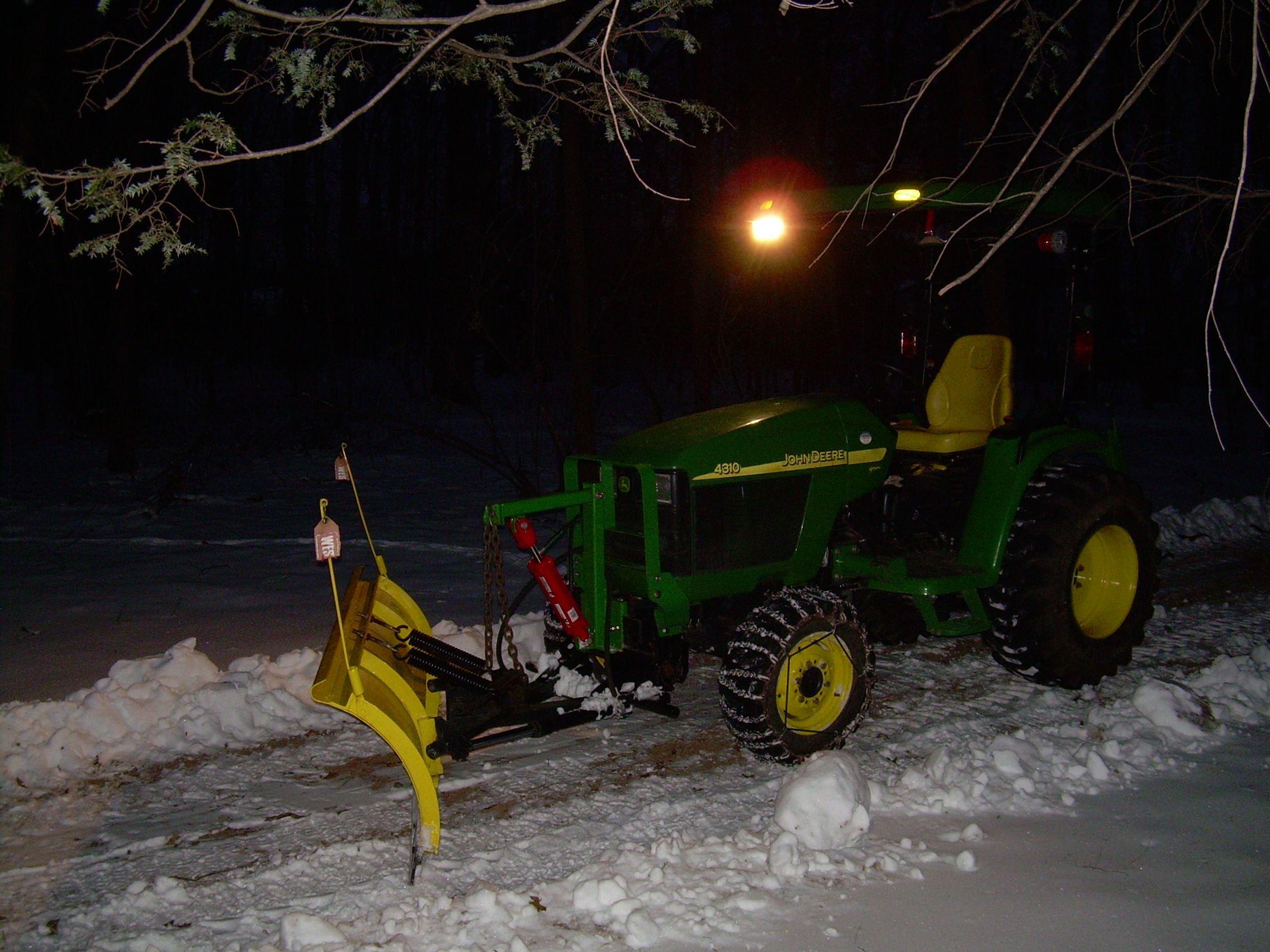

I never ceases to amaze me how many clever ways people come up with to mount snow plows to tractors. Great setup:thumbsup: It's also funny how having a nice snow removal setup makes us actually look forward to the winter weather.
I have also had the same problem with R4's. If the blade is angled, the front end gets pushed around. With the blade straight, I can push snow anywhere. I have considered putting chains on the front to stop this, but I figured this little annoyance keeps me from getting too carried away and prevents me from breaking my loader arms since the tractor is likely to get pushed to the side instead of digging in with force and breaking something.

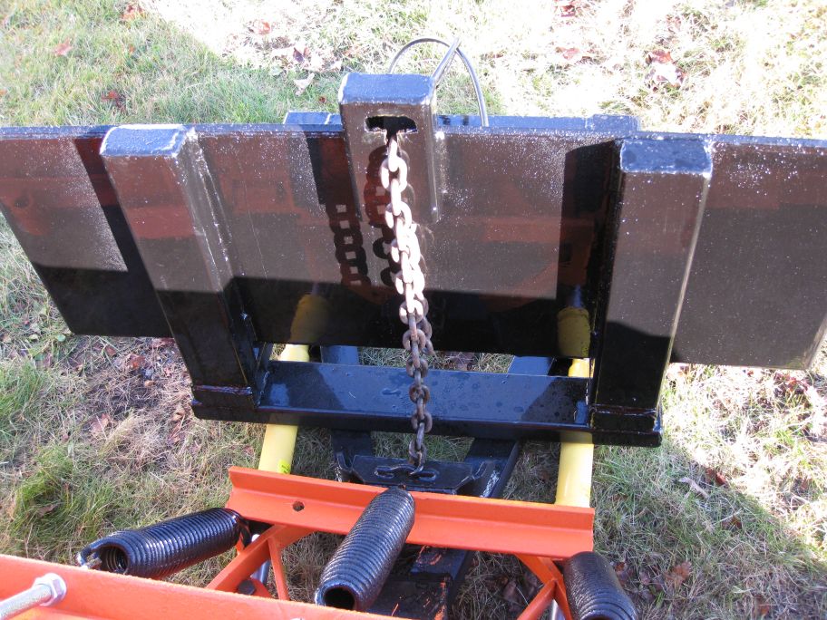

ihfarm here are some pics of the mount. I will be mounting some mushroom shoes on the back of the mount to protect the cylinders if i use the loader in full float. ray

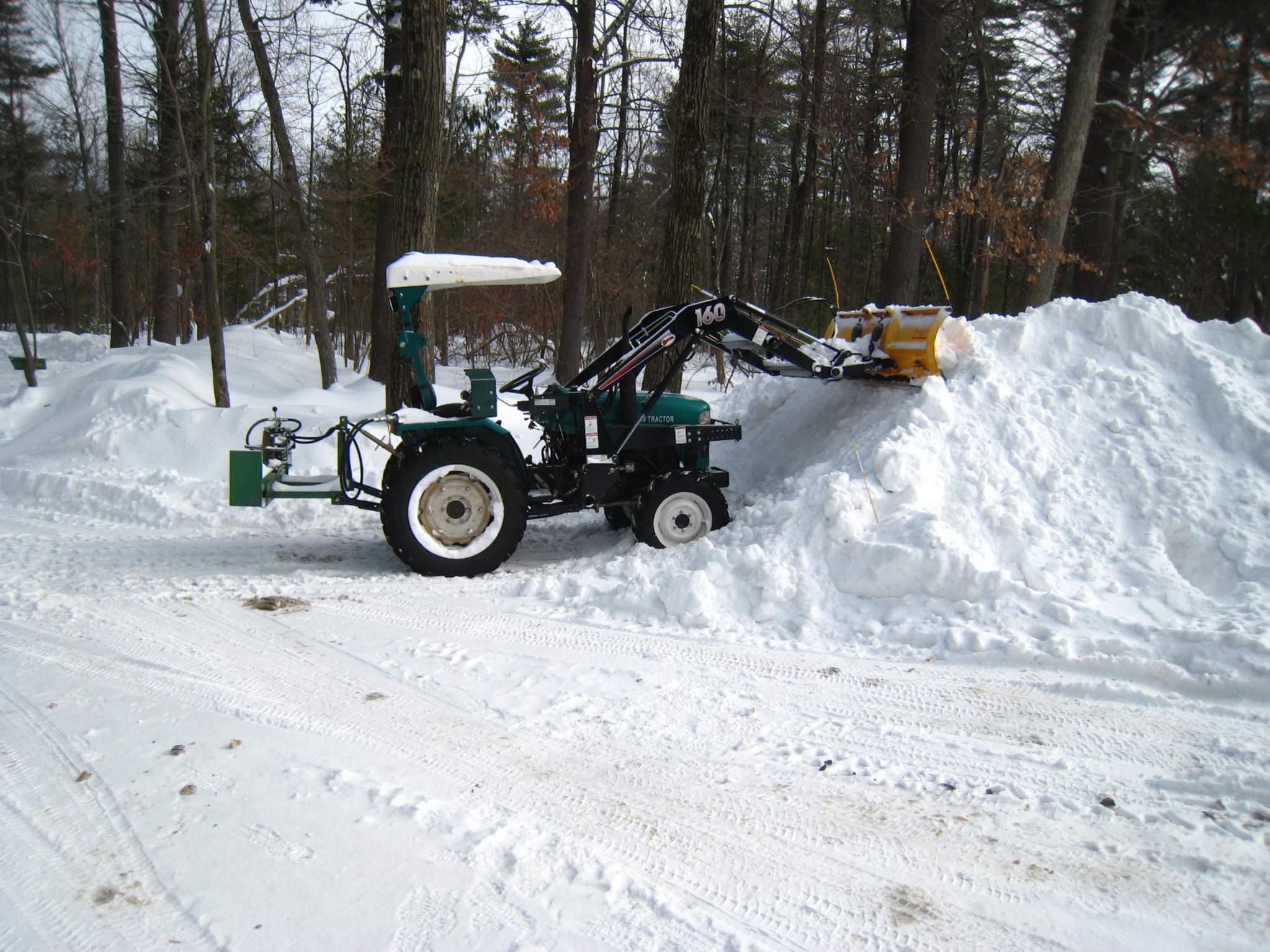

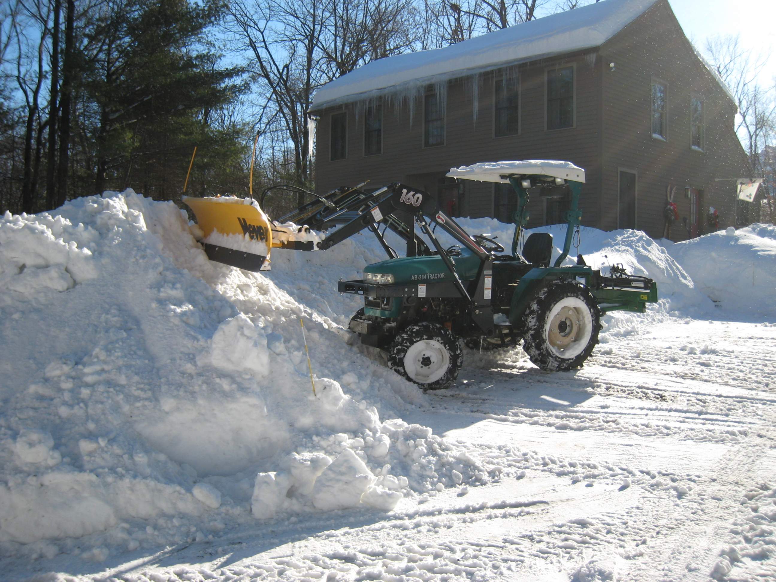

I had a factory sub-frame snow-plow set up on a L3130 Kubota.Worked very good but the FEL had to be removed.Limited on the height of the blade.
New tractor;L4240 built a FEL mounted snow-blade,like this a lot better,the plow can be removed in minutes to access the bucket.Also I can pile snow a lot higher.
