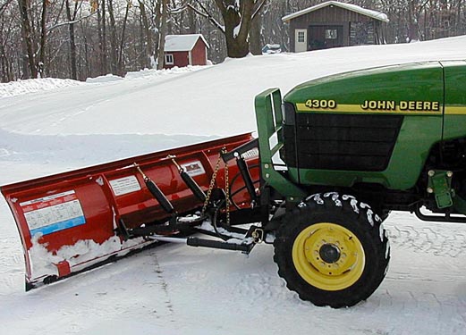

</font><font color="blue" class="small">( I know I could have a plow frame welded up and use a western or a meyers. )</font>
That is the route I took, and fashioned a 7' Western plow that works absolutely 'perfect' for me.

Beenthere,
Yours is the exact approach I was looking to do. I can get a 4 way meyers 7' reasonable. and fab the mount like you did.
Very nice job on yours..
Regards,
Chris

   / Snow Plow Question ( That time of year ) #10
Thanks.
When I did mine, I could get what they called the 'short' A-frame, which tucked the plow in a bit closer to the front end.
I have posted more pics of the fab'd quick-tach and the short A-frame connection, if you want and search on 'Western Plow'.
