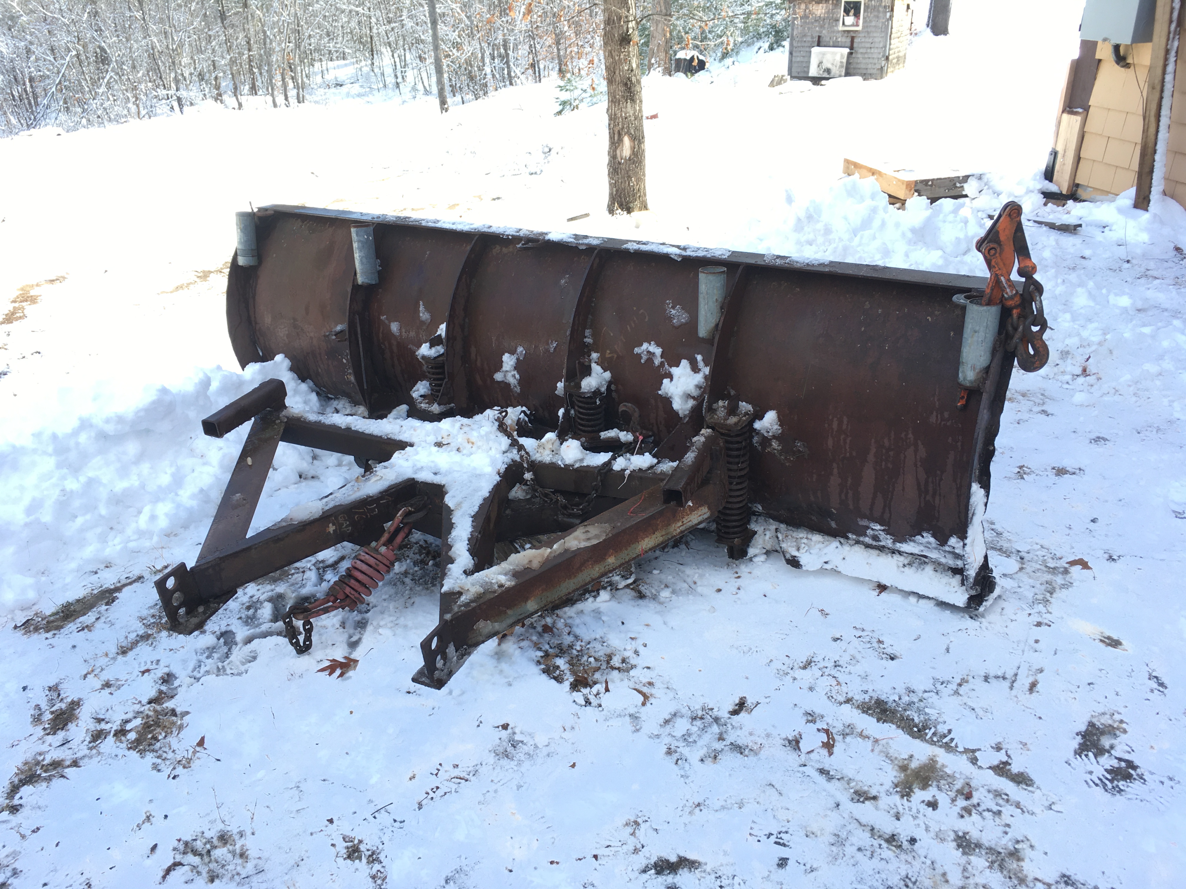

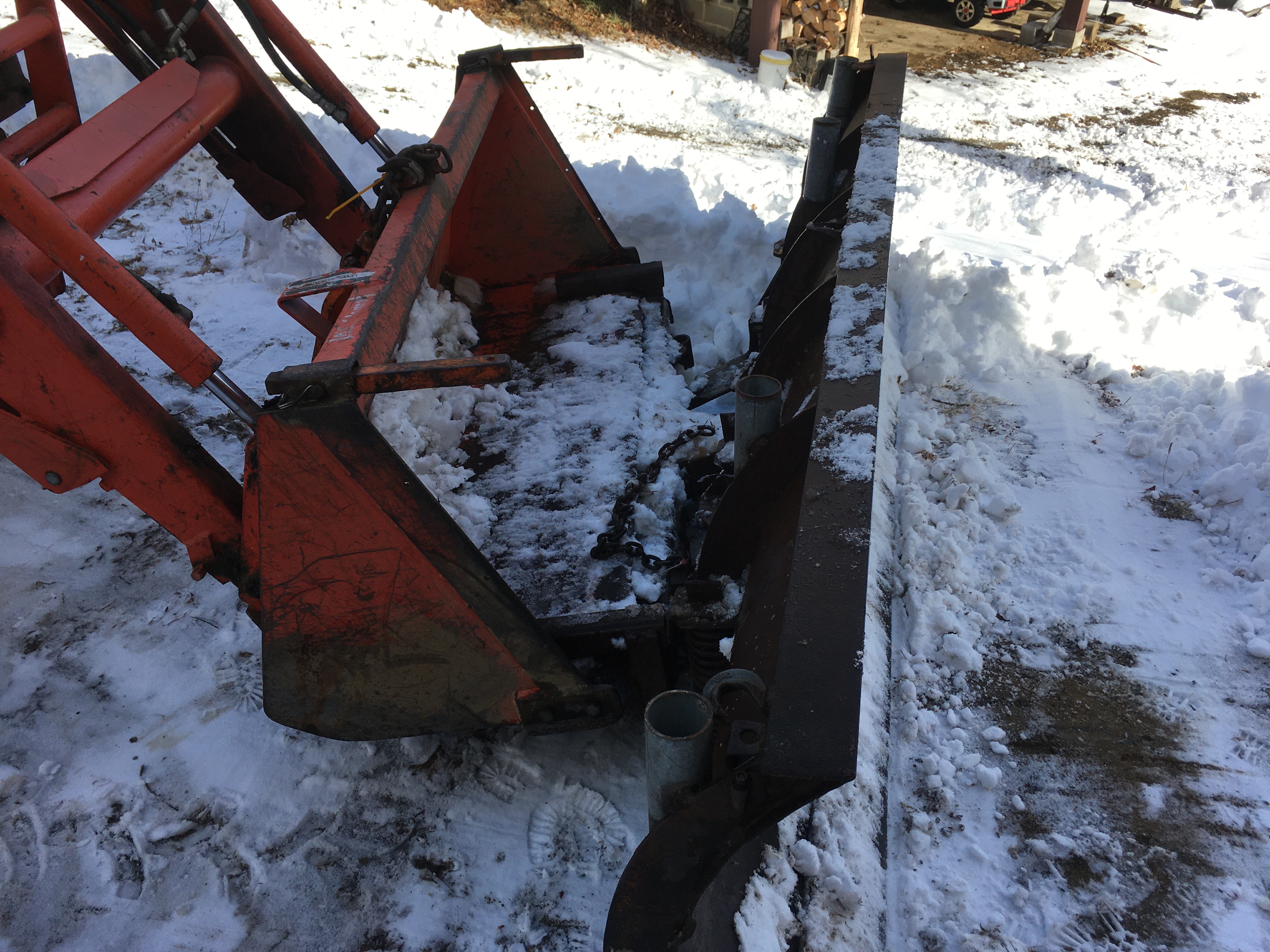

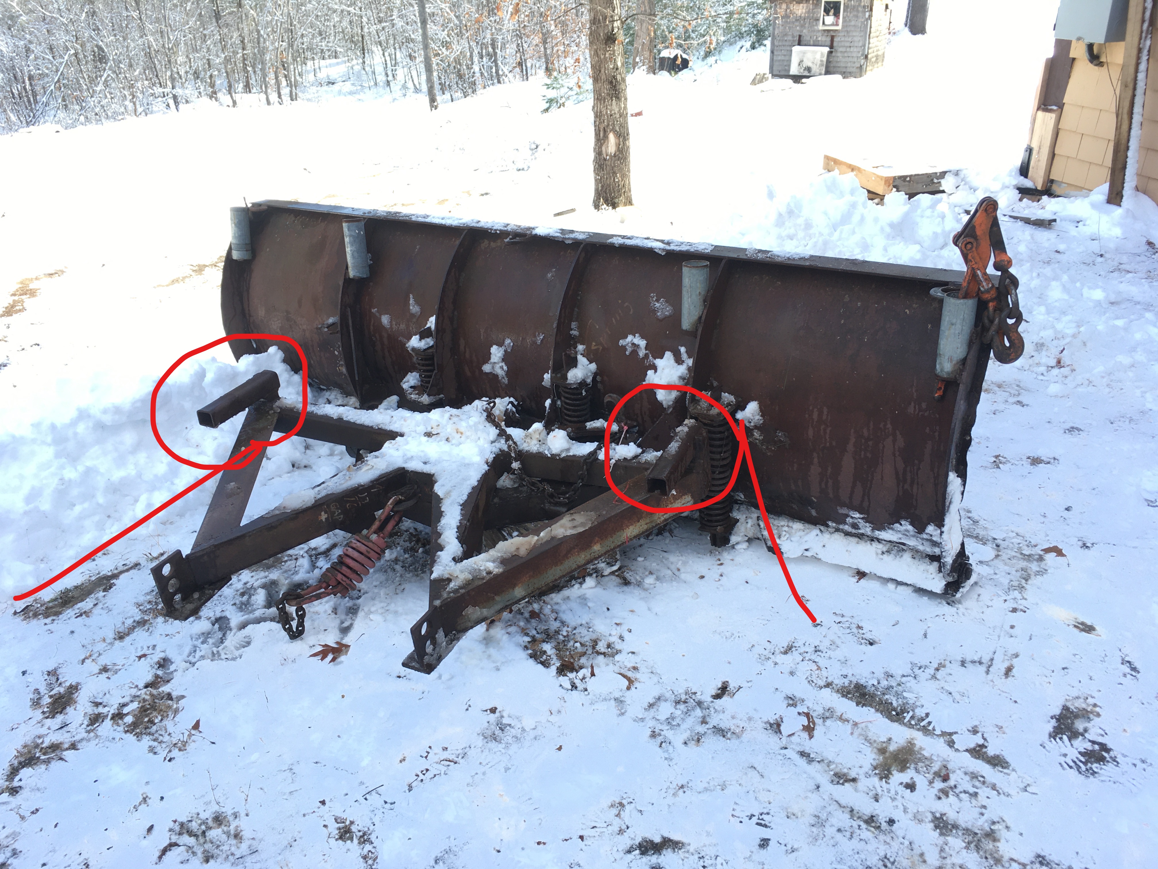

Maybe a smaller center pin will give more slop for float. My bucket hooks on two L brackets with 2" gap, I could use 4" gap to so the blade would float from side to side better. I have slight angle for both side that is held by a pin, full angle the blade sticks out to far.

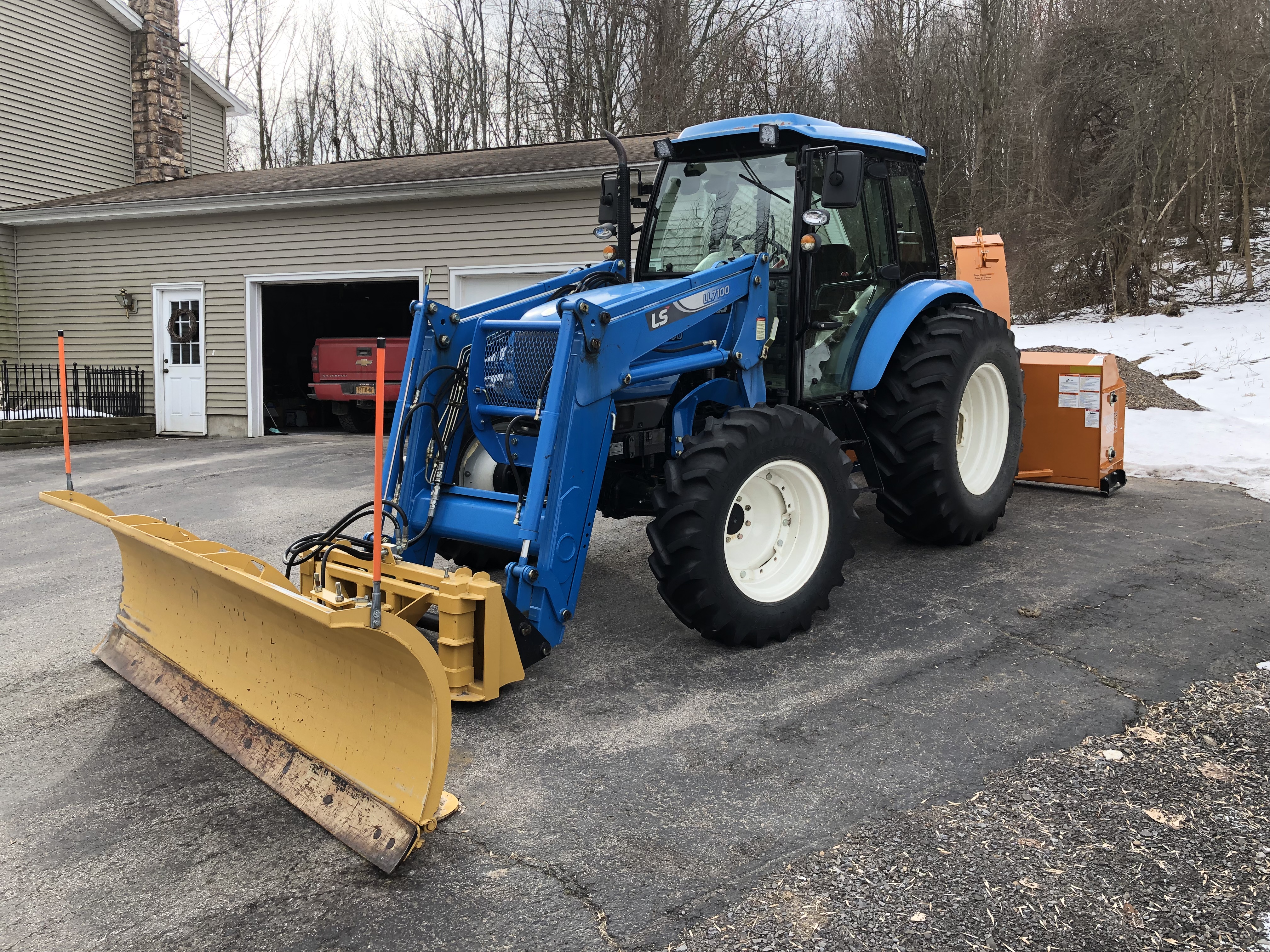

Must work good, dont see any snow on the driveway coarse a monster LS tractor might help to. Looks like they make smaller plows plows for smaller tractors...............

HLA plows have lateral float built in. I had the 2000 series on my smaller tractor now have the 3000 series on the current one.
Do you recall a ballpark figure on what the 2000 series cost you? Is the "Max Operating Weight" the bare chassis weight, or the weight of entire tractor, all in with attachments and ballast weights? If it's bare chassis weight, I could choose the 2000 series, but if it's "all in" weight, I'd have to jump up to the 3000 series.
