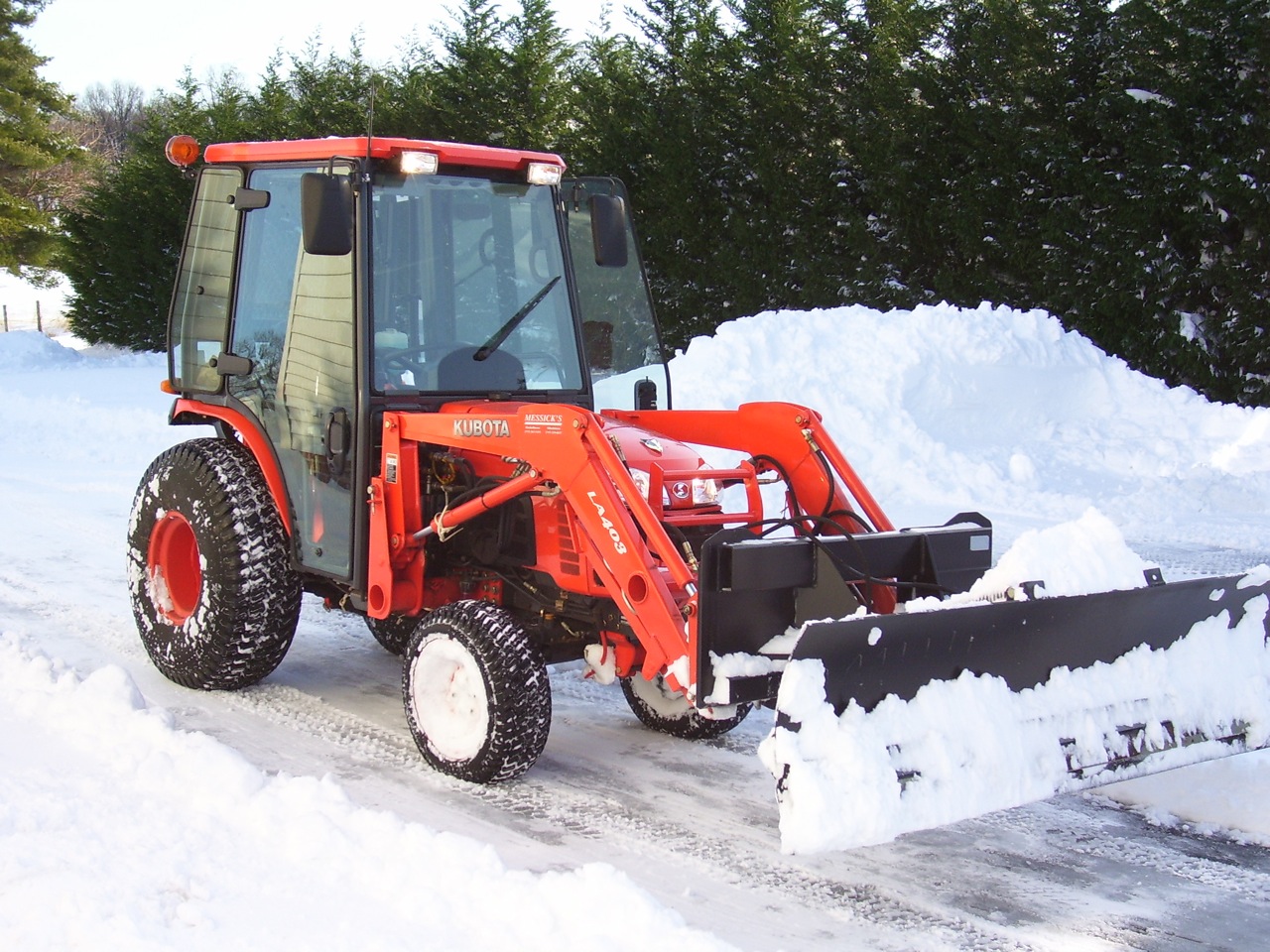

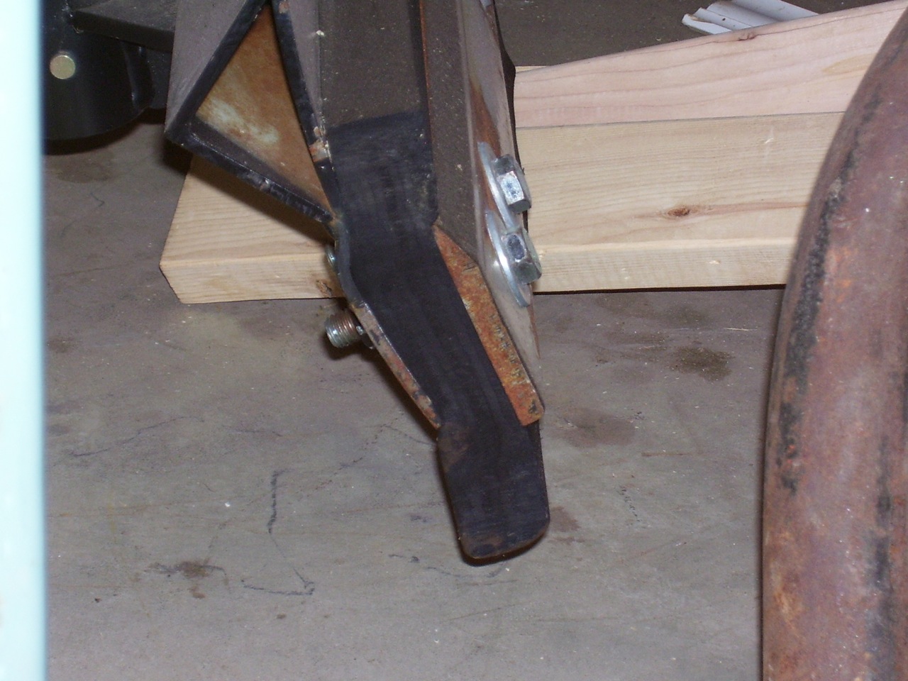

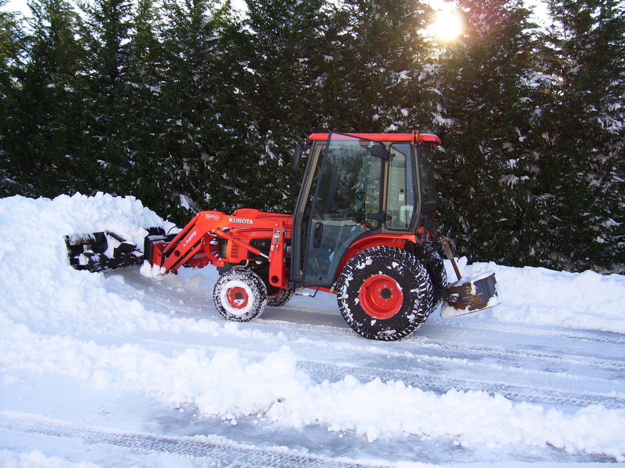

I have a hard rubber squeegee that I got used from a contact at a county roads facility they had used and were going to discard. No worry about scraping the driveway but doesn't cut real hard icy stuff as it usually just floats over it. But overall works great. Good luck. Stanley

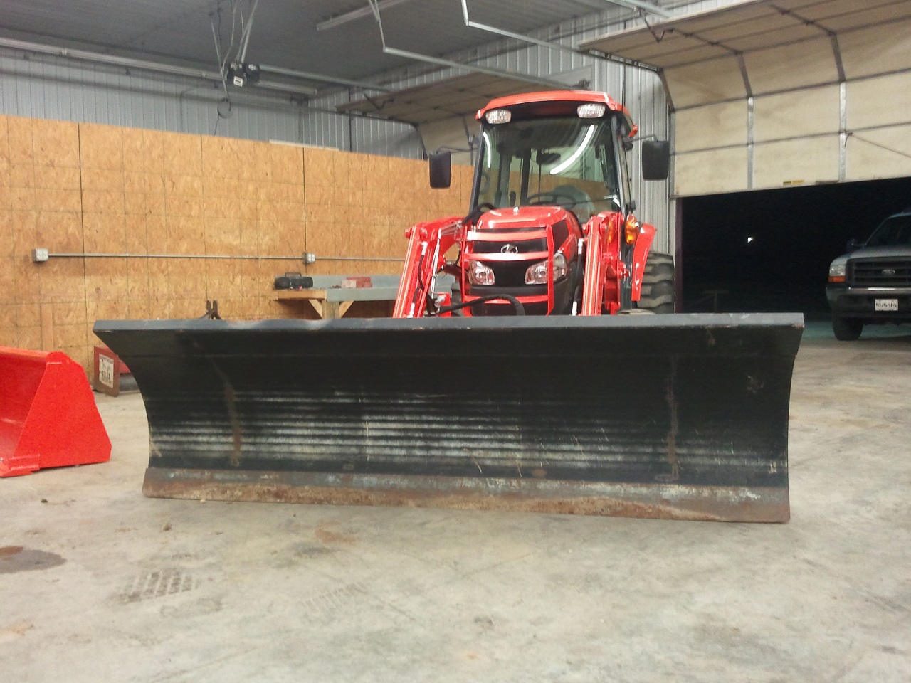

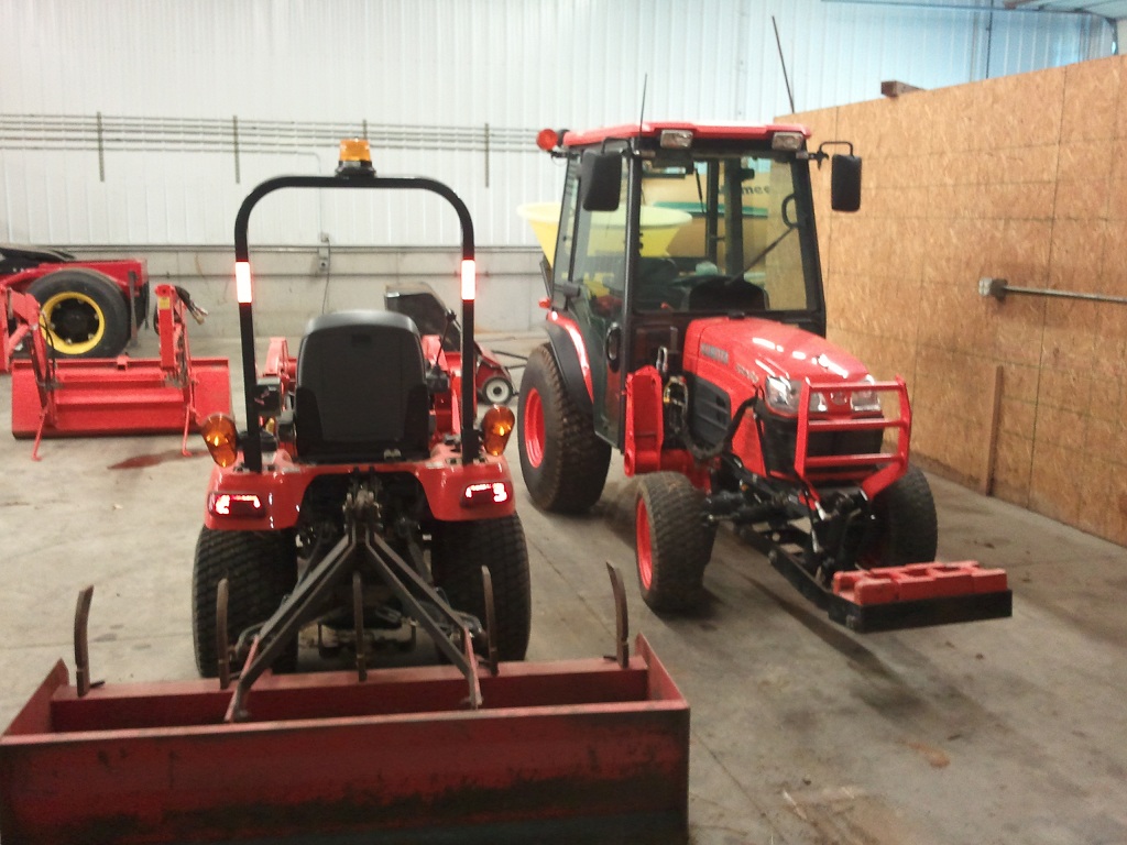

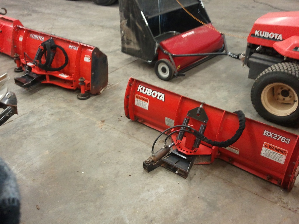

RFB hit the nail on the head! L5740 does a fine job. I use a 9' angle plow or an 8' snow pusher (depending on the lot and conditions) with my L5740 and have had no problems. I loved my B3030 for getting in tight spots. It had the 60" angle blade on the sub-frame. Even my BX2660 was quite impressive with it's 60" angle blade on the sub-frame. One time it pushed through a drift as tall as it's hood. :thumbsup:
As far as cabs are concerned, the B3030 cab was warm, but not tight at all, very noisy compared to my L5740. The B3000 is supposed to be a little tighter cab and I hear there is a new 2013 B3050,(I think is going to be the designation)or B50 series anyway. It is supposed to have a whole new cab design that is as good as the L.

P.S. Judging by the picture of your L5740, it looks like you are using a 9 foot plow? How does that handle?
