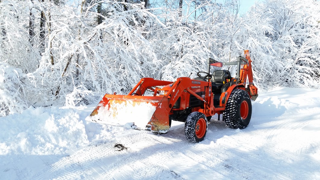

My L2800HST has 7 1/2' plow attach to bucket and rear scraper blade back tires loaded no tire chains,only got stuck once in 7 years I wasn't paying attention. :eek:

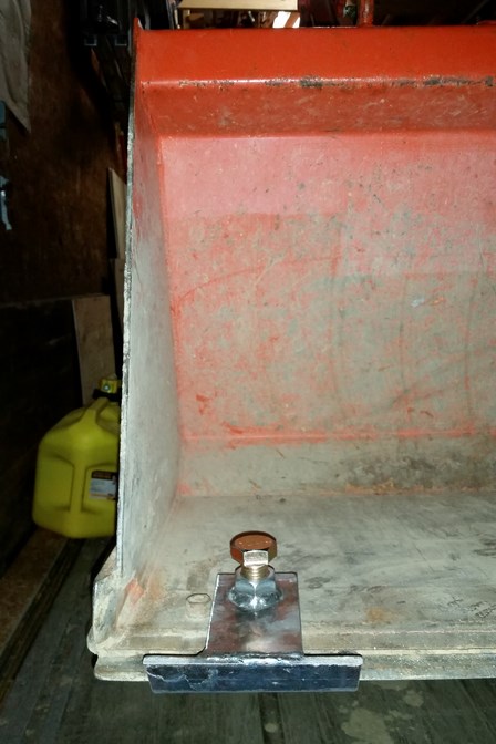

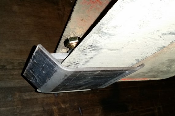

I use my 24 HP New Holland. I live in the land of lake effect in Indiana. Last winter was not too bad, but we had a couple times where we had 2 foot drifts. Not a problem. I have a gravel drive and did not do anything with the cutting edge. This thread just reminded me I need to order Edge Tamers. Tractor Loader Bucket Attachment | The Edge Tamer
They will help me from depositing a lot of gravel into the yard. Also I can start by pushing back far into the yard so I have room to accumulate snow during the winter.
