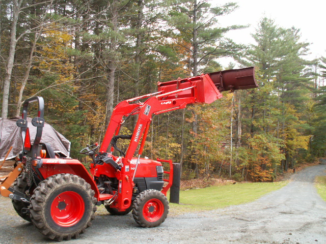

/ snow plows #8
"With a Fel mounted I can bank up to nine ft."
Yep some mighty tall snow piles,less chance getting belly hung.

/ snow plows #13
Thomas I think you may have me by a foot in piling height. I can pile around 8 feet or so, but I take my bucket off and mount to loader arms with my A frame and blade.
