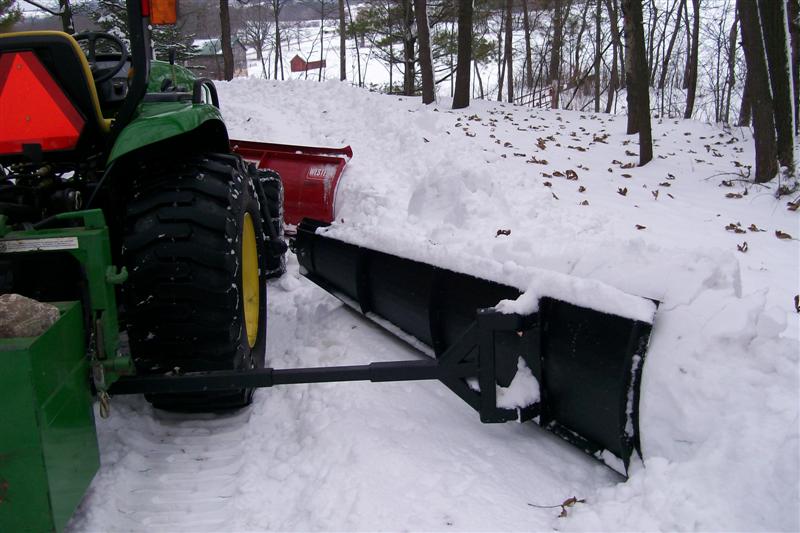

Or build a wing plow to go with the front blade :D
