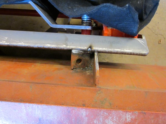

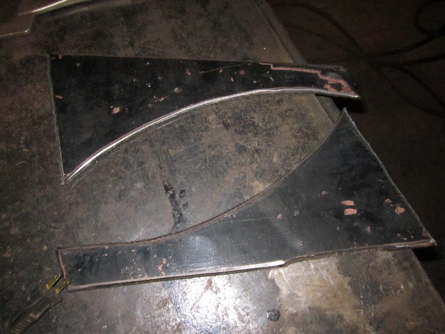

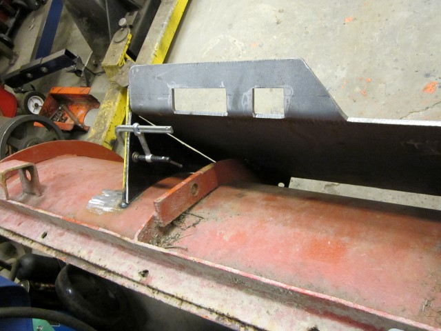

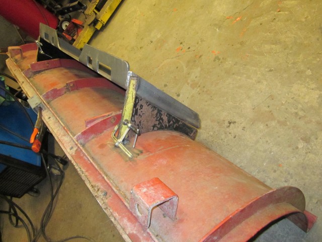

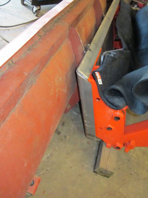

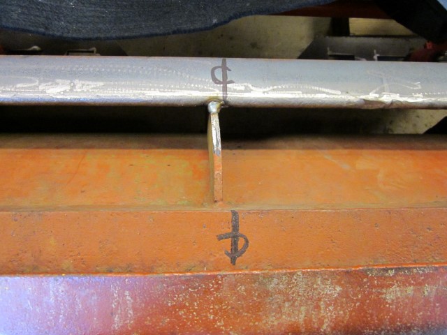

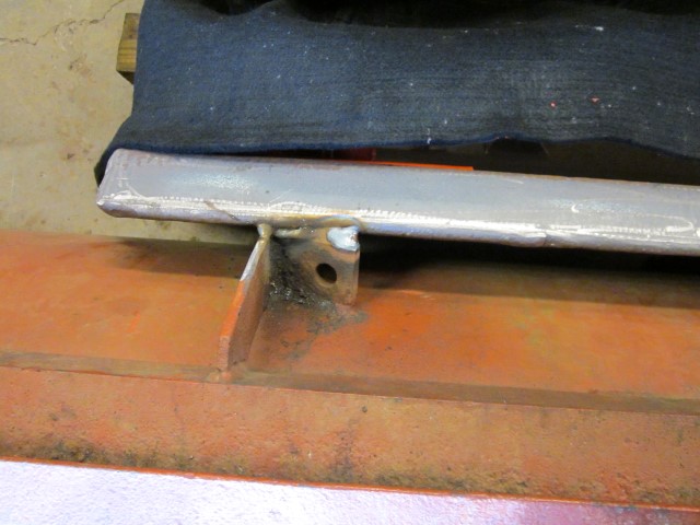

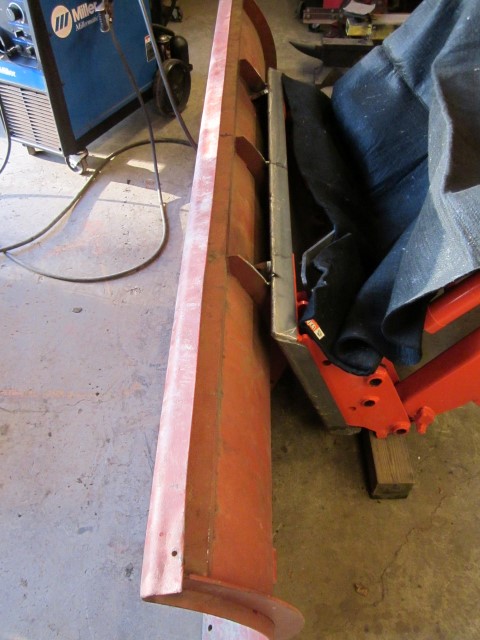

I started welding the SSQA plate to the plow blade today. I used some old 1/4 plate and the plasma to cut out 4 pieces to tie them together.
I took your advice and kept the FEL up about 4 inches and leveled it with the ground.

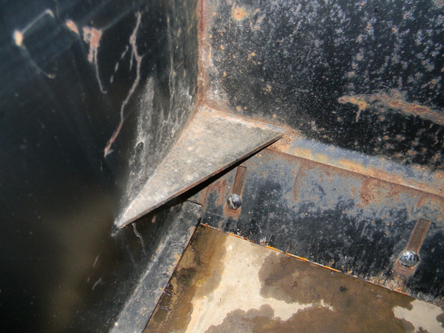

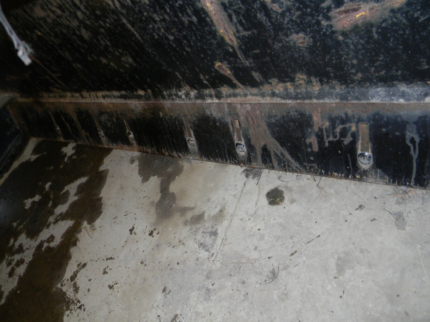

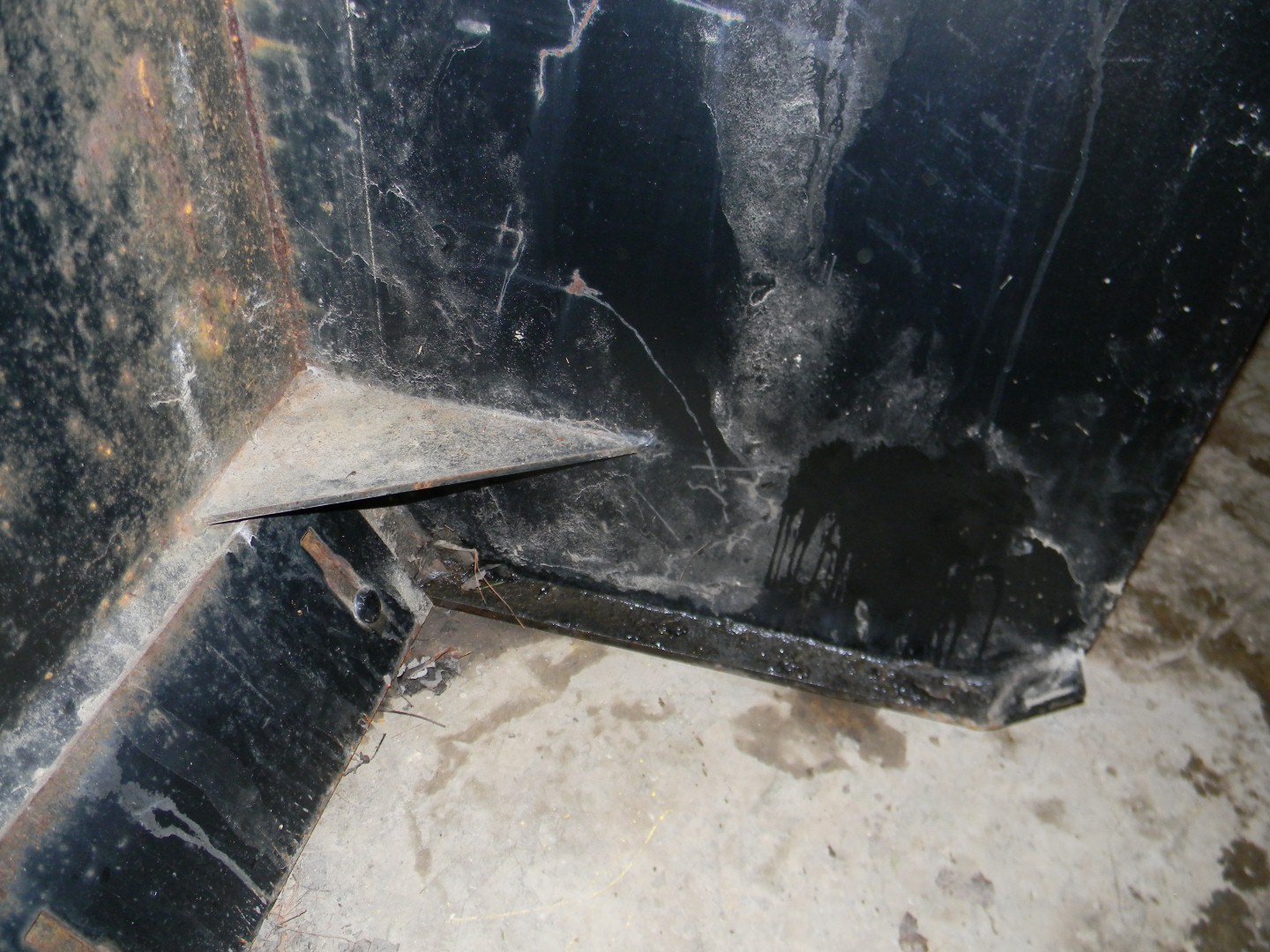

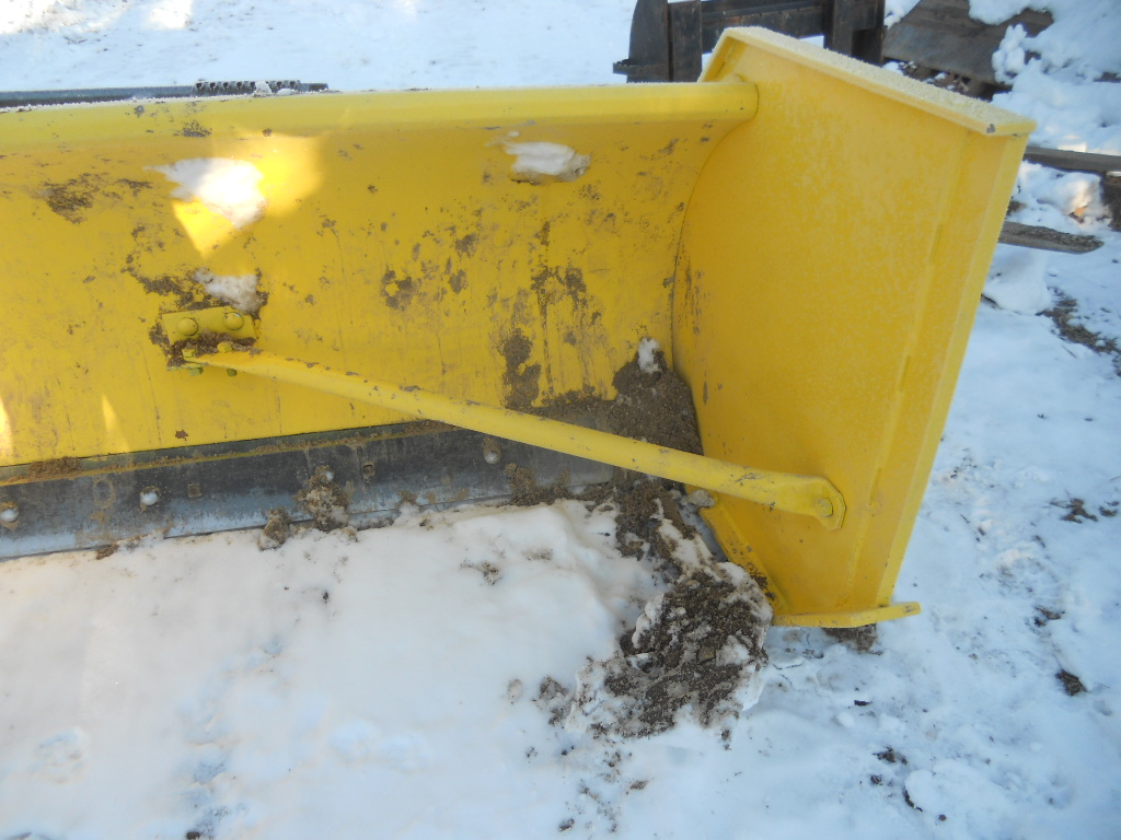

I think 3/8" and 1/2" are way overkill for the sides. I have a ready made snow push blade and the sides are only 3/16" that are braced inside and across the top. I also added an adjustable height back drag bar across the top of mine using an old plow cutting edge. 3/8" or 1/2" would be good for the bottom skid shoes.

Should be just fine. I used 1/4" and without inspecting "store bought" units, I thought that it was probably overkill. I did reinforce the top with a flat 2x3/8 bar and the front with some old 5/8" cutting edge. A well built skid shoe on the bottom takes care of that stiffening. (also made out of old c/e)

I think so. As you can see mine is 3/16" but is braced well. Top plate is a brace, Triangle gussets above the cutting edge, and the skid plates on the bottom. I'm sure the back drag bar I added braces the top front too.
