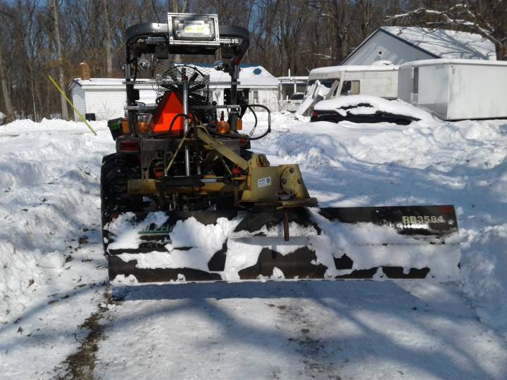

Almost anything is better than trying to move snow with a bucket. For early season before the snow really starts to pile up here, I'm also a fan of backblades. I could even get plow shoe attachments for mine. Works every bit as good as the 7 foot hydraulic plow I have on my jeep. Actually better, the tractor is heavier. Just have to be a little strategic to minimize hopping on and off to rotate the blade as needed.
But I don't have very many places to push snow on my driveway so I might be able to use the backblade a couple times each season before it's time to get out the blower.
Never used an actual pusher, but I think I'd prefer an angled blade.
