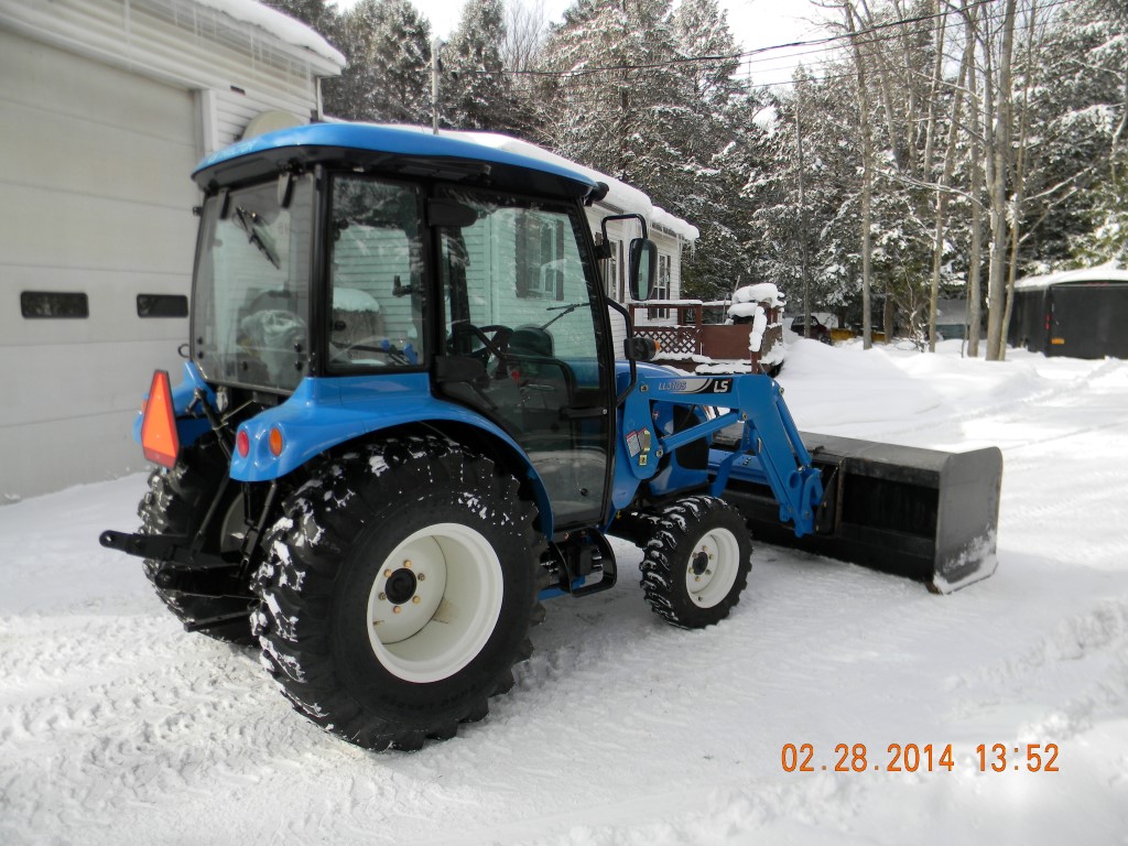

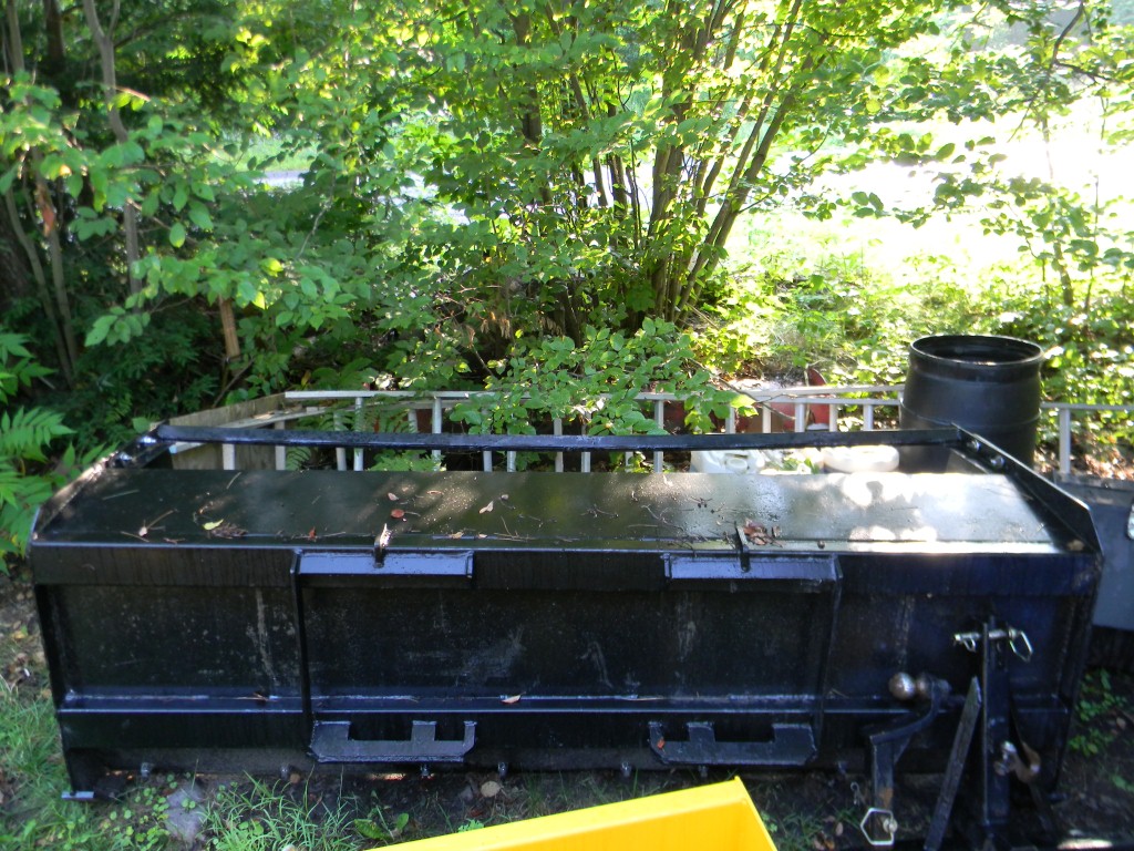

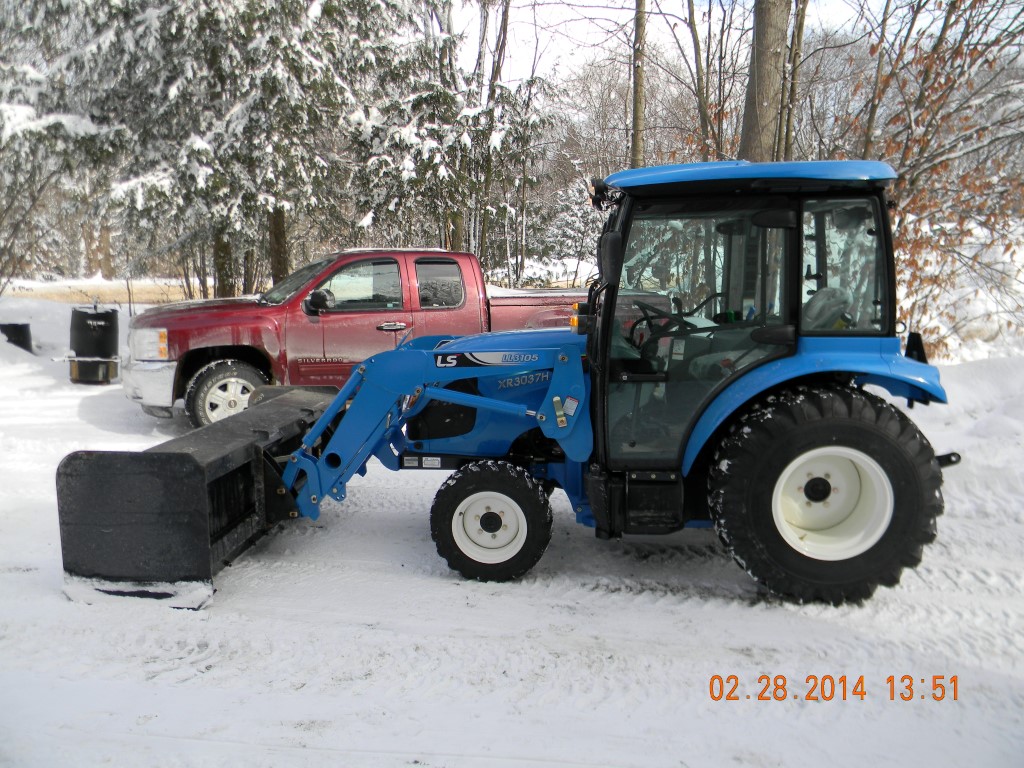

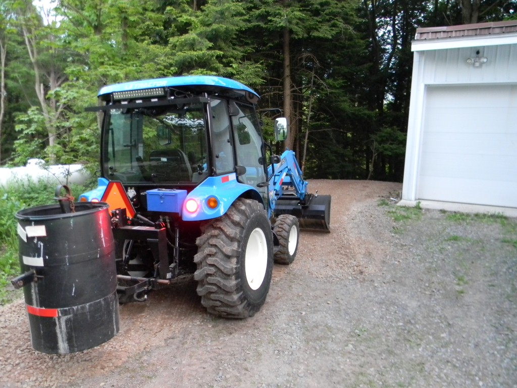

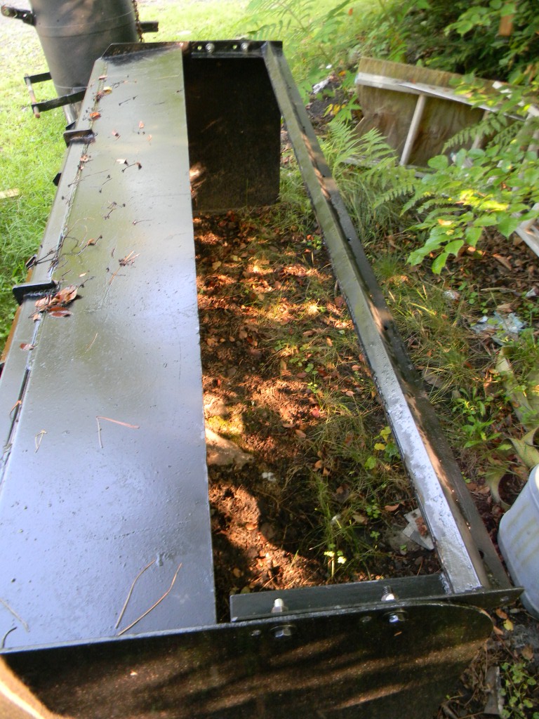

I have an 8' (actual size is 7' 6") snow pusher. I live in the snow belt of Upstate NY just S.E. of Lake Ontario. In the beginning of the snow season I just use the tractor and pusher. As snow fall increases I add chains on all four and an 850 lb. rear ballast. You will need traction to push or plow snow. I also added an adjustable height back drag blade to my pusher made from an old truck plow blade cutting edge so I can pull up to the garage, rotate it 90 degrees and back drag the snow. My pusher has a double sided adjustable height steel blade. I have it set 1/4" higher than the sides so it doesn't dig in to the gravel driveway. Pusher blade weighs about 700 lb.
$1000 for a pusher IS a great price. My pusher cost $1500 and a larger one is about 2K.

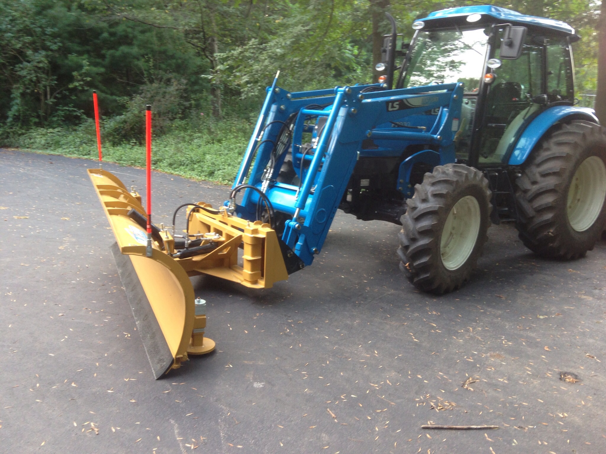

There is a distinct difference between a front blade and a plow. A plow will roll the snow off the side and a blade uses the angle to direct the snow. You want a plow. A properly designed plow is a joy to use, the snow is actually going up and out as it exits the blade, you can make a windrow higher than the plow.
A blade that doesn't roll the snow requires a higher speed to move the same amount of snow and will push the front end around, especially once you have established windrows. (Plenty of people on here have that problem) When looking at plows make sure there is a smooth transition from the leading edge to the top of the blade.
The blade you have pictured looks like the replaceable edge has raised bolt heads that would be problematic. Additionally it looks like it's raised, not flush and just bolted on the leading edge. It looks like an OK blade for a paved drive for someone who gets very little snow, but not good for what you described you want to do.
I added a photo to show the difference. Notice how smooth the curve is and how flush the replaceable edge is.
