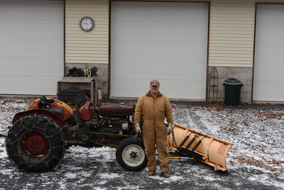

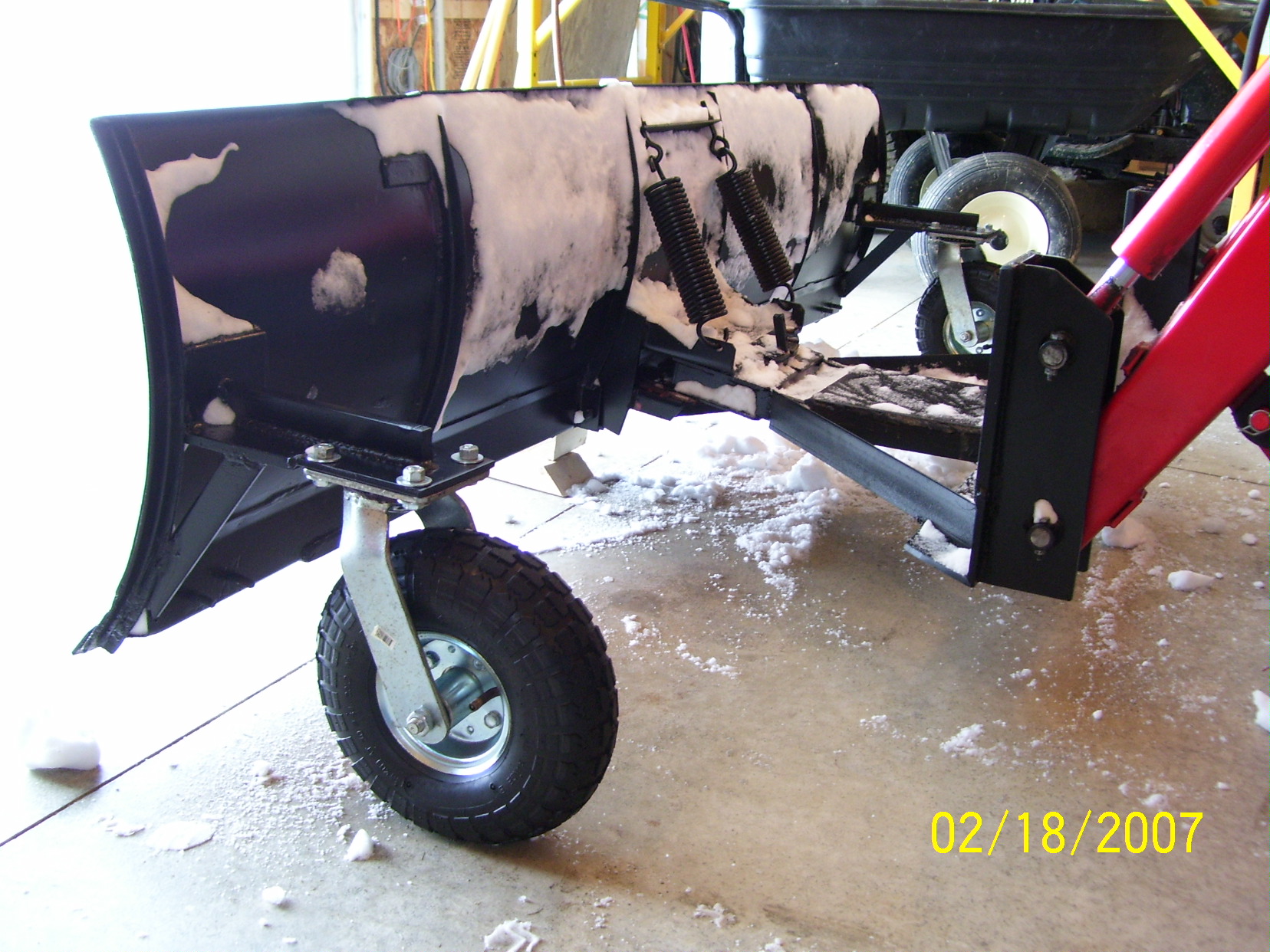

I plow 325' of gravel drive with this setup, and by packing down a layer of snow. I only move about a 5 gallon pail of gravel each season.
The casters allow the plow to be set above the gravel, until a base is compacted. Once a base is there, I can put the blade all the way down.
It also has a steel pipe in font of the cutting edge.
You DO NOT need to slit the steel pipe. It's a lot of unnecessary work. Just weld 2 tabs on it, and bolt it to the front of the plow.

OP, 3 questions
1) when you use a snow pusher, do you put it in float, and is the adjustable rubber piece int he back even with the metal?
2) When you use pipe, are you using schedule 40 or 80?
3) You are talking about a snow pusher right? not a snow blade or rear blade or box blade correct? I see people talking about a lot of other equipment ideas that might not work with a snow pusher.

I run a heavy truck plow with shoes on it. Sometimes the road is so soft that the shoes don't provide enough float so I get two grooves from the shoes plus the blade digging in. In those cases I take off the shoes and raise the plow a hair to take the weight off the cutting edge and plow the road that way. It makes a messy plow job because the angled blade is not parallel to the road surface every where and in the dips and rises I leave piles. But then I just back drag the whole thing to neaten it up. It does leave a little snow on the road but that is fine by me.
gg
Agree. I also back drag to leave a nice finish.
However for early season results I have welded oversized 'shoes' onto my blower so as not to blow gravel and on my angled plow blade I added one oversized to the dragging corner blade.
Works!
I made that oversized shoe like 10" with an upturned front. (like a small sled) as I found that the factory mushroom skids simply dug in much too much.

With my 8.5 v-plow on my truck, I have had good luck running the truck up and down the road or driveway to pack the snow down and give the shoes a compacted base to ride on.

All the way down, then 2 taps up seems to be the key for me. But I'm gonna put a pipe on the edge too. Or move south.
