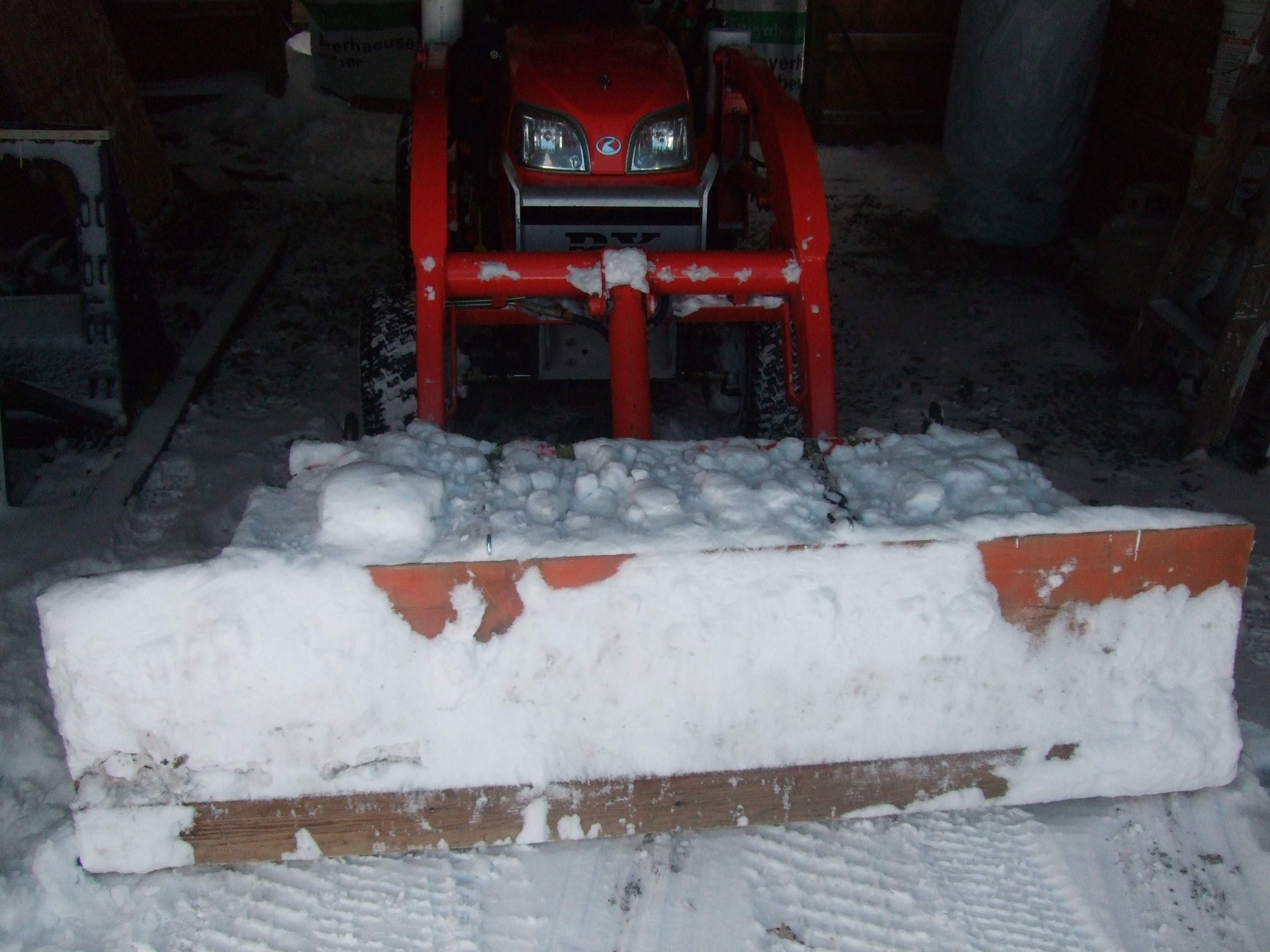

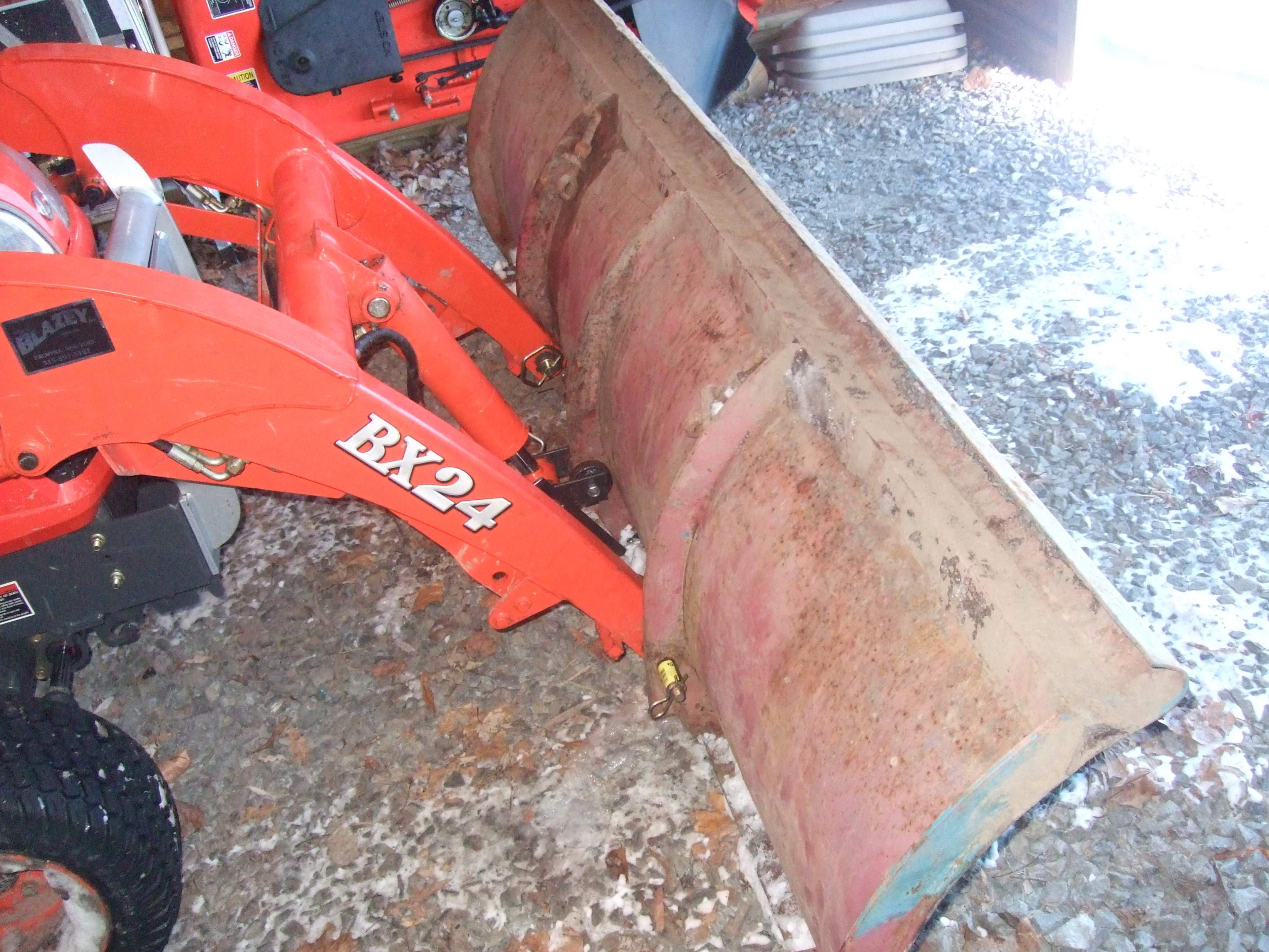

I built a wooden snow pusher for mine. It works and as a bonus it protected te asphalt driveway and grass, but wears out quickly. For a small tractor like mine, pushing wet snow can only get you so far, like 60-80 ft before spinning out then i need to back up and push it aside and then I can continue on. For a larger tractor, I suspect it would work better due to more weight. I prefer a truck plow since it has a curve surface and snow rolls more allowing better control and further push. heres a pics of wooden plow and truck plow on mine.

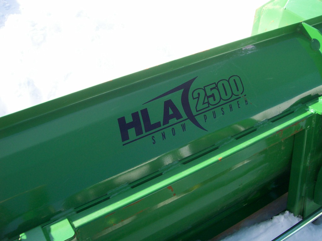

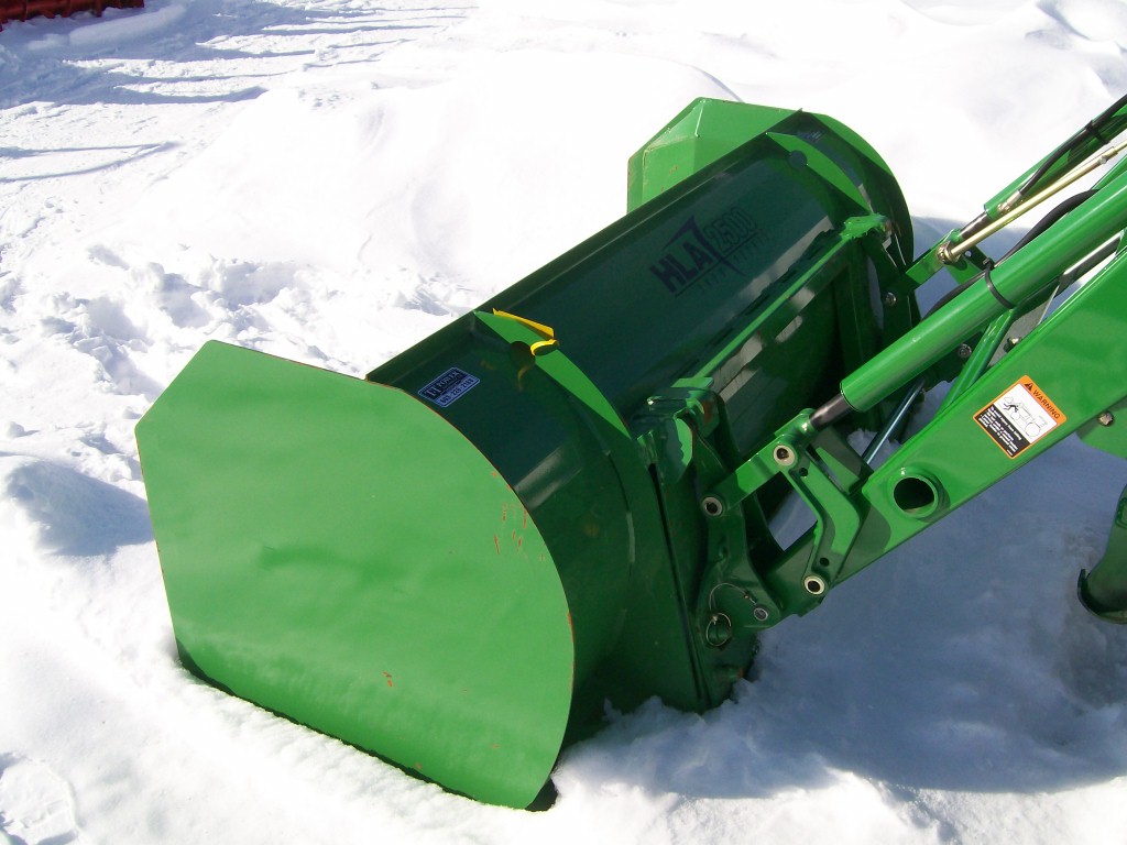

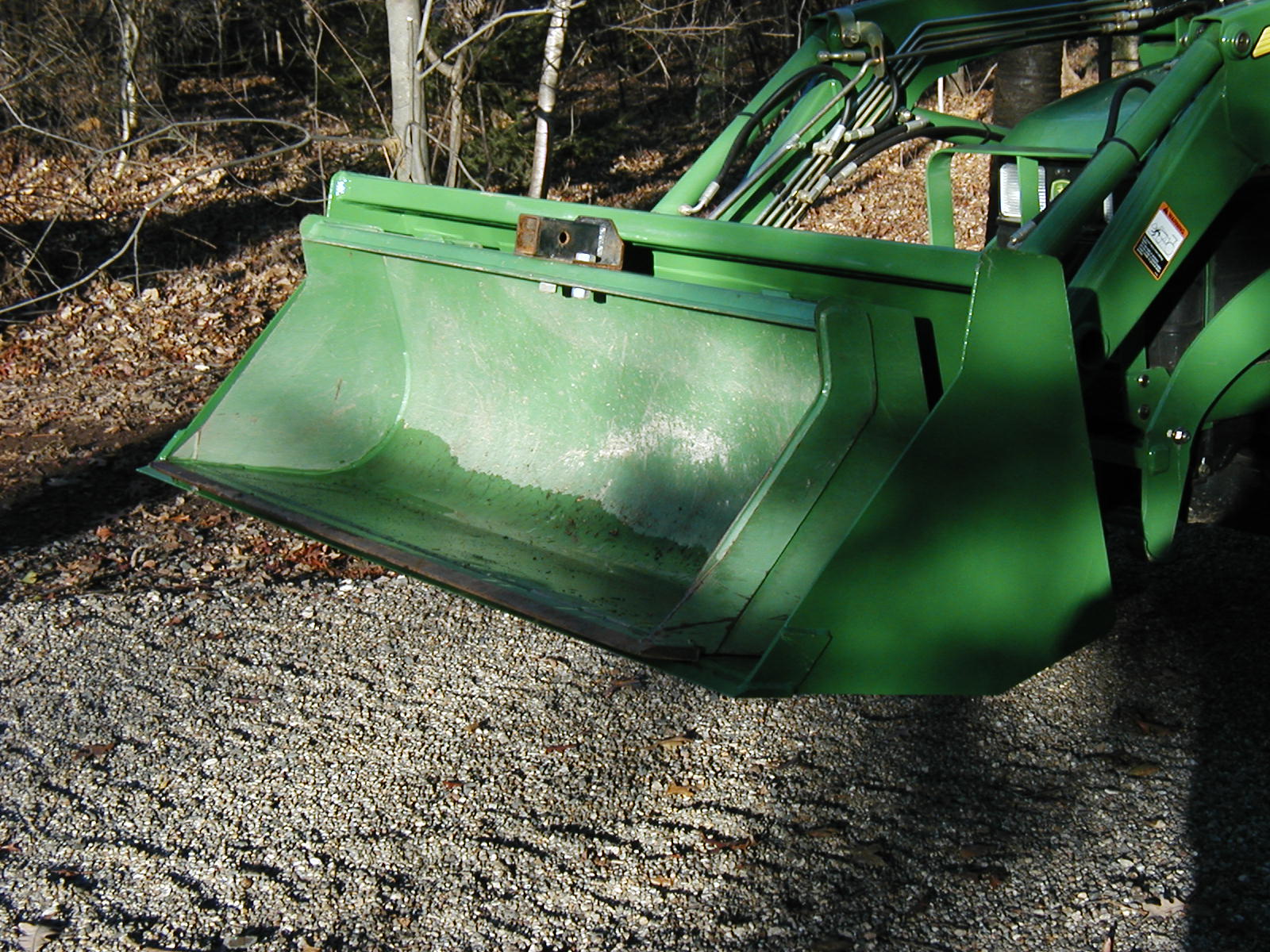

Here's one that I've seen locally, but I don't know how folks like them.

The advantage over a bucket is the capacity of the box. For a number of years now these boxes are all that have been used to clear large mall parking lots. I've watched them and virtually no snow falls over the top and sides like a bucket. They may not be much of an advantage on a small machine but they certainly are a big advantage if you can "push" them.
