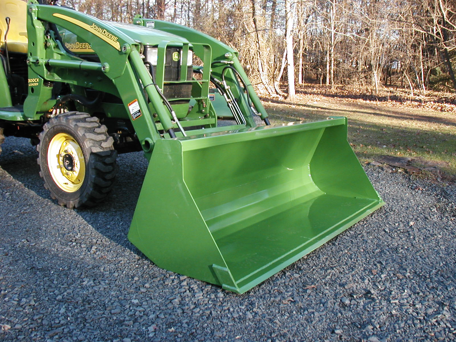

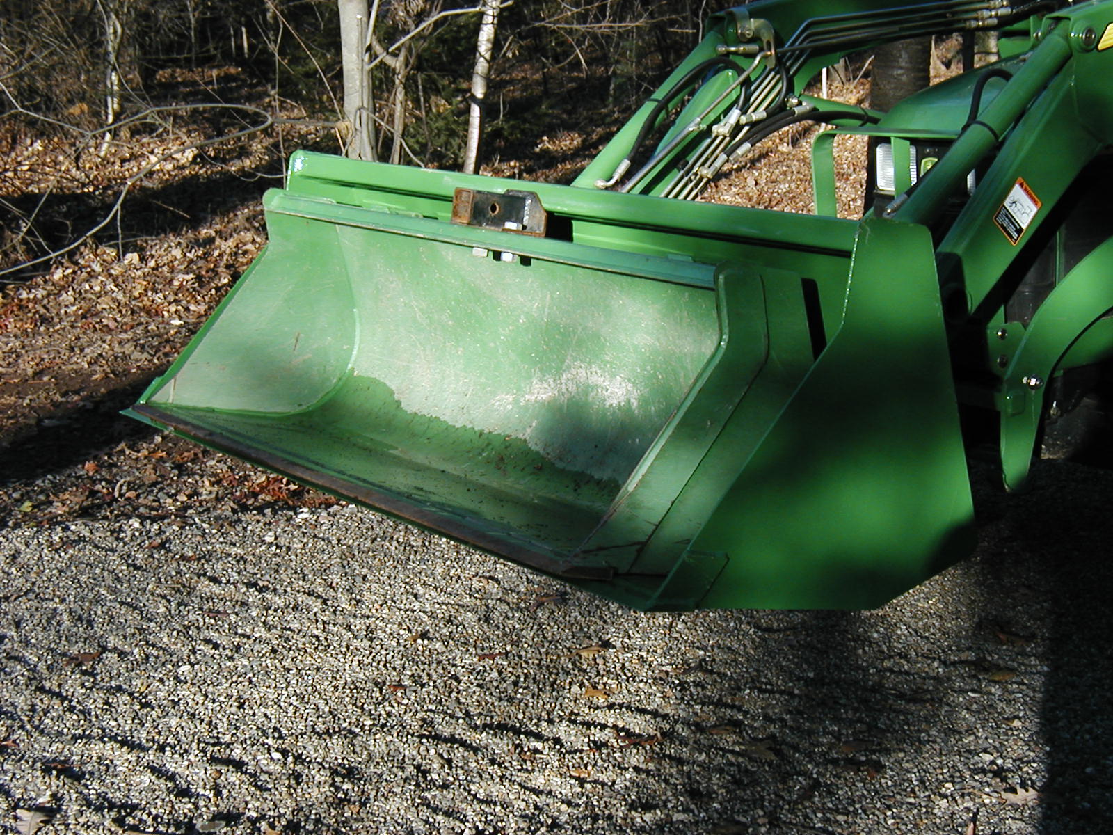

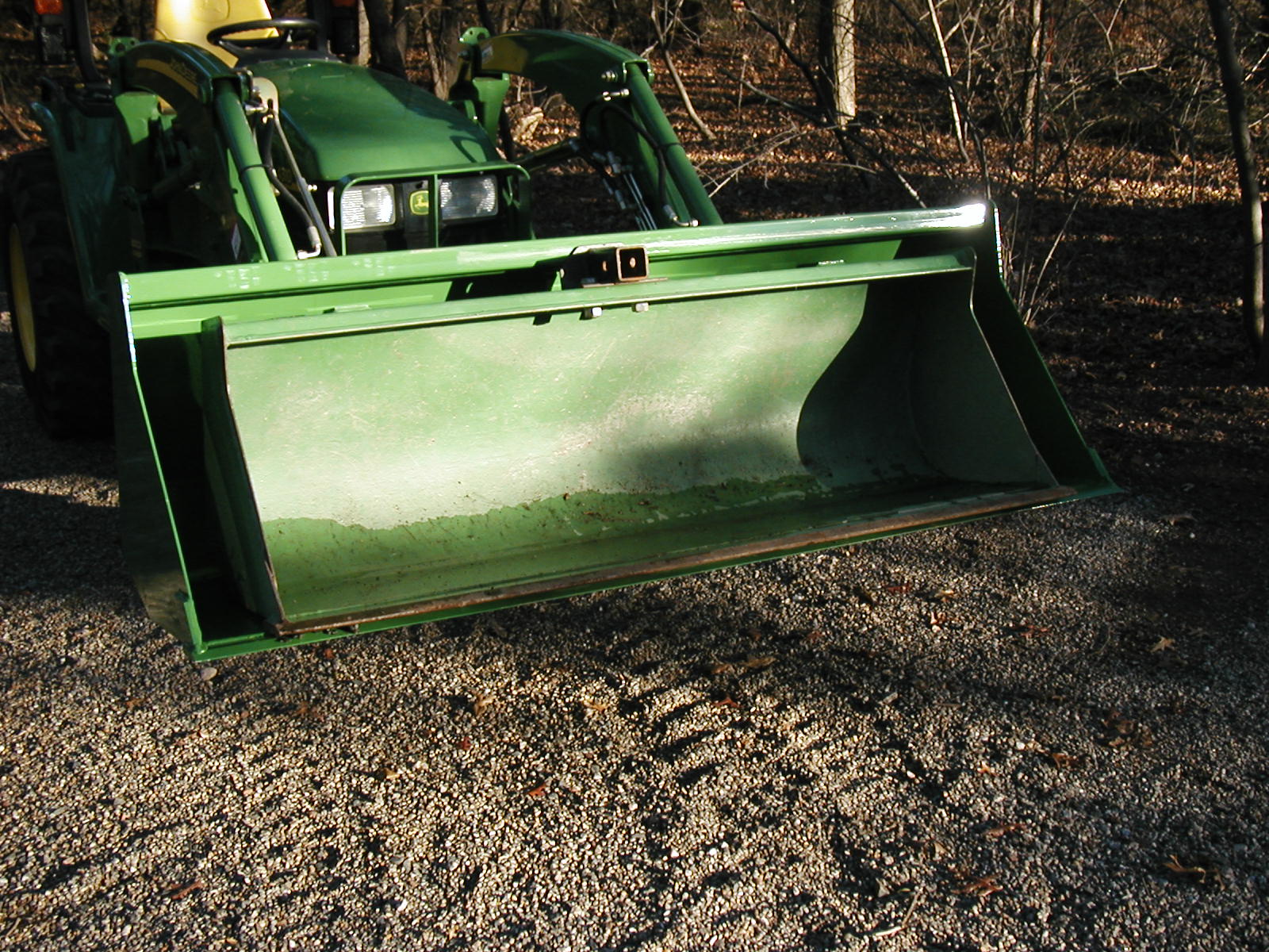

I thought about building a pusher box similar to ChuckinNH's, but instead I just got the largest light materials bucket which is 6' wide and taller/deeper than the standard 5' bucket.
You can push much more before the snow spills out, not as good as a box, but I can still lift and load with it it. biggest draw back was the $950. price tag.
