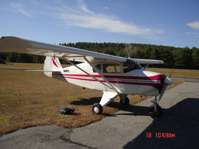

Yes, off topic... but yep, that's a PA-22-150 (flying milk stool, pie-chaser, etc.), 1956 vintage. Wings are currently in my garage, under repair. It had been metalized in '59... makes it a bit more of a hassle to get inside the wings. Not that I have a bunch of time in it, but a sweet-flying plane.

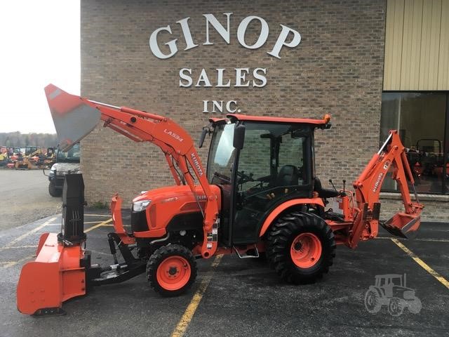

And yes, leaving the BH on REALLY makes the front end light. Going uphill with the blower & BH, I couldn't control it at all; the whole tractor just followed the crown slope of the driveway. After removing the BH, no problems, unless it's wicked icy.
   / Snow removal: bucket, blower, plow? #56
Of course, if you take all the weight off the front, and leave the B/H on, it's going to make the front light. :confused3:
You can't just hang all your weight on one end of the tractor.
Tractors have a CG, (center of gravity), just like aircraft. in order to function properly you need to consider that.
Yes, the blower is heavy. But, when it's in use, almost the entire weight of it is on the ground, not the tractor.
A FEL plow still has the loader frame to weight the front of the tractor, when the plow is down.
If someone is clever enough, to figure out a good way to weight the front of the tractor with the blower attached, you would see a big gain in traction, and control with the B/h on.
Loading the front tires supposedly helps, but they do not seem big enough to bother.
