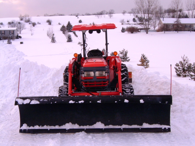

My snowplow is a Western 9' truck plow with power angle. Converted it to SSQA to fit the loader.
Works great. I'm guessing I have around $500 invested in it.
I like that. My cousin has a 9' truck plow with power angle that he said I could have if I want to turn it into SSQA attachment. Have you had any problems with it pushing you sideways when angled in heavy snow. You might be far enough from the Atlantic that your snow is lighter. I used to live in Buffalo and could clear 12" of snow off my driveway with a broom! no joke!
/ Snow removal, FEL compared to snow blade. #16
Before chains- yes. I had problems with the front sliding fairly often.
Of course with R-4's my tractor struggled to go at all in snow/ice let alone push a 9' plow.
I run chains on all 4, so spinning or sliding from the plow is rarely a problem.
