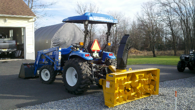

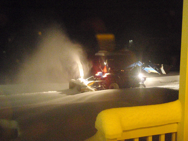

Here is my tc33d blowing through a dense drift. I had to creep pretty slow for this much snow. I ended up getting the neighbor with the end loader because it was taking way too long. The blower is a 5' Lorenz and works good. I usually use a back blade because it is much quicker with the smaller snows. snowblower1.jpgendloader.jpg
