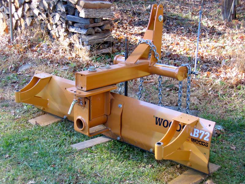

After hours of web-surfing, I have found what I think would work:
These were posted on this forum 12 years ago by a member who has not posted since March 2017. I have PM'd him but don't expect a reply.
This setup appears to be heavy duty - enough to handle the weight of the blade and FEL on float. But it is NOT a Woods accessory (per their tech support).
The curvature of the brackets seems way too precise (i.e. engineered) to simply be someone's fabrication. So, I am guessing that this is someone's accessory...but whose?
Does anyone recognize this assembly?

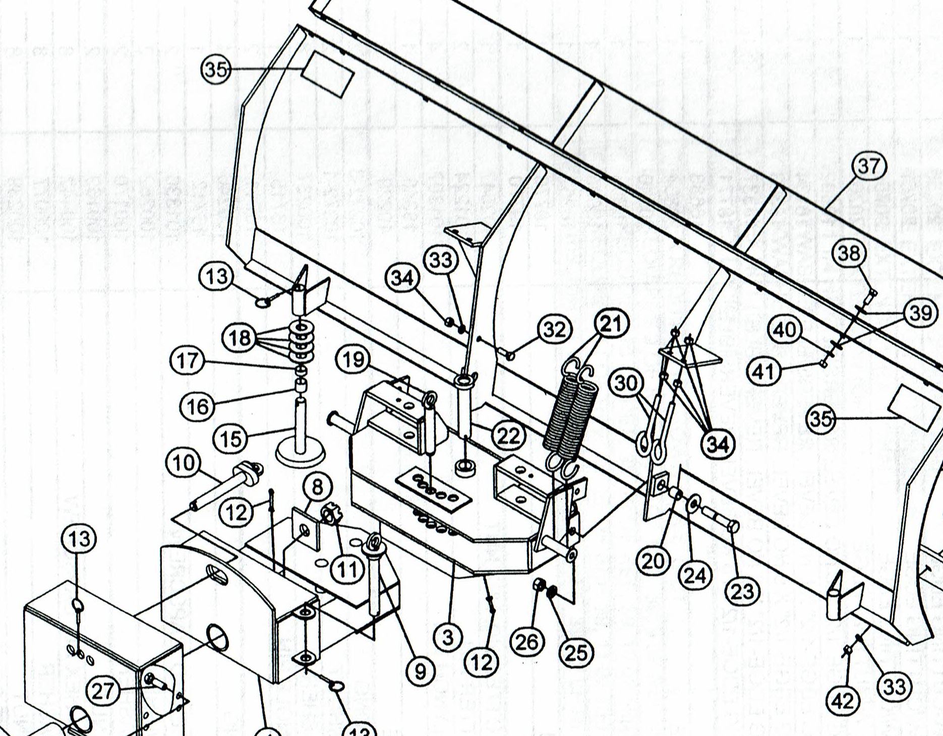

I have been looking at bush hog tail wheels as they look quite stout. They tend to come in either 1-1/4" or 1-1/2" shafts. The skid shoe brackets on either side of my blade take a 1" shaft. It would be great if I could re-use these skid shoe brackets - item 13 in the picture.
If I was to test the effectiveness of these tail wheels, I would either need to weld on 1-1/4" or 1-1/2" skid shoe bracket or have a machine shop grind these shafts down to 1". Not sure which would be more cost effective.
Actually #13 in picture is linch pin... Do you mean bracket above #18 shim stack...
Dale
   / Snow Removal On a Chip & Tar Driveway
#28
Dale
Yes - sorry. The actual bracket itself was not referenced so I pointed to #13 to direct you to the right area.
I have spoken with several tailwheel manufacturers and all expressed concerns about the tailwheels being able to handle 2,500 lbs of weight.
I am beginning to focus on a "softer" blade...either wood as previously mentioned or rubber (horse mats or these...Rubber Snowplow Cutting Edge 725 PSI).
This would require holding the blade above the pavement manually (which I do now) but at least the penalty for actually hitting the pavement is not as severe as it would be with a steel blade.
