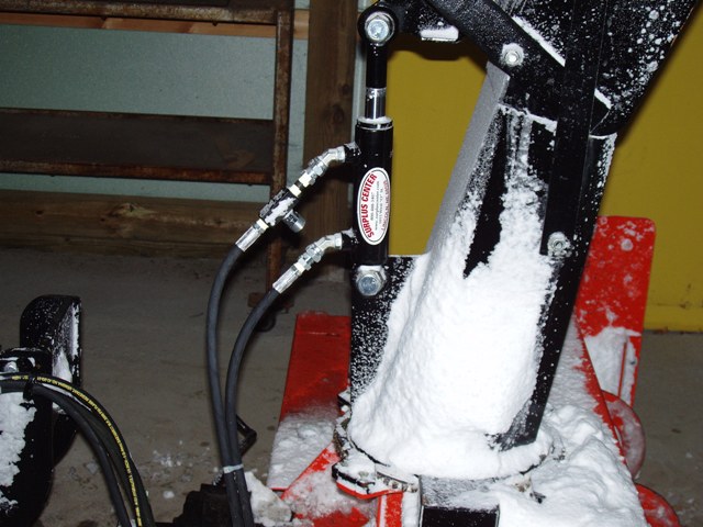

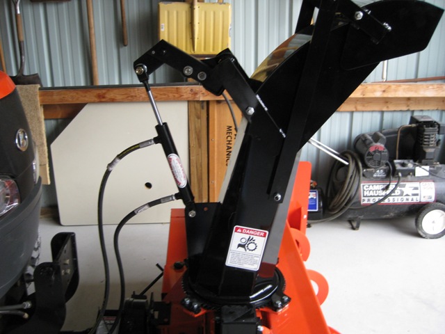

Acher.
You have a close up of the hydraulic chute tip? I done mine a bit different. You can use a longer cylinder that way and have more control.
Mine works good as it is and I do not move it often.

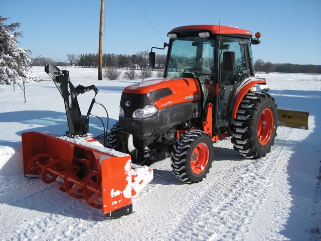

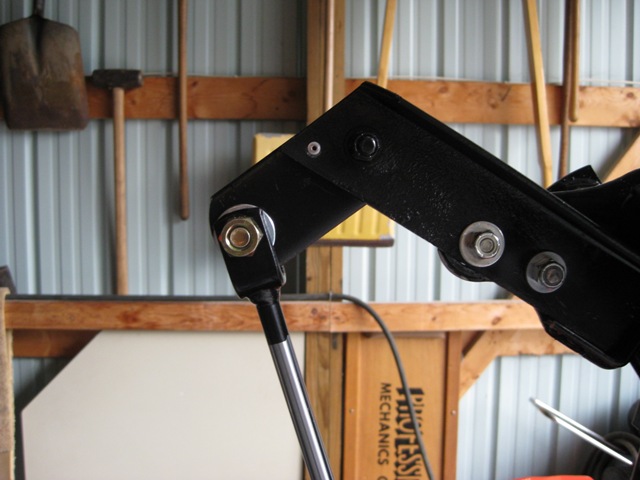

Acher.
I actually use mine quite a bit. The ideal cyl would be a 5" stroke. I could not find one, so that left me with a 4" or 6". I didn't feel a 4" would give me enough adj. so I ordered a 6" from Surplus Center. To get a 6" cyl to fit when retracted, I needed to order the cyl with a 1/2" rod. https://www.surpluscenter.com/item.asp?UID=2156122620360416&item=9-1649-06&catname= The problem with the 6" stoke is the fully extended it is too long. I went around and around on the best way to get the 6" cyl to fit. It was discussed on TBN in another thread. I thought of putting a chain to limit the stoke, I also considered cutting off the tie rod end and then cutting an inch off the rod and welding the tie rod end back on. Neither of those ideas was real easy for me since I don't weld and the chain I would have needed to use was really too big to get it to work. So the easies thing for me to do way lengthen the actuator to accommodate the longer cyl. I use existing holes, and made bushings where ever I could and drilled new holes where I had too. It was necessary to make an angled actuator to get the cyl to travel through it's complete throw without binding. When all said and done, it may look a little funny, but it works wonderfully.

I used the ball end 4" stroke. It is plenty of travel. That allowed me to just bolt it on with 2 - 3/4" bolts. I did move the arm a small amount to center the cylinder in the travel range.
I cannot quite reach full travel on either end but can put snow down right next to the blower or out as far as I need.
The chute travels further than needed. I played with mine 2 winters before I put the cylinder on to see the travel requirements.

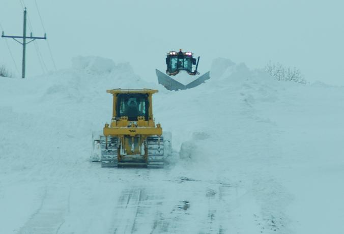

We had 15" two weeks ago with blizzard conditions (35+ mph winds). This past three days saw another 12-14" with some of the strongest and sustained winds that I can remember. We were at 40-45mph for about 6 hrs through Christmas eve. These are the type of storms I recall from my childhood.
Here's the 'lil red hero of the weekend (for me)... and the county road crew getting through 10-15 ft drifts with a dozer and v-plow grader.
One more dump like these last two will make it very interesting. There's no place to put any additional snow!
