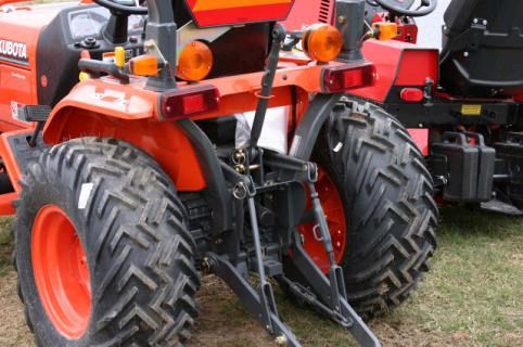

I have the standard loaded Turfs and they work great. I only add chains all around because VT gets some nasty freezing rain on occasion and I leave them on throught mud season because turfs are useless in mud.
I push a 6 1/2 foot plow on the 3 point...no problem in 16" of snow.
I bet the "bar turf" tires in the attachment are really good in snow.
