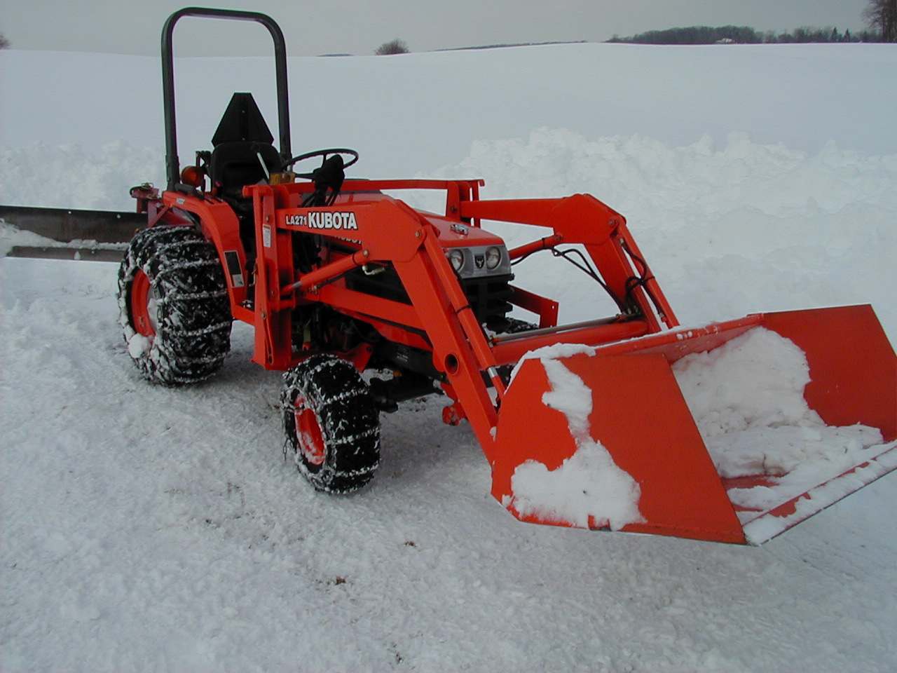

I have a 2200' gravel drive that has two areas prone to drifting. Snow fence helps, but if it gets bad, I can end up with 4 to 5 feet of snow. Only way out is the loader. Winter of 2001/2002 I learned that a 6 cubic foot bucket took forever! So summer of 2002 I fabricated a light duty "extension" that could be bolted on to my existing bucket. It adds 18 inches to the bottom and sides of the Kubota bucket and almost triples the capacity (in heaping snow). I also added two "runners" to keep the lip of the bucket 1 inch off the gravel. Last winter, when we got our 30" plus blizzard (Feb 2003) I actually got to try it out. Worked like a charm! Was able to take quite a 'bite' out of the 5 and 6 foot drifts. Attached is a picture (you can see the color difference between the LA bucket and my extension)
