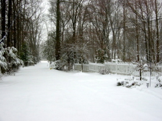

I took the blower off the Simplicity last week.
Then 6" of the white stuff came....
Here's what 660' @ 6" looks like to do with the FEL...
