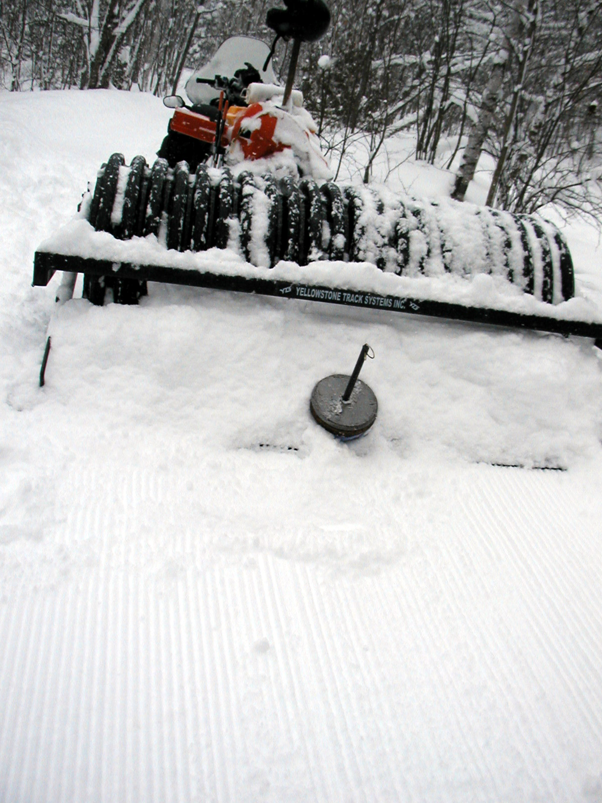

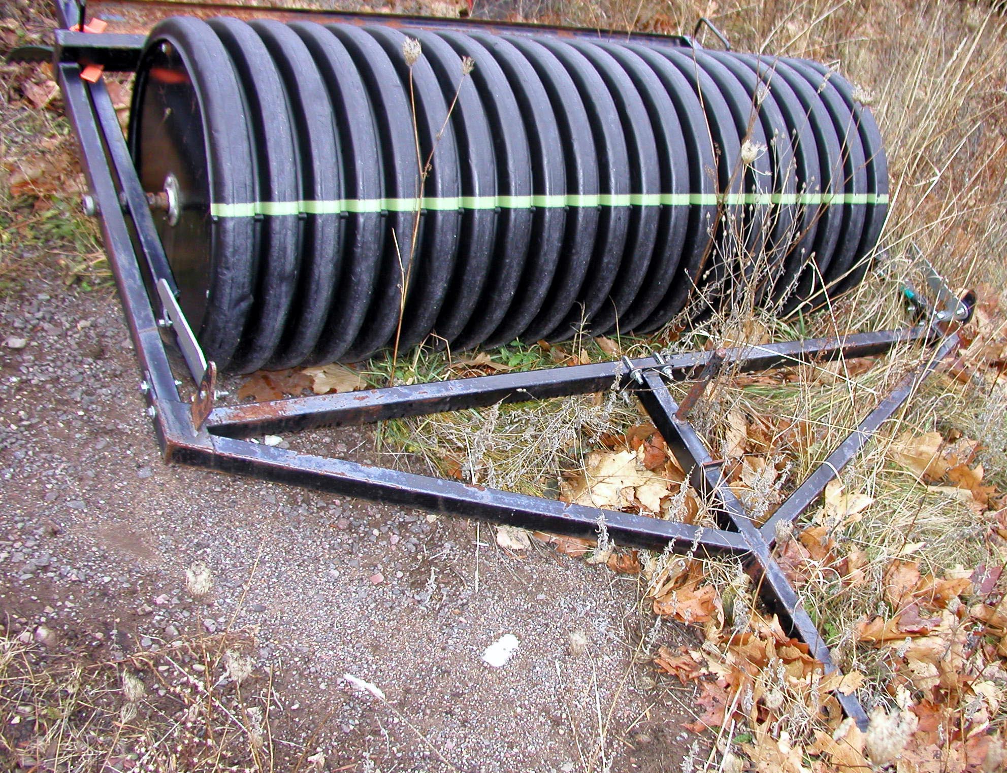

I am in the process of constructing a roller to pack snow that is used on cross country trails. I've used these for many years and built one before since they don't quite make them in a fashion we appreciate. One or two company's do build them here in the states and I'll post some photos of them in use. Let me know if you care to see how this version is assembled.

Good afternoon Arlyn - That's a real interesting implement. Are those black "wheels" specifically made for use in making a snow roller?
/ snow roller for XC snow
Well Rolf, those are just plain ol HDPE culverts cut to length. :)
/ snow roller for XC snow #4
I'd like to see how it's assembled. Do you have much weight inside the culvert piece? Solid? What is the rear rake made out of?

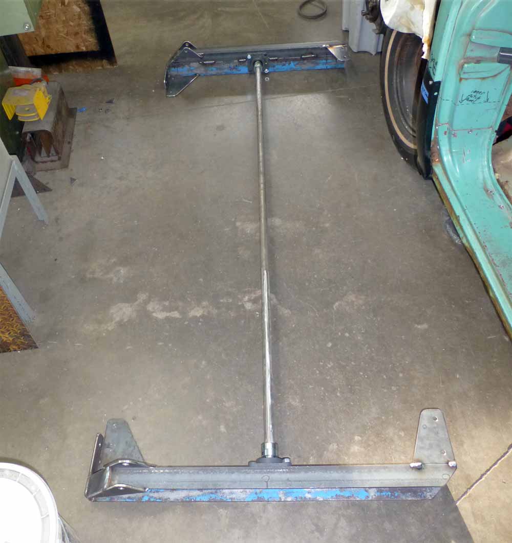

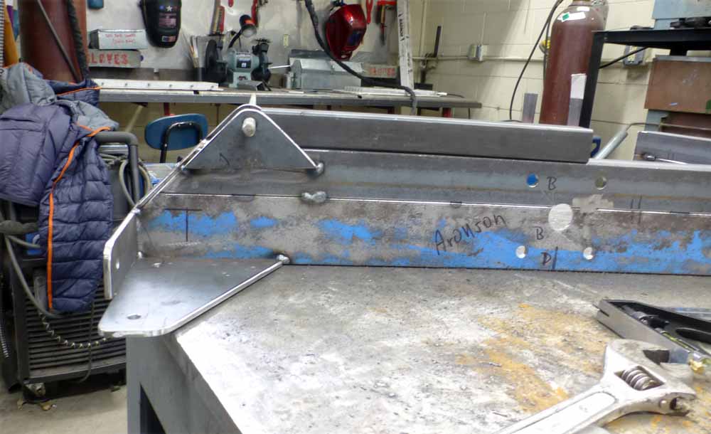

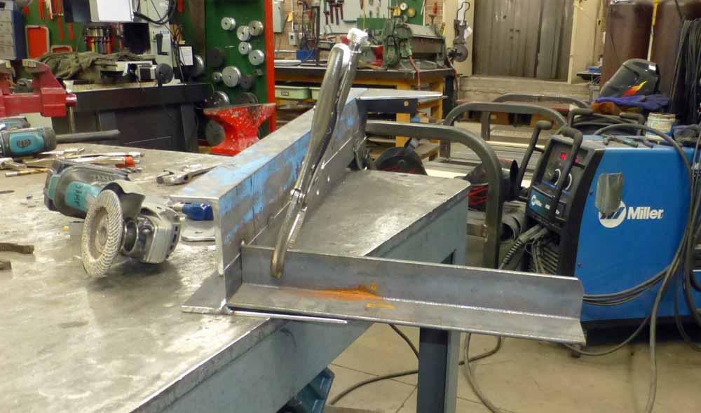

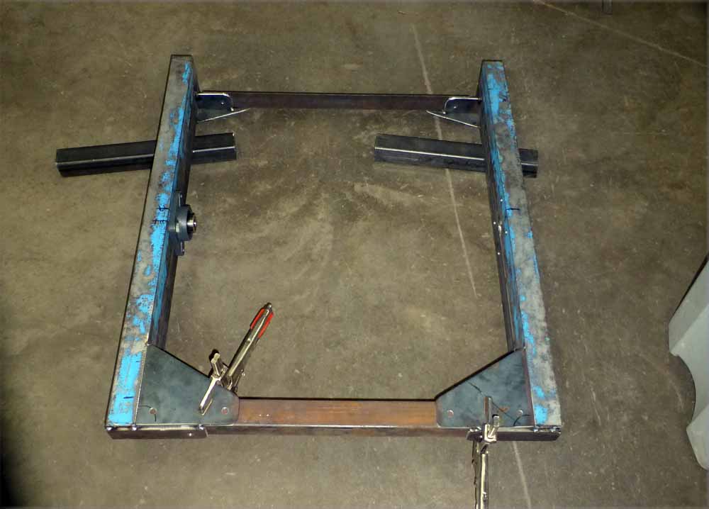

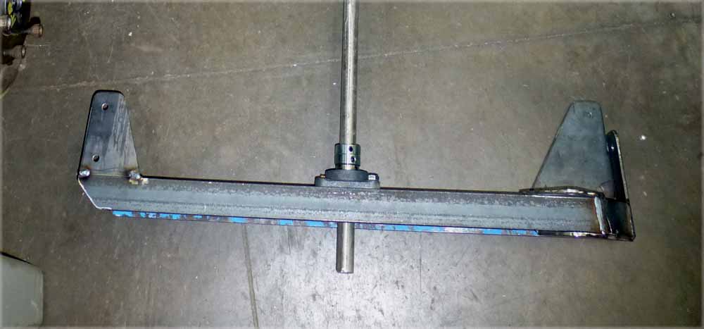

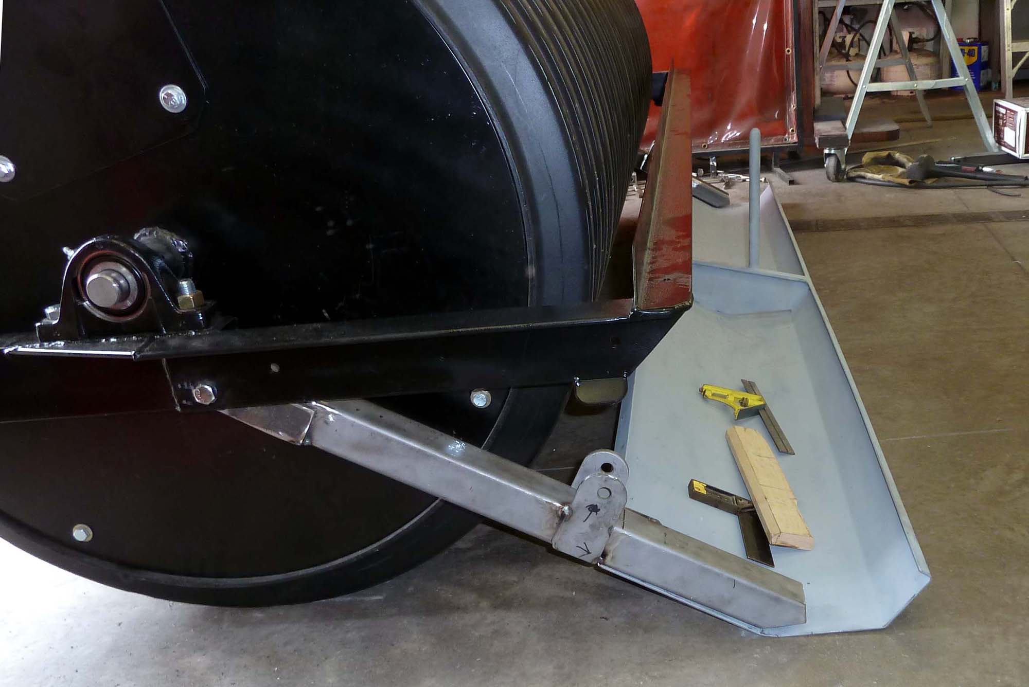

Here is a few photos taken so far... This is details of the side frames which holds the bearings and basically the hole thing together. I made this implement be able come apart so you can readily service the bearings or culvert, etc, etc. There will be a 2x2 1/8 angle across the rear and a 3/16 walled 2x2 across the front. The last photo show how the front and rear frame members will later be installed.

Here is another view but the frame is upside down. It shows the pivot mount for the pan which will eventfully be a 1/2 bolt. The frames front is the left side.

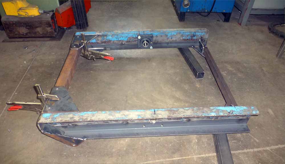

Here is some with the shaft installed and bearings. Do note, the frame is again, upside down. The side frames are 2 x 6" channels. In the last photos, the frame was assembled with stubs of scrap, just to see what it looks like.

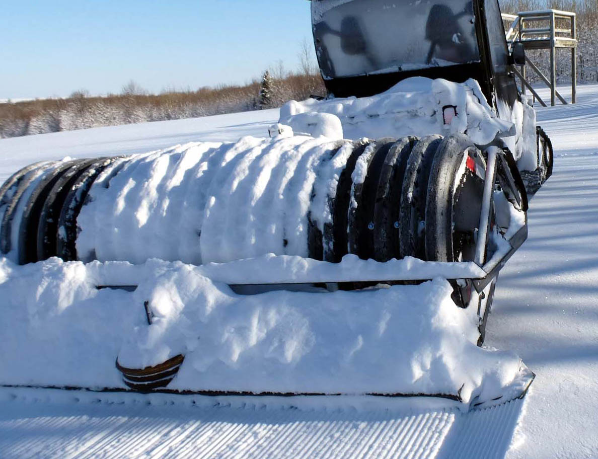

May I ask what you'll be towing it with?? The roller is not filled with anything, but air. It wouldn't last very long is it had a bunch of weight added to it. Having said that I will likely add a weight peg to the front of the frame, and to the compaction pan. Below is a photo of the last roller I built with its pan and weight peg as it was being built.

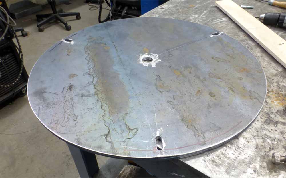

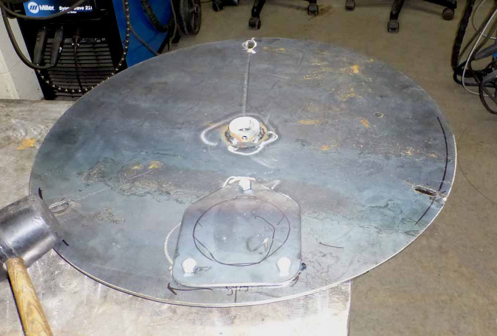

Here are the end caps i worked on today and are 2ft by 3/16 thick. Here you'll see 2 stacked on each other in all photos. Why not measure and cut them once?? The larger hole is for access and disassemble the roller and will have a flat bolted over it which is the nest thing to be built. Clear as mud???

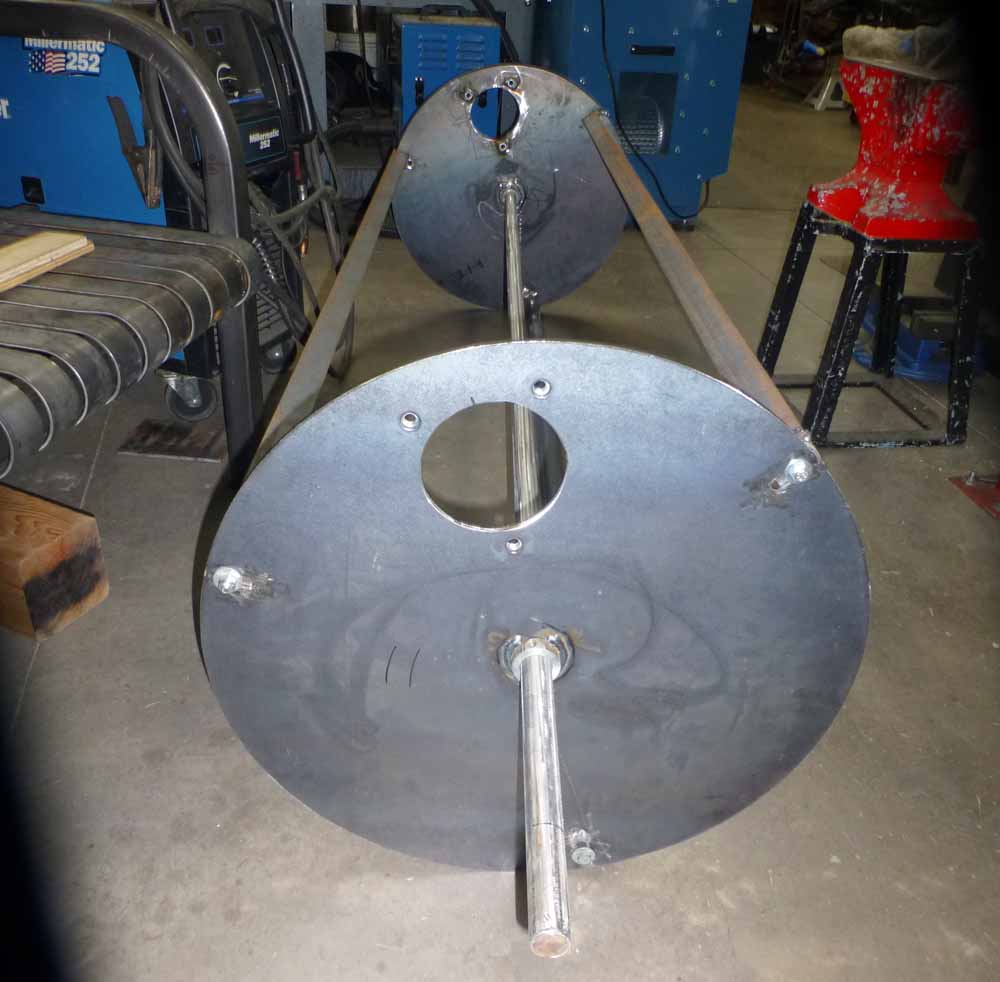

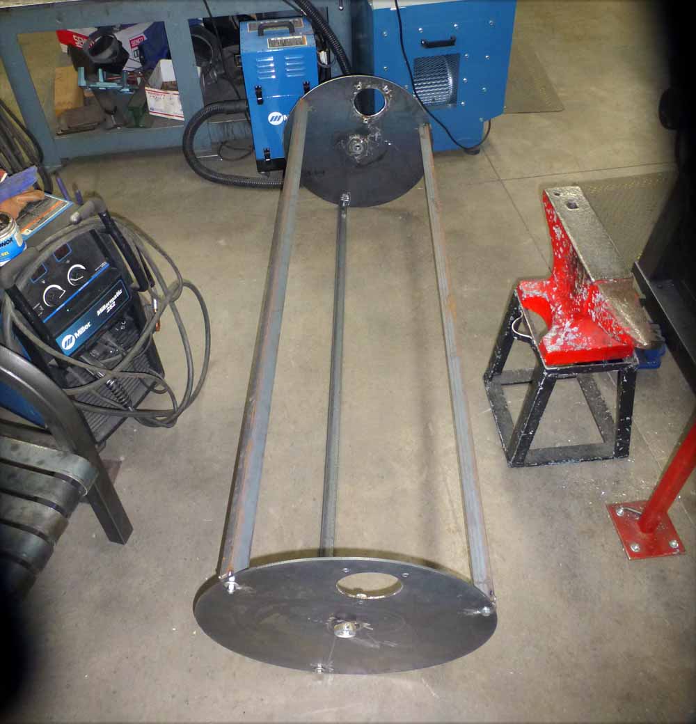

The end caps were fully assembled today and a mock-up built afterwards.

I didn't realized you had extra structure inside. I had assumed you used the culvert as a structural member.
#18
James, YTS did add install angle irons to the inside in there original design like you see I'm doing. They subsequently removed them and just used 1 ft long something into the culvert and bolt the end caps to those. No shock, they eventually break off at the bolting points. These culverts are rather poor structural members and flex much. I will use some washers on 1/4 bolts to each end of the angle irons inside the culvert and I might use 8, grade 5 bolts per member with nylon cap nuts.
I painted and finished parts today and will post photos shortly.

The internal angles were added. Not properly bolted but holes all drilled. Each memeber will have 7, grade 5, 1/4" bolts.
