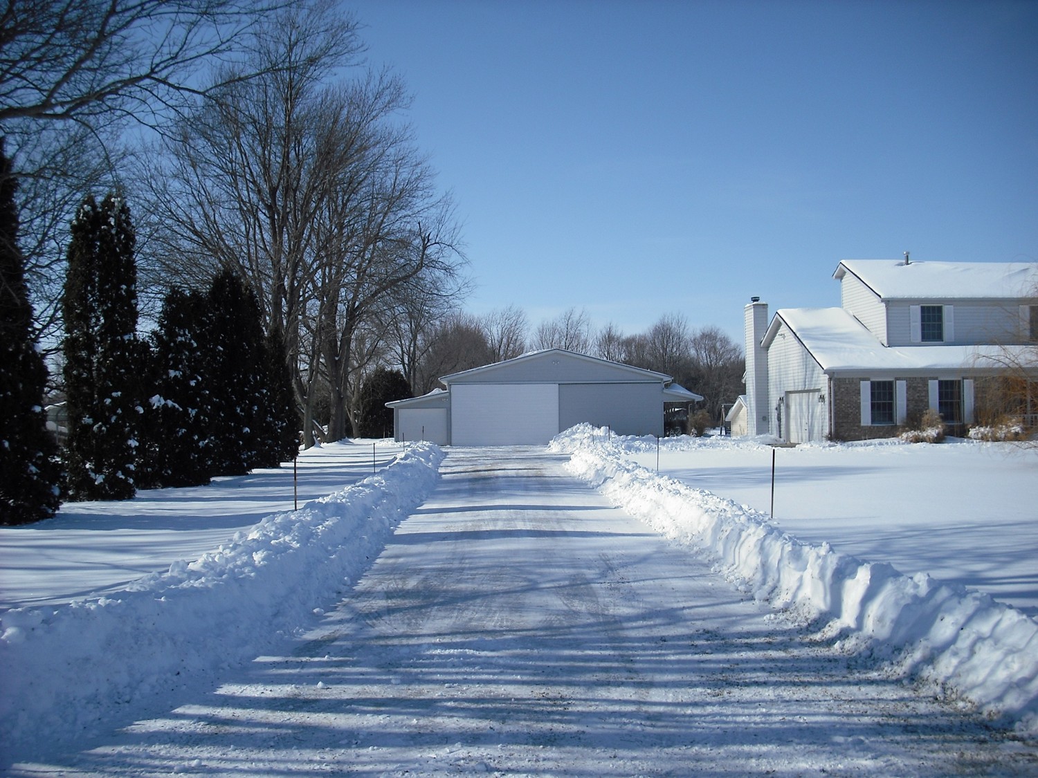

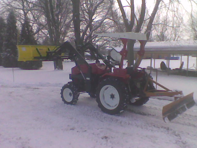

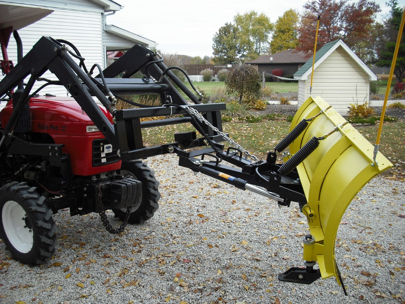

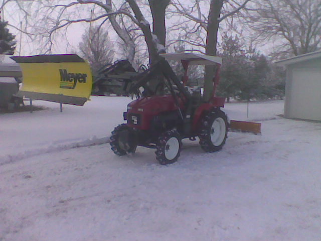

Not sure what type of tractor you have but I have found speed is king. I used my FEL and 7' rear blade and before that a 6' blade behind my 4x4 Jinma 28 HP tractor. Weight on the tractor will also help with the speed, I am at 5,600#.
I now run a 7' Meyer snow plow in place of my bucket on my tractor and run about 7-8 mph when pushing snow. I actually run with the snow plow down and the rear grader blade also. I can move 12" of snow off a 400' drive in 2 passes and about 5 minutes.
Chris

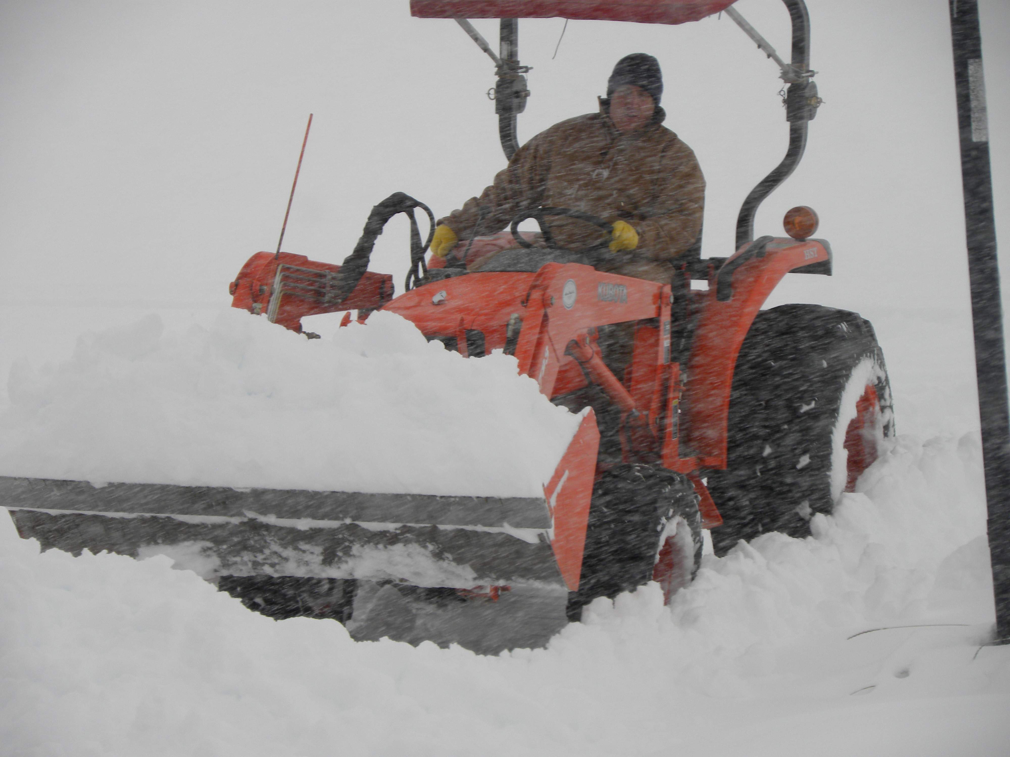

I second the staying ahead of it comment. I am in my first year with my Kubota (Gravely riders with snowblower, blade, loader previous years) using my FEL. It goes fairly fast, just scoop and dump in pile when I can't push it more until I get to the end, then scoop across to clear the end piles, seems to work well.
We got 15-20", several deep drifts, one about 7' (that I do not have to clear). We had rain and almost 40 degree weather the last few days before the snow started early this morning. It was right at 32 degrees and snowed most of the day.
I need to move things around in the shop so I can put the back blade on and give it a try. I need to pick up a piece of pipe (will ABS work?).
