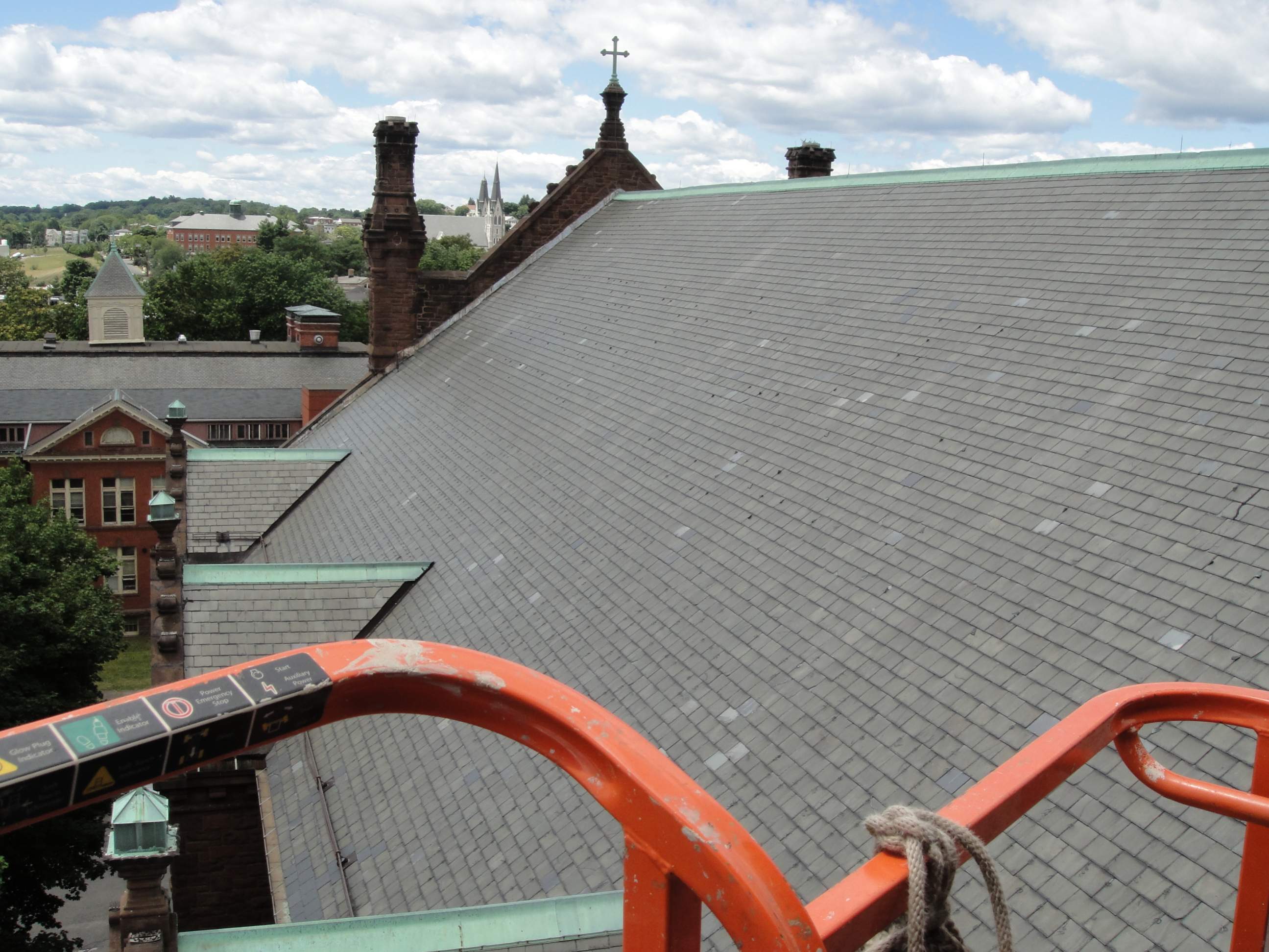

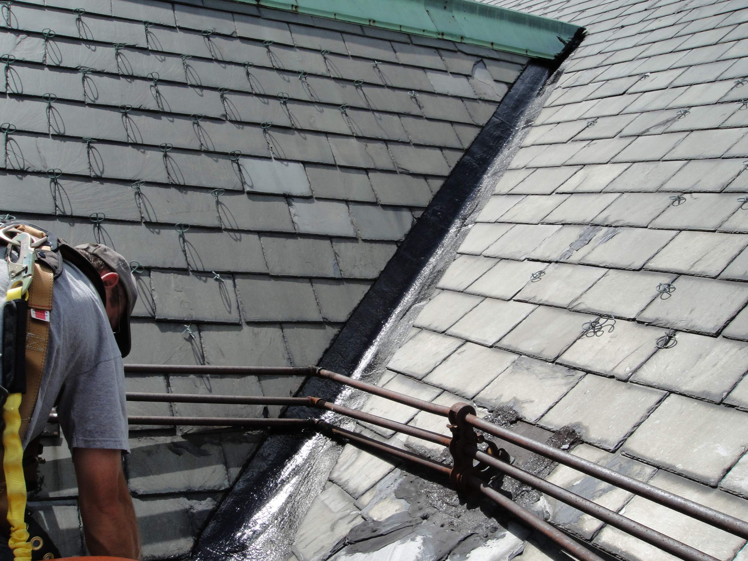

My first impression was just live with the snow sliding off, even if you have to straighten gutters once in awhile, it's better than shoveling off roof.
On some roofs the snow gaurds do damage to the roof. On slate roof homes sometimes when heavy loads build up it will rip the gaurds out along with surounding slate.
On the old churches I work on the loads are wicked and tears up the HD pipe system almost every year, bends them like bannas and tears out the base plates once in awhile. I'm sure this year is gonna be bad. Look at pic, imagine the load coming off this roof, the pastor that lives in the rectory next door says it shakes the house and sounds like a freight train.
JB.
