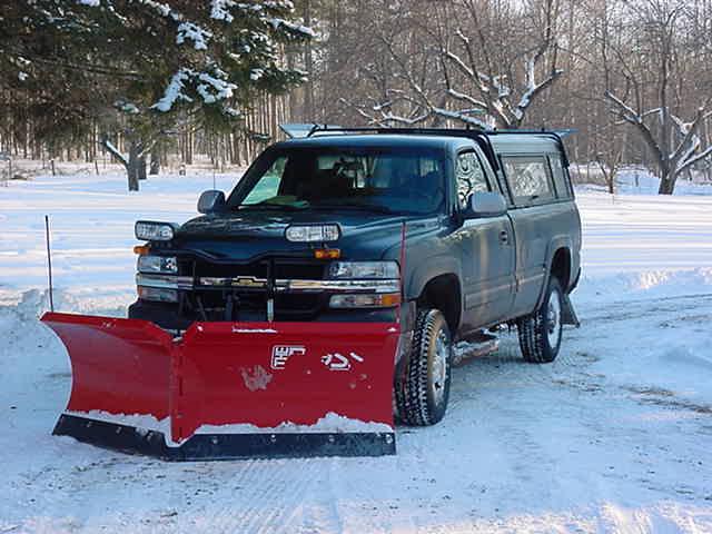

Follow up to previous post. Did a little local research and found out the following:
1. Local City with 12 plow trucks, 2 graders and 3 loaders, quit using wax on their blades some time ago and currently use nothing.
2. A local distributor for a large snow plow mfg. co. said they don't use anything, but he's been meaning to try something on his own plow for several years ?
3. The Head mechanic for local DPW stated that he uses 2 coats of car wax on the front and back of his personal plow.
4. An experieced equipment operator (+30 years) stated that he uses car wax also.
Based on my meager research, going to Wally World tomorrow and pick up some car wax. If that doesn't do any good will try ski wax per earlier recommendation.
penokee /forums/images/graemlins/smile.gif
ps: Attached pic of blade I want to wax - last winter

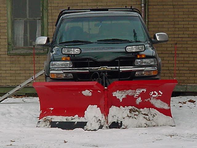

Better pic of how snow sticks to blade.

Tried a quick spray of Pam on the blade last Saturday and it worked like a charm!!!
