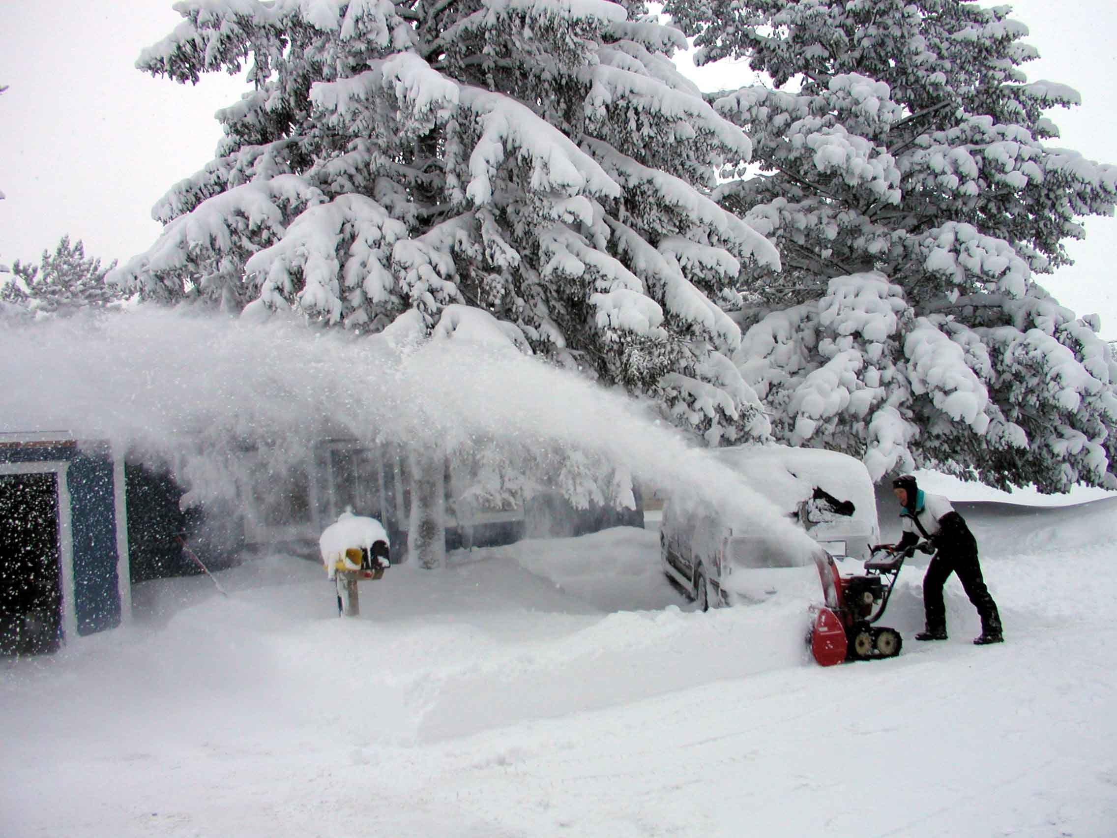

We have a Hondu with tracks, in fact its the 2nd one after wearing the 1st one out. We do get snow here. They do break shear pins, but that's an expendable part.....
