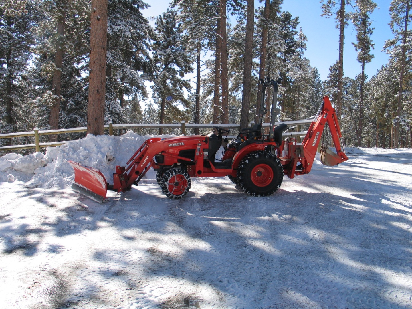

Here's my snow removal rig...
I have problems with the R4s after I've started plowing and the little remaining snow skims over the asphalt turning to hard pack or ice, then the front tires slide all over. Most of the time when I need to chain up, I can get away with front chains only. Front and rear chains, and there's absolutely no stopping me, but I don't think I've chained up the rears in 2 years. Haven't chained up the fronts yet this year, but I'm sure I'll need to eventually.
If I recall correctly, I got my chains from www.tirechains.com

I'm in the Great White North (Ottawa) and we have about the same amount of snow on the ground as in your photo. Mind, it's -12c today (something like 10-15 F) so it's Brass Monkey cold ;)
