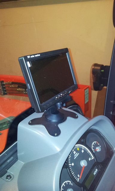

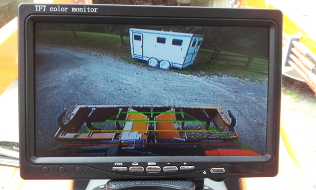

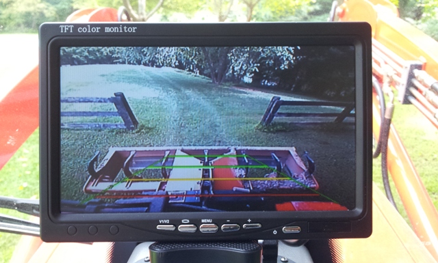

Several posts have mentioned having to twist around to blow snow in reverse looking over your shoulder. I don't have a blower, but I plow in reverse and the contortions get old real fast. For members with cab tractors (and maybe even those with open stations), consider adding a backup camera, with a 7" monitor mounted on the dash or windshield. You can do it for about $50. 94BULLITT started a TBN thread recently on this: http://www.tractorbynet.com/forums/customization/316927-backup-camera-50-a.html I did this following Roger's lead a few weeks ago, and you can see the quality of the images I get at post #120. I've reposted them below also. Really helps when grading. I'll be curious to see if it's as useful pushing snow this winter. The camera is waterproof. The monitor isn't, so with an open station, you'd for sure need to slip a clear baggy over it in rain and snow.

Did the camera installation 2 wks ago and that looks like a sure winner.(I have a cab)

I think for snow usage, especially with snow blower or during a storm, that camera will be covered in snow. I do think it's a good idea, BUT if you NEED this to operate, i.e. because you can't turn around, then a rear mounted machine is not for you.
