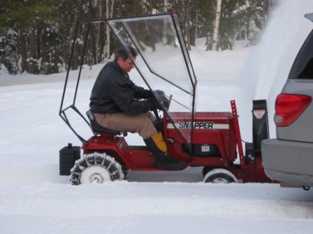

I've used a 36" 2-stage snowblower for a couple of years on my '87 Snapper LT16. It works very well, but the nagging problem is traction. I have about 60 pounds that I hang on the back of the tractor - seems to make a fair difference. I run chains, and it does pretty well, but does sometimes get stuck, usually due to loss of steering. Luckily, I can give it a good yank and pull the thing out by hand. Steering is the biggest problem - I don't have chains on the front, so it can be stubborn, but raising the blower a tad usually gets it going in the right direction.
You'll need a cab, or at least a good shield. It isn't a luxury, it's an absolute necessity. I made one out of sheet vinyl and electrical conduit for $29:

Hi,
I think you did a Great Job with the Homemade Cab. Anychance you can take a closer pix so I can see how the Joints are? I checked out the Corners and the 90 Degree Angle on the Conduits, but they only have T's but no 3 corners T's.
I'm gonna start doing my Cab next week, really need to see close up on the Corners if you can help. Thankx in advanced!

I didn't use connectors - the limitation of 45 and 90 degrees is why I didn't want to use PVC. I simply bashed the end of the conduit with a hammer to squish one side of the pipe, which leaves a nice curve to sit against another piece. Then I welded the joints with a Lincoln Weld-Pac 110. Then a can of black spray paint to cover up my ugly welds :)
Action shot:
Action shot:
JayC
OK, Thank You!
Hmmm, you just made my job harder... I don't have a Welder :(
I'll come up with something I'm sure :D

Another option is to smash the ends of the conduit flat, then drill holes and use small bolts/nuts to connect everything together.
