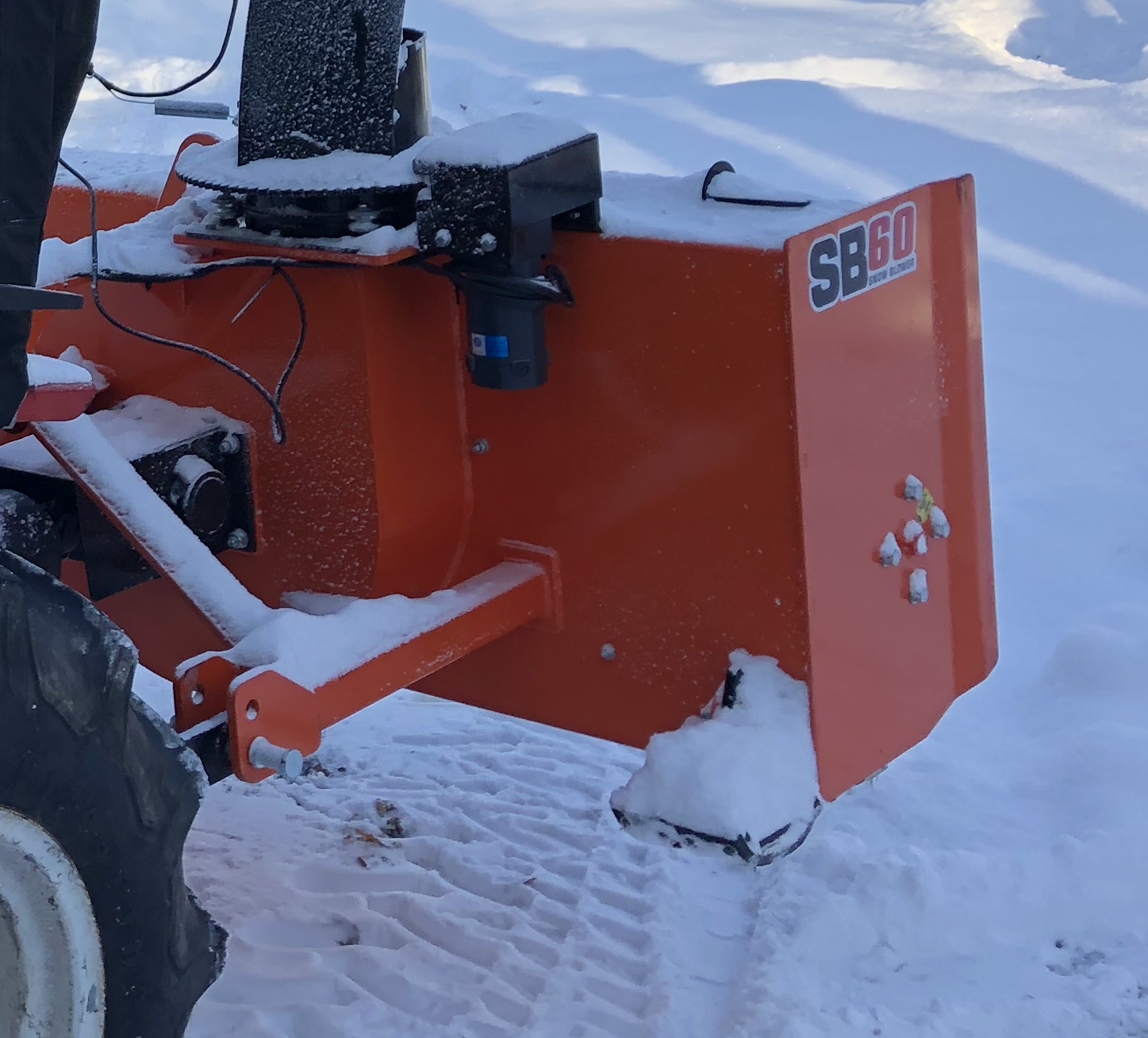

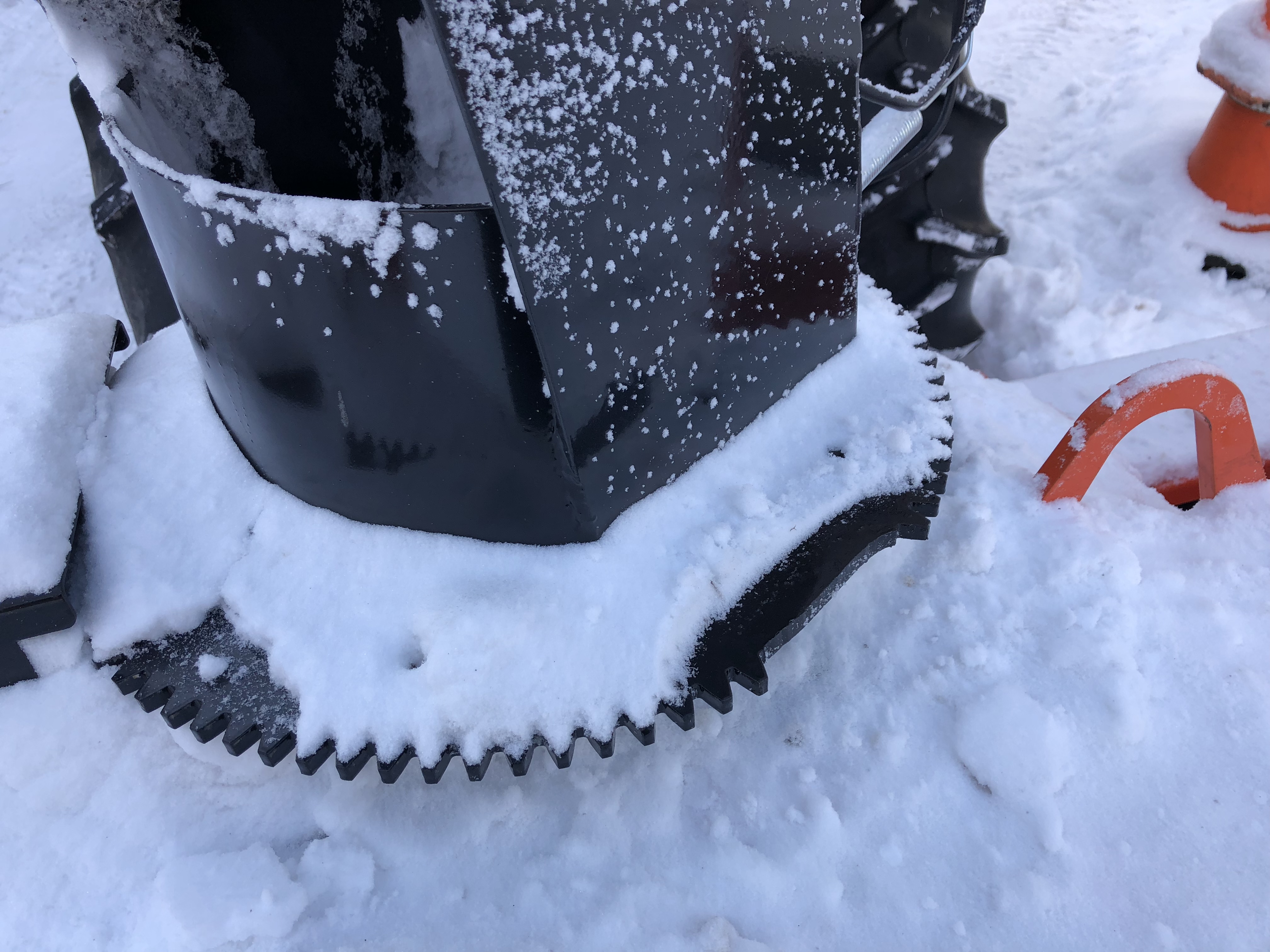

I got the electric directional control option on mine. After some thought on the fact there is no actual stops either mechanical or electrical to keep the chute rotator from just spinning around and ripping off the wires to the angle actuator I came up with a simple solution:
When the shute is aimed directly at the back of my head, I marked and sawed off the teeth that were engaging the motor at that point (about 6 of them). Now when it goes that far around it hits a dead spot and just stops rotating. (about 320 degrees of rotation) I do have to get off and give it a nudge to re-engage the teeth again if it goes too far around now but its better than ripping a cable off. Pict tomorrow.
** also mine came with the new wider feet. 2x wider than what the website shows. I added UHMW plastic to the bottom of them as others have shown here.
   / Snowblower coming weighs 760lbs #19
Here is a picture of my modified chute to give it a dead spot so it does not over rotate with the electric s. Also here is a picture of the “big foot” pad that mine came with. 826F8BFF-55D0-482A-8833-0AA10AEA229B.jpegD691CD38-F45A-4CFC-B74D-4C32E0A88881.jpeg10746167-4D8B-4F5B-87E6-6267999D31E7.jpeg

I was thinking about tack welding some kind of a bumper to stop the 360 degree rotation or wiring it so that if I go to far it wont rip the wires out.
