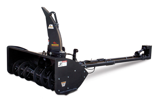

True in many cases, but there are exceptions - like front blowers driven by a shaft from the rear 540 pto, and the growing market for add-on "wet kits" that produce high flow hydraulic power from a rear pto pump to run hydraulic implements. Like with everything else, change is inevitable, and its often good.

TRR,
Snow blowers for tractors are available any way that you wish to drive or can afford them.
Rear PTO powered push backwards and pull forwards types.
Rear PTO powered drive shaft to front mounted blower.
Hydraulic driven front or rear mounted powered by the tractor hydraulics or a rear PTO powered pump.
Front PTO drive blowers seem to be pretty much only available from the tractor manufacturer.
Here's a link to some of the types mention above.
Snow Attachments for Skid Steer, Mini Skidsteer and Tractor - Erskine Attachments, Inc.
