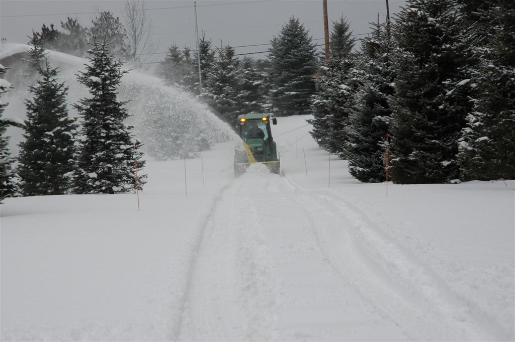

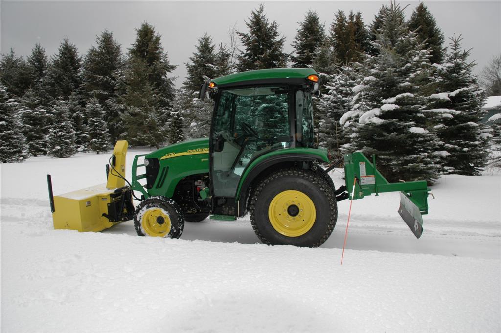

I have used the front blower/rear plow set up for 14 years and found it to be faster then my neighbor's set up with the rear blower/ front loader. I can switch out the blower to the loader in 15-20 minutes and have never had a problem getting enough down force on the rear blade ( I did make a bracket to add suitcase weights but have never needed them).
Back when I was snowcross racing I used my 955 with front blower to build a track in the side yard that had an 8' high table top jump, I had no problem cutting the 4-5' banks and throwing the snow 40'. No need for a loader in my opinion.
