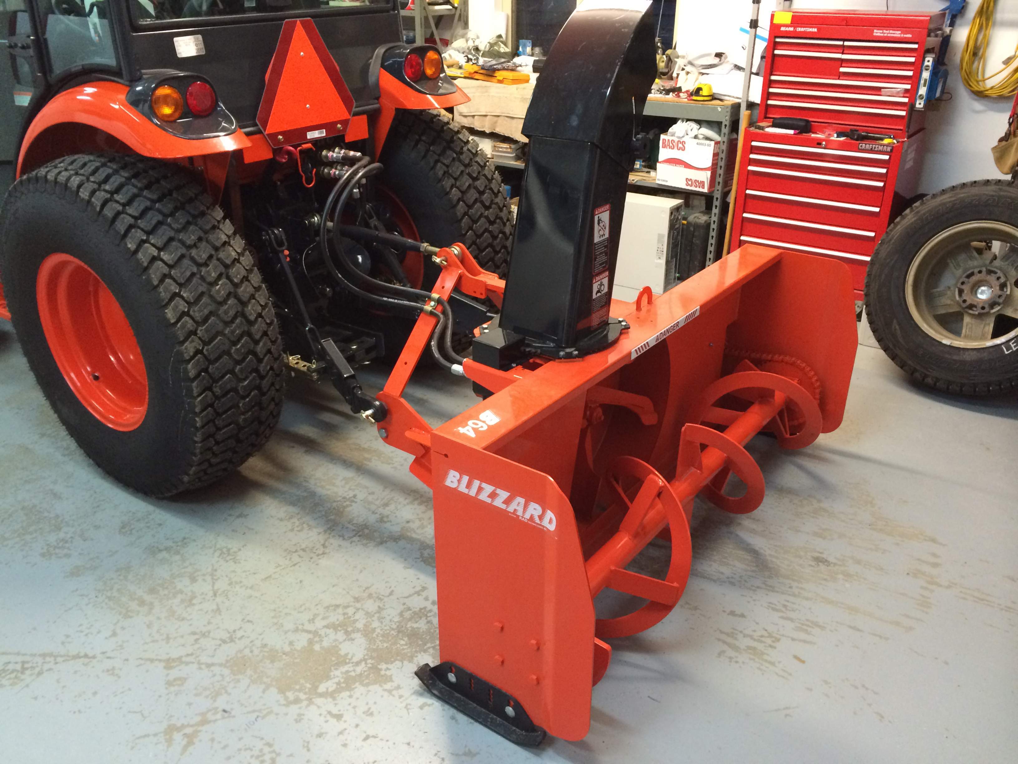

I have a 64" Blizzard by RAD Canada. I'm very please with it so far (About 40hr's of snow blowing). I unit is heavy, well build, and can really fire snow. I would definitely recommend Blizzard. 003.jpg

I have a 64" Blizzard by RAD Canada. I'm very please with it so far (About 40hr's of snow blowing). I unit is heavy, well build, and can really fire snow. I would definitely recommend Blizzard.View attachment 410396
Thanks so much for the vote of confidence!!!
