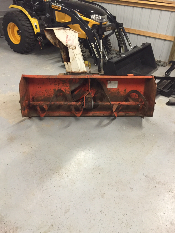

Bought a used bl 2563 Kubota rear blower this fall. I put it to its first heavy use today. The blower was working great. Then I backed up into a pile of snow to hard and the auger quit spinning. I pulled it in my garage to change out a shear bolt and thankfully I picked some extra ones up. Well neither shear bolt was busted and the auger still wouldn't move. When I removed the shear bolts I realized 1 of the previous owners used regular bolts not shear bolts. Needless to say instead of a dollar shear bolt I broke the $1200 gear box. I guess I should of replaced the bolts when I first got it to make sure but I never thought someone would do that. Does anyone know where I could find a used gear box anywhere? Or have any ideas for me. To just buy the gear only kit is over $700. I am really bummed about this. I have over $800 into this blower and now it's just a counter weight. Sent from my iPhone using TractorByNet

What's turning and what's not?
Besides the auger shear bolts, there's typically a shear bolt on the impeller drive to check as well.
If it's definitely the gearbox, have you split it to see what's going on inside?

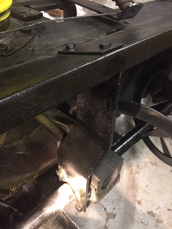

Unattach from this bracket first?

Do I have to slip the auger out from the gearbox to remove it? Sorry I just don't wanna ruin this trying to take the gear box off.
Or unbolt both sides of gear box and it will then just slide straight out?

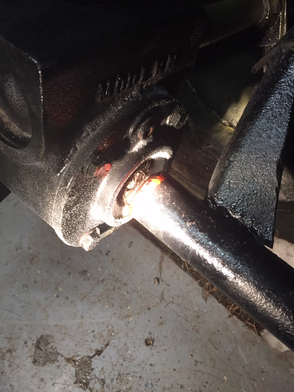

New info. I believe the shaft itself sheared? I unbolted the gearbox from bracket and it instantly rotated. When I spin the auger what is left of the shaft in the gearbox rotates. The shaft coming from the fan has no splines on the end of it it's smooth. I can figure how to post a video.

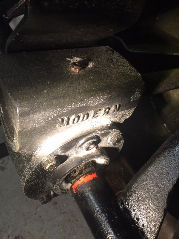

End of shaft from fan!

Well I just talked to dealer. The shaft is $130 to buy. They said it would be 8 hours of labor to take gearbox apart and fix it with a new shaft!!!!
8 hours???? Total price would be about $800.00!!
That would be new bearings and seal of course. Lol.
I guess I'll try to see if I can do it myself.
Is it really that long of a job???

Sure looks like that broke awful clean and straight. Whats the deal with the chamfer on the end? Was there machine work on it at that point or did that happen after it broke? If it were me, I'd take it apart and see if I could repair it myself since you know where to buy parts. You have already got it tore down that far.
/ Snowblower gearbox #17
Eight hours sounds ridiculous. I'd finish taking it apart (which should be a good bit of those eight hours...) and make sure that I understand the issue, but I do agree it looks like that shaft is sheared. If that's the case, I'd buy the shaft, the seals and gaskets, and a handful of the proper shear bolts and put it all back together myself. It shouldn't be too hard since you'll have just done almost half the work by disassembling it.

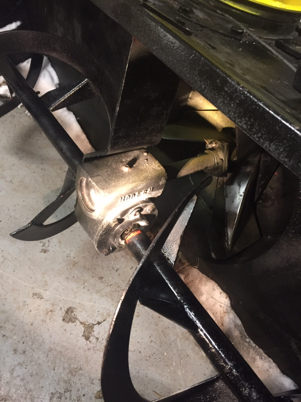

Here is where I am. How do I separate the auger from the gear box???

/ Snowblower gearbox #20
Each auger has its own shear bolt' Remove and pull the augers off one side at a time.
Then you can split the gear box and pull out the broken pto shaft end.
The gear box has one side that is a cover. Try the auger on that side first as perhaps you have enough room to play.
