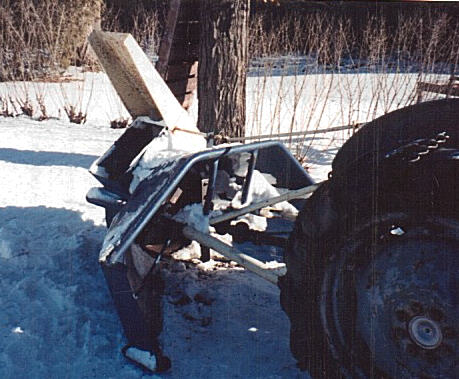

Don't know what you have that you are thinking of copying but we had a home made blower when I was a kid that worked really well, and we got a lot of snow there. It was a so-called V-type, where the tractor drives through the snow frontwards and pulls the blower. Are you familiar with these? In some areas they were made commercially. Rather than an auger the pto spins kind of a fan or paddle type blade.
I have one of these now and it works not too badly, but in wet stuff it can clog up a bit. The one we had before didn't have any fancy curved sides and it didn't clog up so much. The curved sides work well in powder though.
Jim
