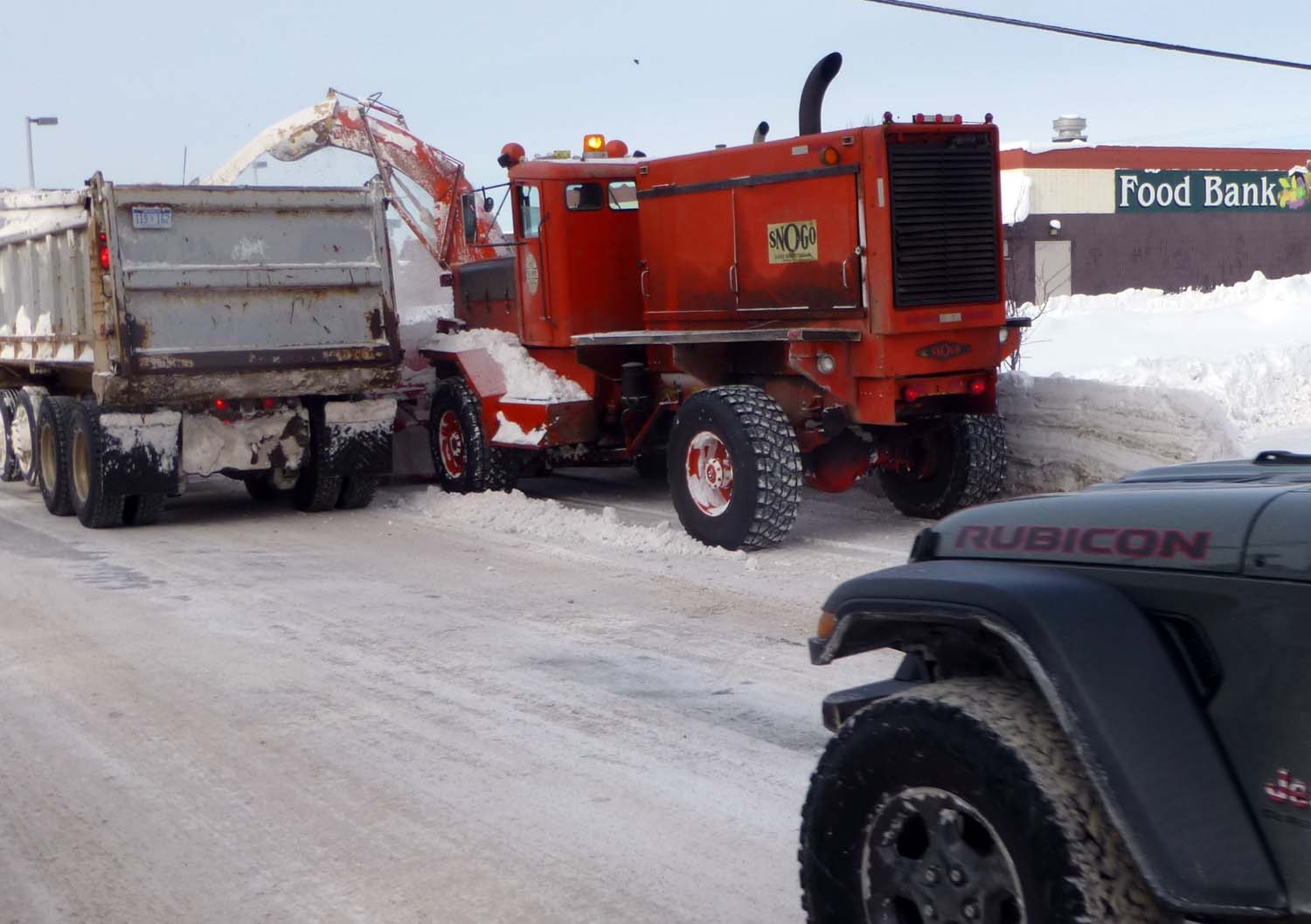

Gee, we see SnoGoes operating here each year. Just following
