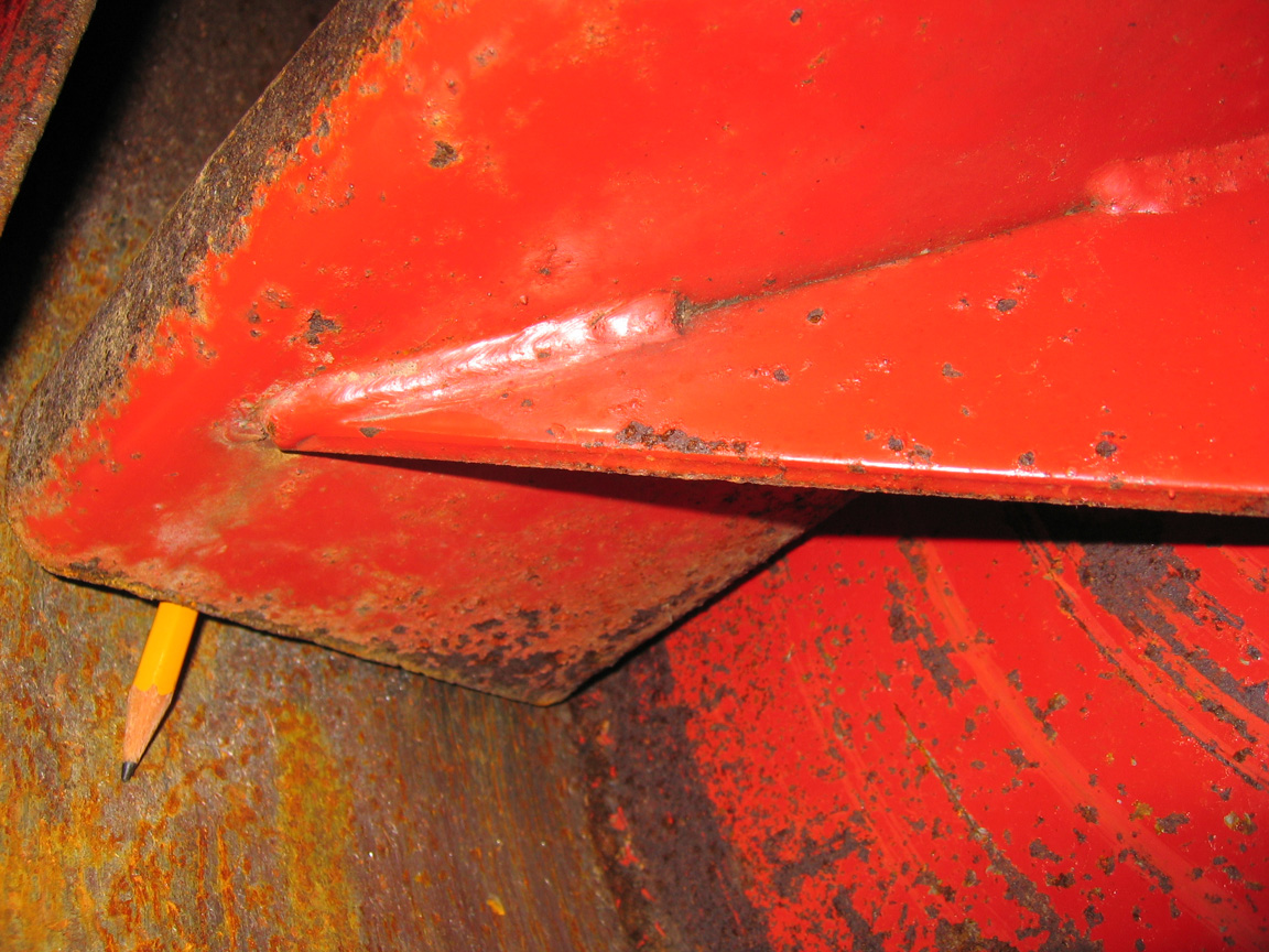

This is great. I appreciate all the insights!
After double checking (and actually measuring) the clearance between the fan and the shroud, .200" is the best case. Because the wall has been dinged up, some areas are more like .250"-.375" clearance!
I just purchased from a local plastic supplier a .125" thick scrap of UHMW PE sheet. So as an experiment, I'm going to try lining the shroud housing with it which will close up the gap and provide a slippery surface. I also got enough to line the chute if I want. Any ideas on how to attach this stuff? It doesn't bond all that well so I'm thinking I'll drill some holes in the metal and countersink some stainless flat head bolts into the polyethylene with a nut on the backside of the steel.
While I've got the impeller off I think I'll clean it up, prime and paint it. Since it's small enough to take inside and can do it in the warmth.
I'm fairly inexperienced when it comes to painting previously rusted surfaces... is it better to thoroughly clean off every speck of rust, prime and paint or use a rust converter? Someone mentioned good enamel paint. I've also heard of epoxy paints and powder coat paints.

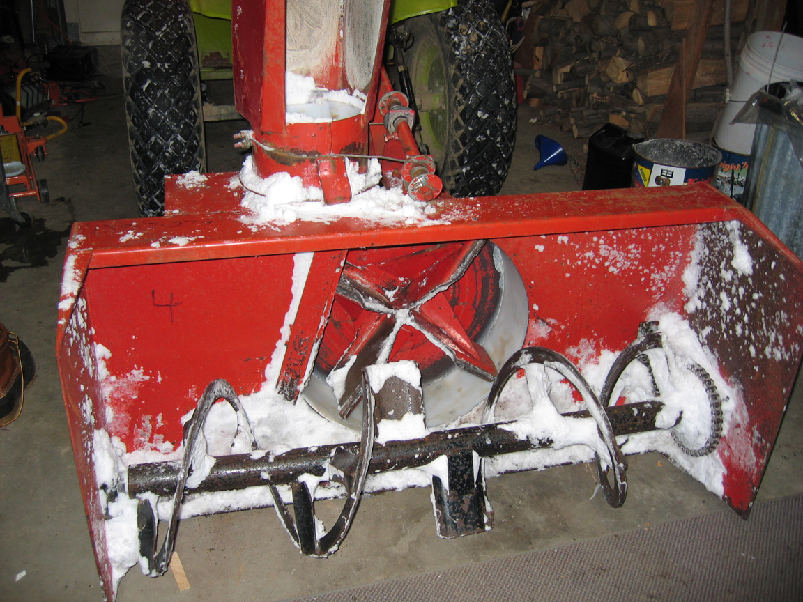

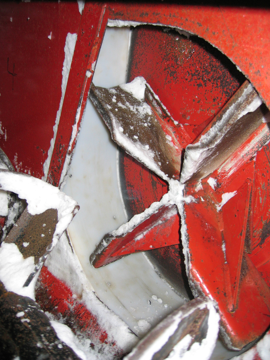

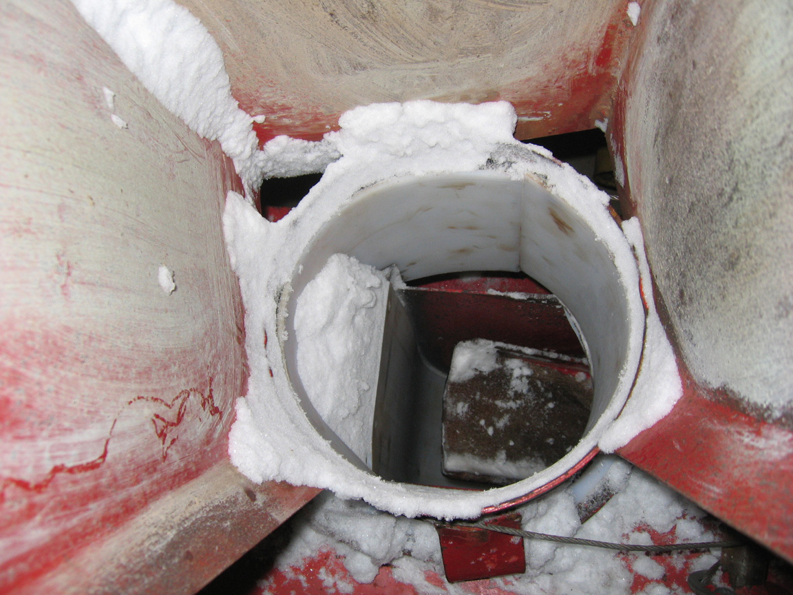

Here's an update on the blower tweaks...
I've lined the blower housing with some 1/8" UHMW polyethylene to reduce the clearance and to provide a non-stick, abrasion resistant surface. I've also lined the circular tube on which the chute pivots. This is where the snow plugged previously. What a difference! I scraped all 3" of fluffy lake effect snow we got today into a pile about 16" high and backed into it at full 2540 RPM which gives me 540 RPM at the PTO. The blower worked much better! The snow went a good 20 feet. Now I'm looking forward to a real snowfall of a foot or more!
I've already promised my daughter that if we got a foot or more I'd blow all the snow in the backyard into a giant pile for her to climb on. :D
Here are some before and after pictures. I should also mention that I knocked down some of the rust in the chute with 36 grit sandpaper and threw some turtle wax on the chute and fan. Next summer I'll strip the wax and paint it with POR-15.
Pray for snow!
Craig
