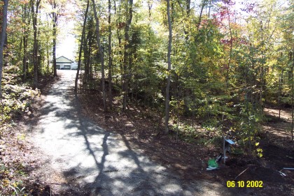

"If you've got a steep driveway"
Yes I do...300ft of uphill. (See attached)

Very nice property. Does your tractor have 4wd? If so that may be enough. If not, you will need chains. I have turf tires and 4wd is enough for my needs but I don't have much of a slope to contend with. Also, is that a gravel surface? If so I would be very leary of using a snowblower on it unless you use casters to keep the blade up from the surface, otherwise you will pick up stones and hurl them great distances, and someone could get badly hurt.

I'd get tirechains for that driveway. My concern would be icy conditions and not the deep snow. R4's or Ag's are likely to just slide right down that hill, turf tires would be better but I don't think I would take any chances.
