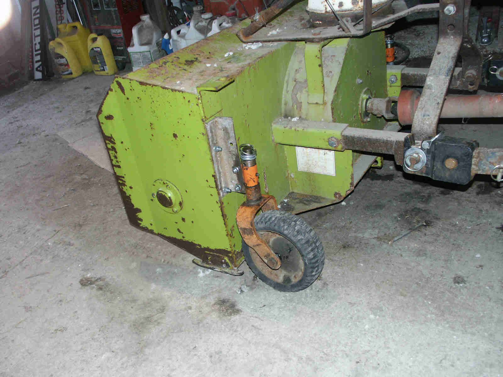

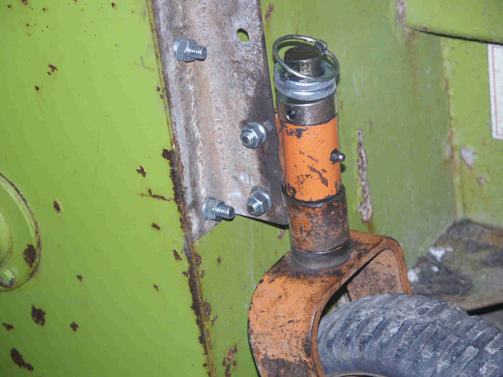

After many years I am tired of raking the rocks out of my yard from my snowblower. There seems to be no way of controlling the height of the blower above by crushed stone drive. Its even worse now that I added the quick hitch adapters that move the blower farther back so that it raises and dips even more when the front wheels go over a bump or in a low spot. I took the gauge wheels off my rear mount finish mower, brackets off my old mm finish mower, and a couple of pieces of angle iron and mounted them on the back of the snowblower. The height is adjustable by moving the spacers up or down just like they were on the mower. I think I will also be able to control the height somewhat by adjusting the top link. Now I am waiting on more snow to try this out. Pictures are included.

That should work to keep it out of the gravel!! However, make wure you pick it up before backing up, as the wheels will not be able to pivot like they would on the MMM, because it looks too close to me. Although, the work is not done in reverse with a snow blower is it? :D :D Straight ahead!!
Mike
/ Snowblower wheels #4
That looks like it should work!
I have often wondered about some small wheels at the fron and back on a snow blower. Just enough to keep it from scraping up dirt, gravel, etc.
Looks like a solid idea.

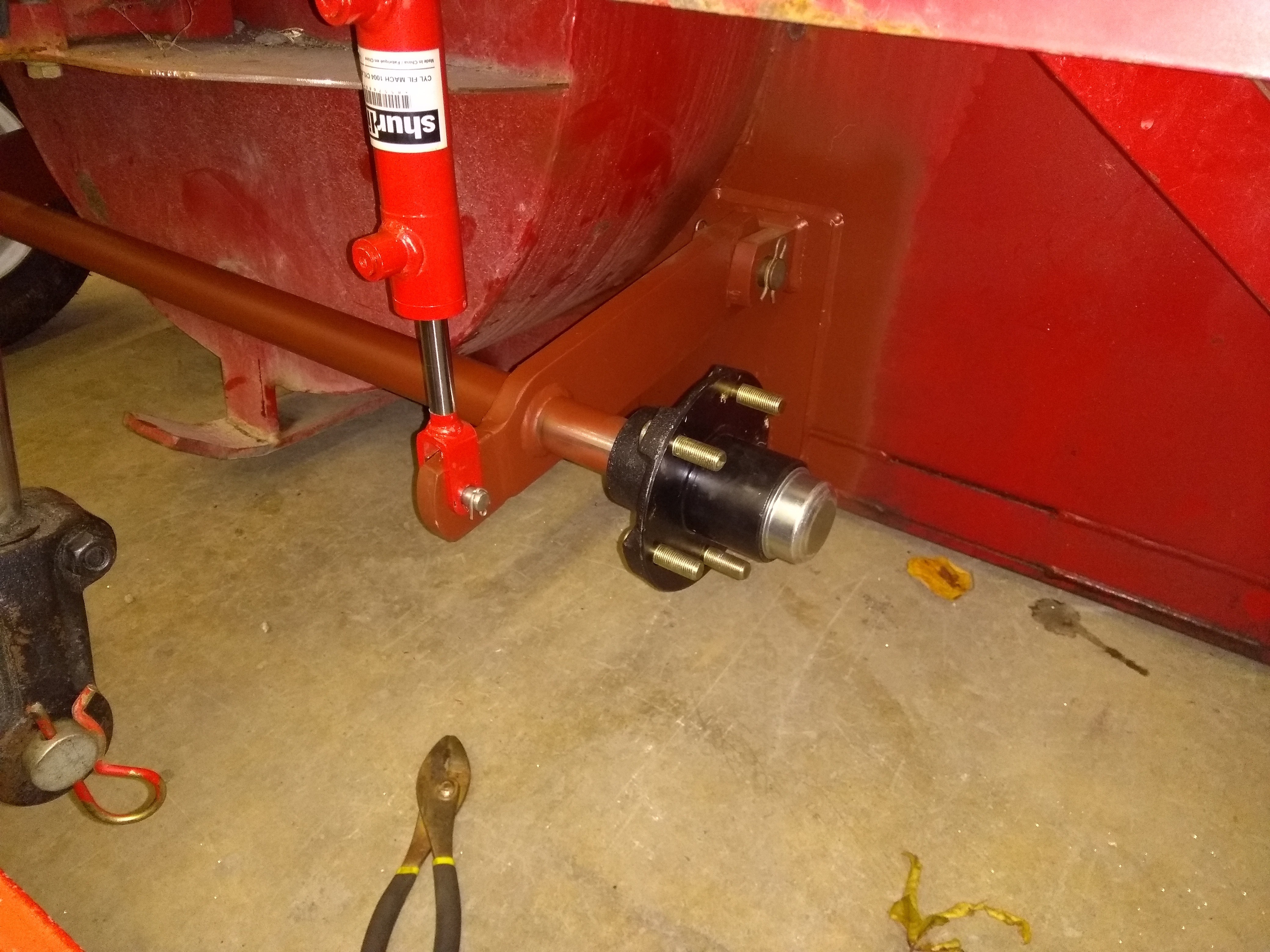

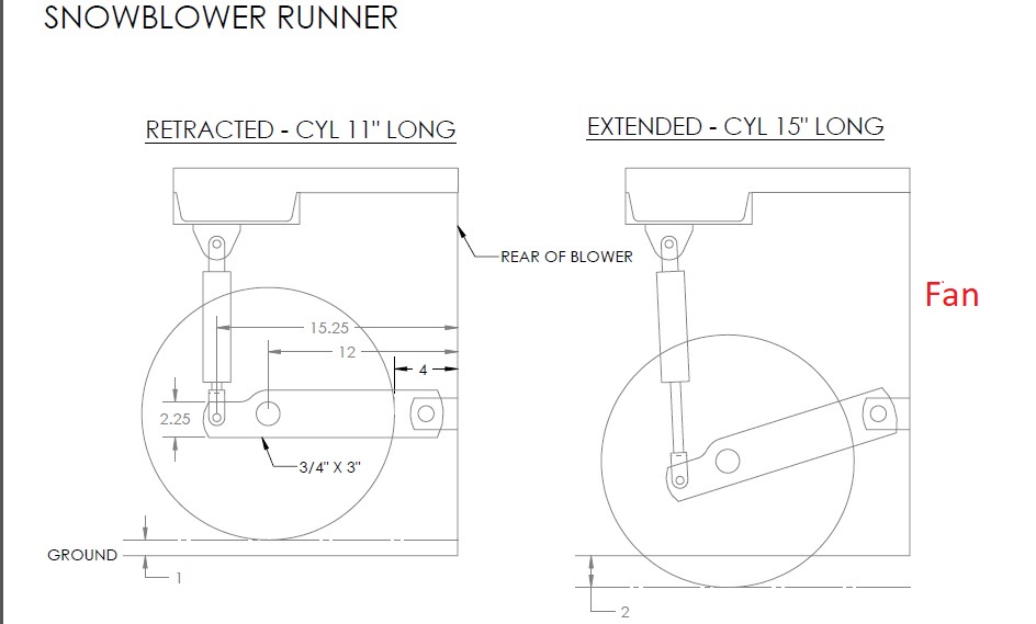

My wheels can be height adjusted hydraulically.
Avoids blowing ground and gravel until everything is frozen solid.
