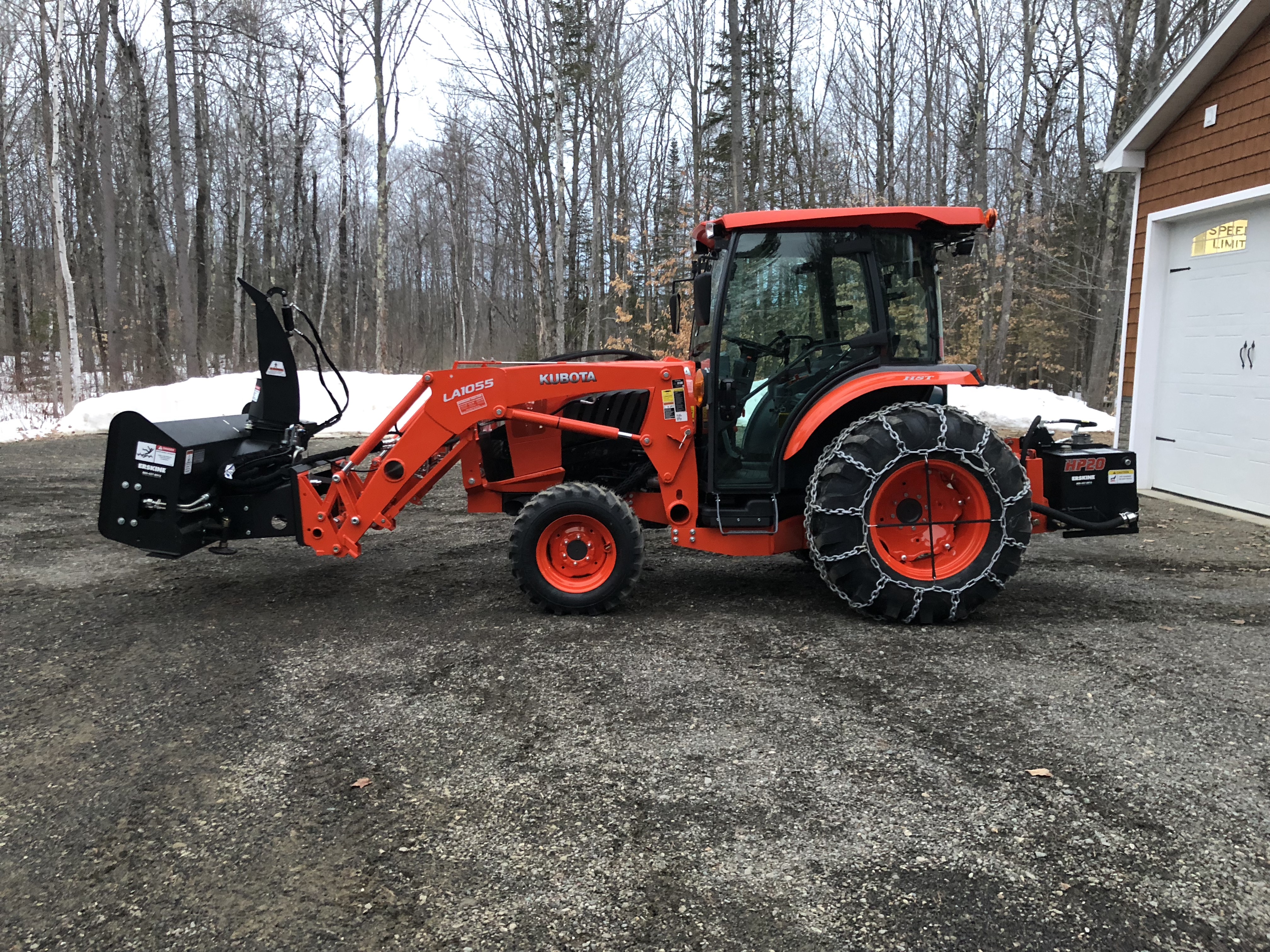

This is a Grand L6060 with a 80" hydraulic snowblower. The hydraulic blowers attach to the loader arms, giving you a lot more adjustment for the blower. It has a cutting edge just like a bucket and will lift as high as the loader arms will reach. This will take care of any snow mother nature can dump on you. I don't use the chains but on your hilly terrain you would want them. Like another post said we love helping you spend money.

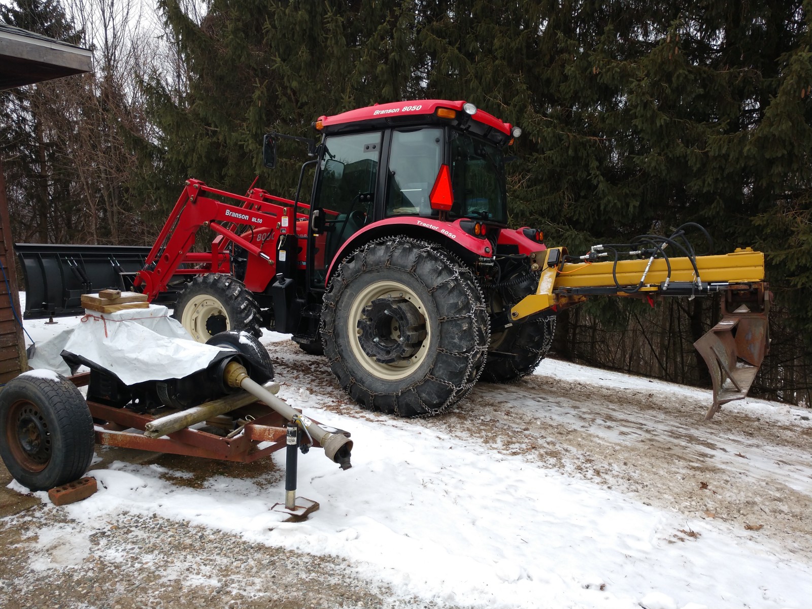

My driveway is only a quarter of a mile, 25 years ago it looked a lot like yours. I spent quite a bit of time widening it.

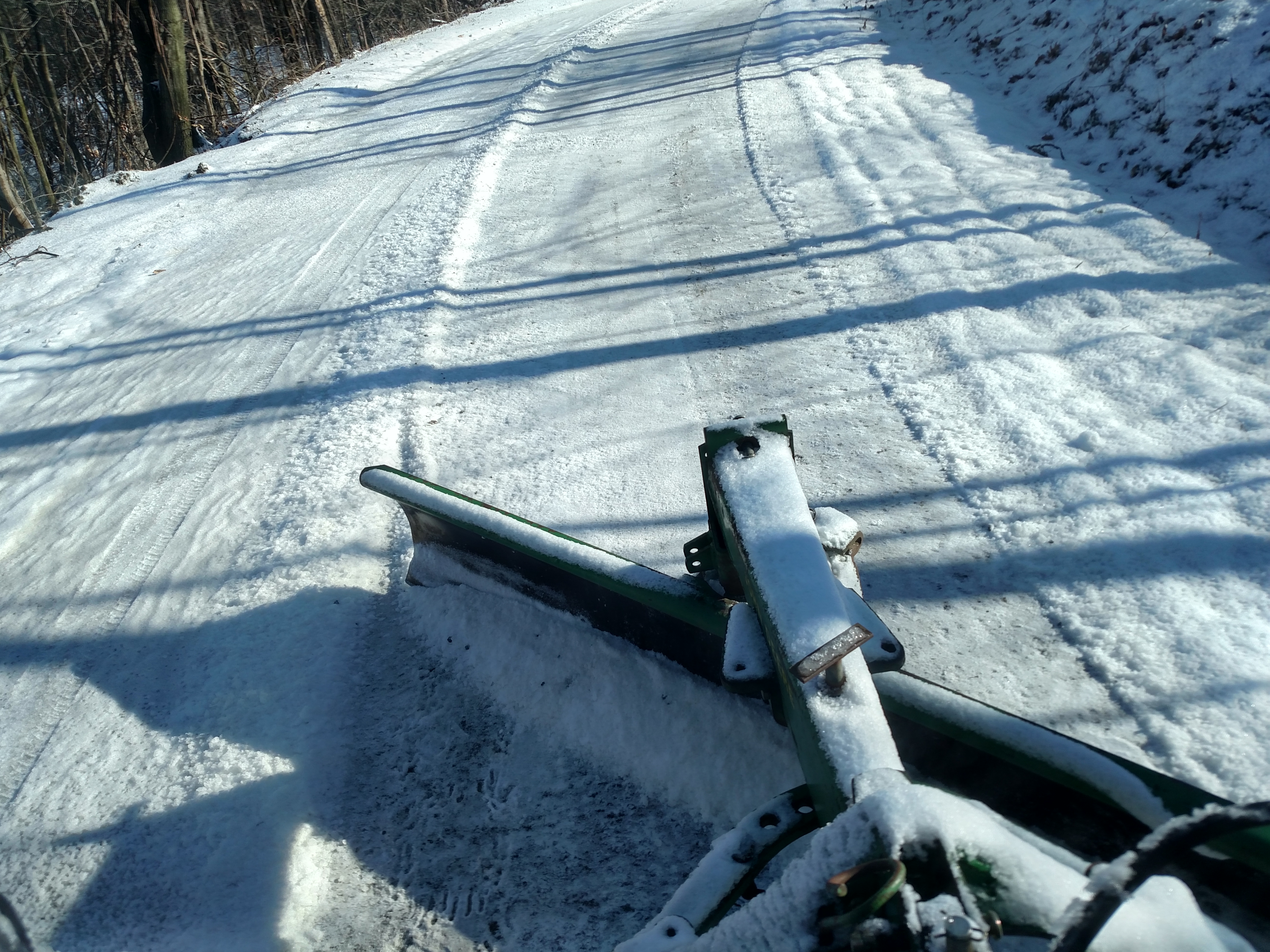

I normally use a blade to clear mine as it will get it cleaner then a blower. I also use my back blade more then my front blade.
My travel speed with the rear blade down and being pulled is higher then my pushing speed for the front blade.
The rear blade will bounce and jump or stones and frozen ruts, the front blade is bouncing on the trip springs all the time.
I go slow blading the snow off, 5-7 mph with the rear blade after the first couple of times, the first time after it has frozen up
it's only 2-3 mph and when it hasn't froze the surface it's maybe 2 trying not to dig in and move too much gravel.
I normally do not bother trying to plow going up the driveway, with chains on it is possible to do so however it does make it dig and chew
and is rougher on everything I find it much easier on me and my equipment to plow down hill and reverse back up for the next pass.
With a back blade that is wider then your tractor when angled and especially if it can offset there is no need to have a large back on the down hill side of the driveway.
I do not plow any snow towards the high side of the driveway, that side has a small ditch were the bank meets the driveway and a small border that I leave unplowed.
That unplowed section is to aid in slowing or stopping a vehicle that wants to start skidding and sliding. I plow every thing to the low side were it can go over the bank.
One advantage to a front mounted blade is that the angled blade will tend to push the front end away from the edge, a rear blade especially when offset
will have a tendency to try and shove the front end toward the bank. One way to prevent that is to turn the blade a 180 and push with it then it will be trying to push the
front axle into the roadway.
I have a blower and while it is nice for the deeper snows it is slower then a blade, I would prefer an inverted pull type blower but I'm cheap.
Also a blower would be difficult to get way over toward the downhill bank.
With a blade I have many times found myself riding on packed snow and ice on the downhill side which gets your attention.
The larger bi-directional tractors would be ideal many times. The Versatile or New Holland are hydrostatic drive the rebuilt and replacement cost is high
when they go out.

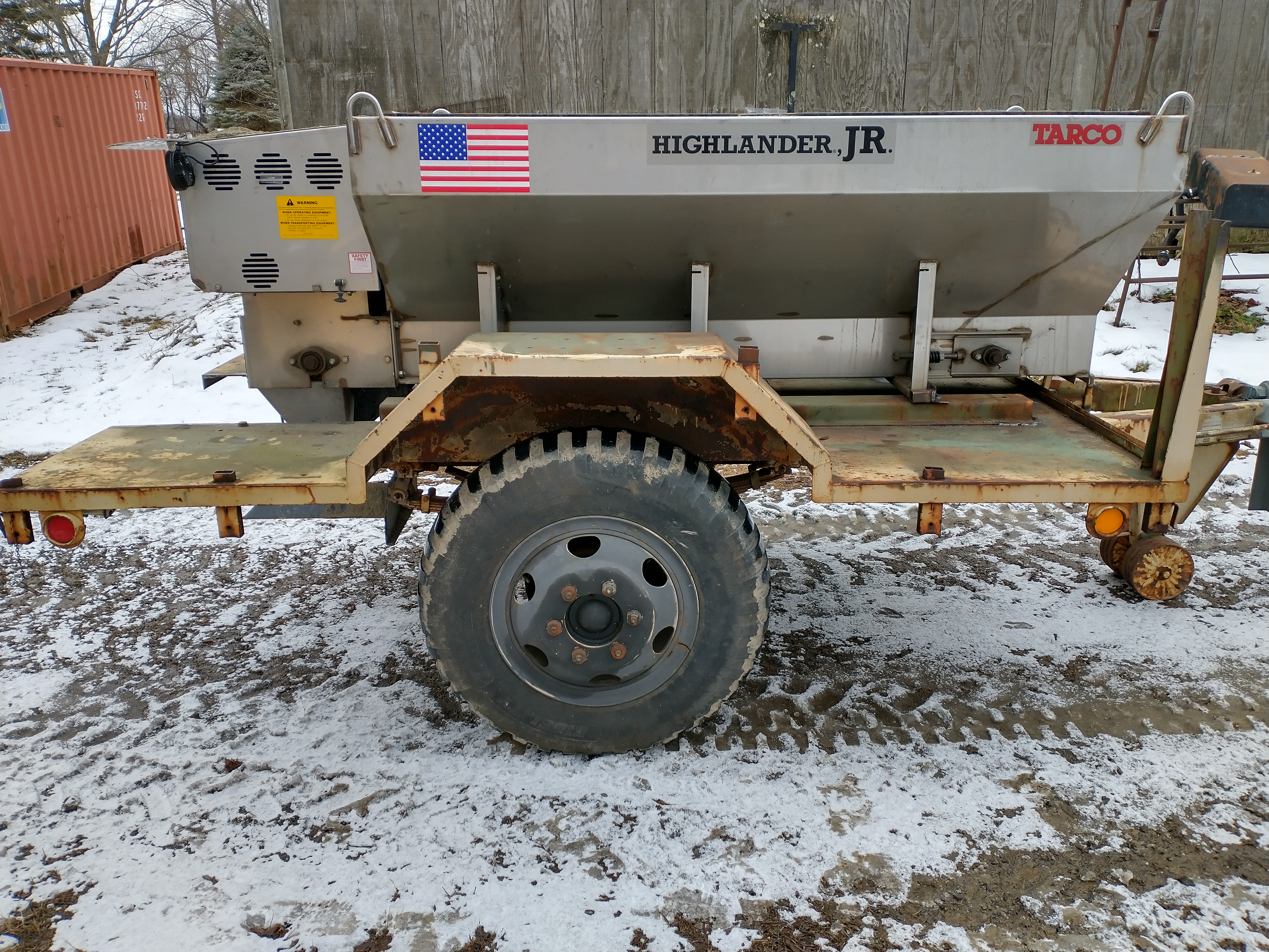

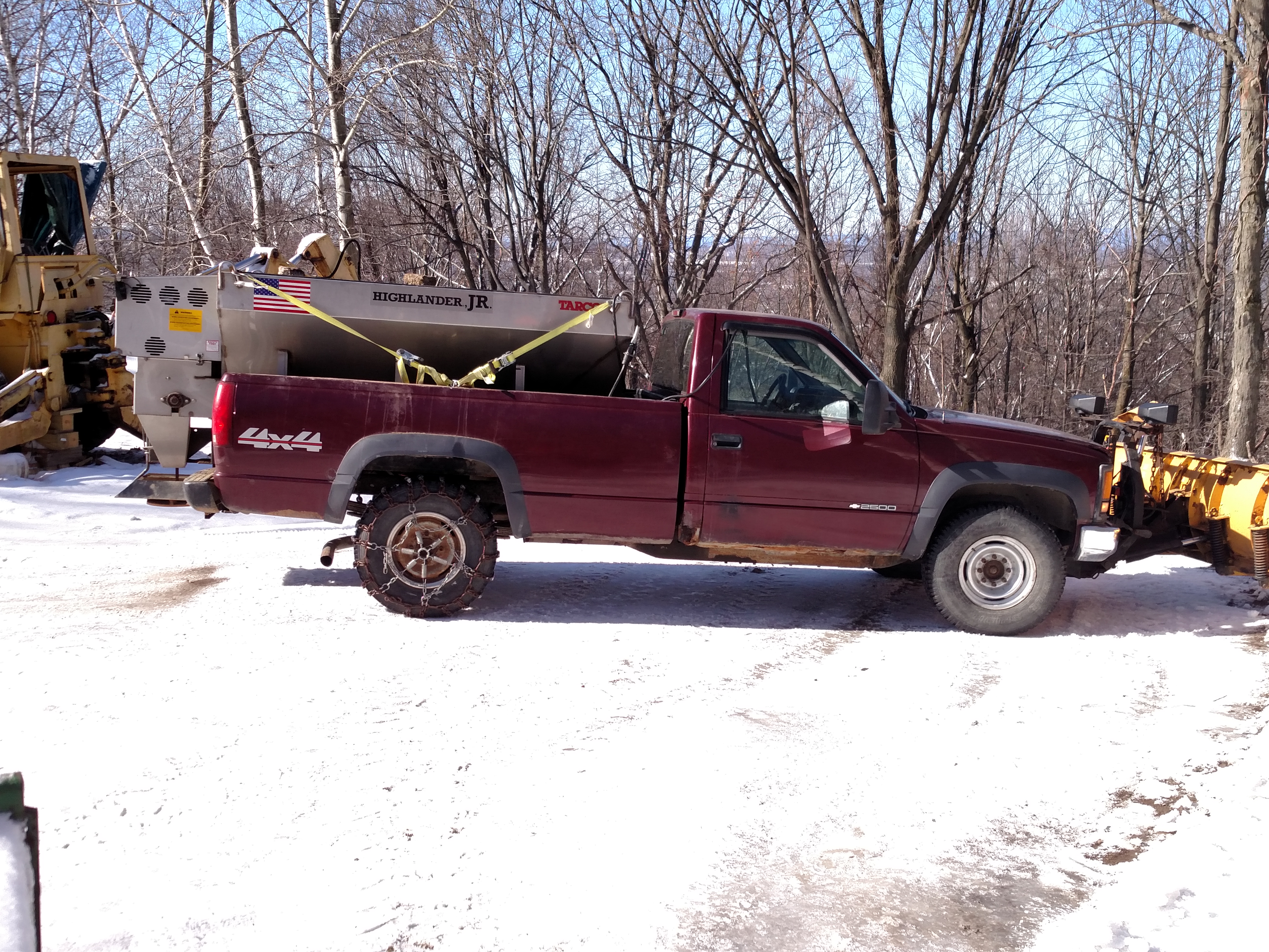

Also on the sander issue;
I've had a sander for many years after several of sanding from the back of a pickup while someone else drove it.
A sander will cover 4 times the driveway with the same amount of sand and 10 times faster.
I use a smaller sander that would not kill a 3/4 or one ton. For many years I kept a truck for sanding even though I didn't plow with it,
with chains and a loaded sander it would go through quite a bit if necessary.
This year I am switching to a trailer for my sander it will need brakes and tire chains to be controllable going down a slippery drive.

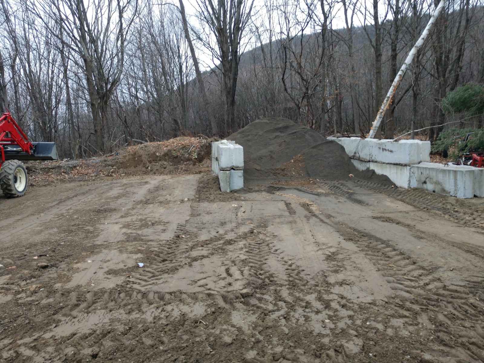

Sand will need to be mixed with salt when it is stock piled and covered, salty sand will never dry out as the salt will absorb moisture.
It will need to be covered to prevent snow and rain from diluting the salt and then the entire pile will freeze into one big chunk.
Also you can not load a sander before you are going to use it as once it's out of a pile and exposed to the air temps it will start
to freeze to your sander, unless you have a nice heated shop to park it in.
