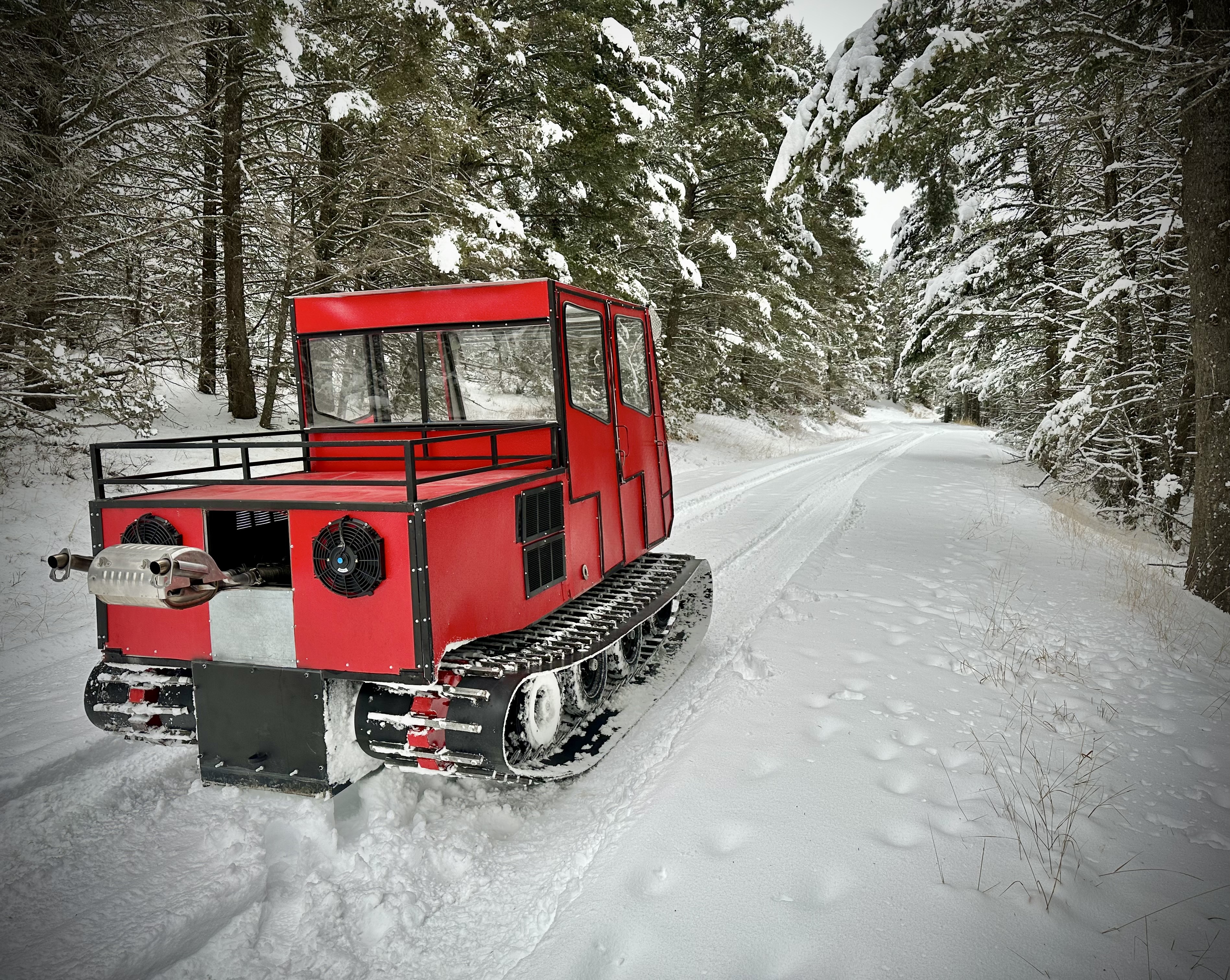

I have a DIY snowcat I built ground up with 1 ton differential/brake steer configuration that is somewhat spartan that I'd like to convert to hydrostatic drive. I'm a newb in this compartment, so bear with me. Looking for initial build ideas/concepts before possibly venturing down this path this summer.
Currrent engine:
Yamaha RX1 4 stroke/4 cylinder snowmobile motor 140hp/85ft pounds torque
Ideal RPM for this motor is 6-7,000
Internal gear reduction 1.19:1 at shaft

Arly: I’ve owned a Litefoot hydrostatic cat, a Bombi, tracked UTV, tracked ATV, tracked Samurai. I’m a lunatic and like the building process for some reason. But agreed, don’t want to reinvent the wheel. If I had an extra 80k lying about I’d buy a used PB Scout.
A guy in town built industrial tracked 8x8s for industrial applications and military for 20yrs. He was running 60hp diesel with hydrostatic drive. 3,000lb vehicles. Ultimately I need to sit down with him and figure this out. He’s got decades of building experience and is an engineer.
Still rocking the mechanical drive/CVT but building smaller drive sprockets and might gear the gearbox down a bit further.

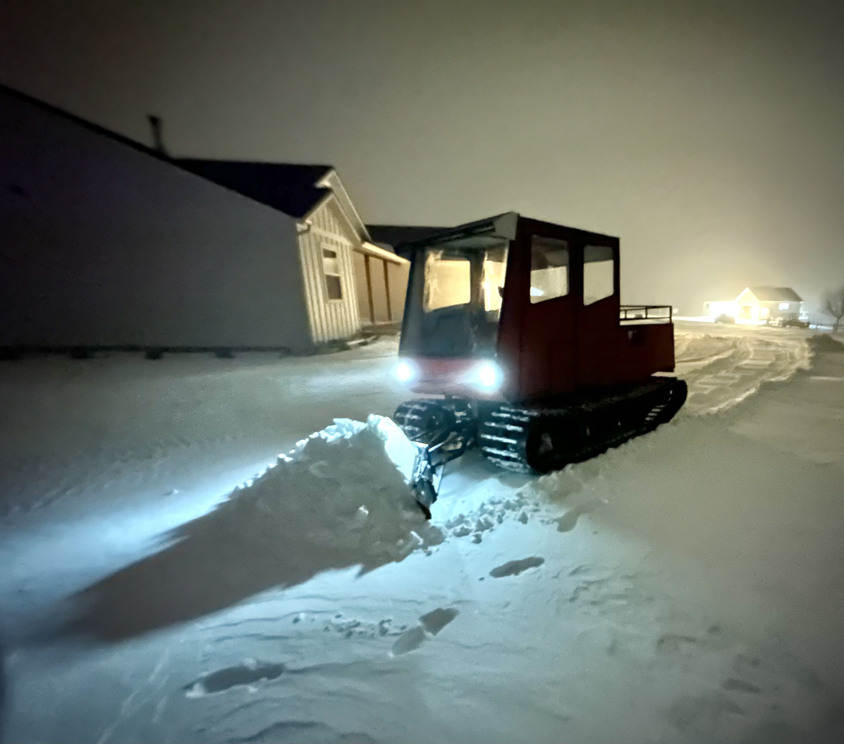

Still plows just fine with the arcane brake steer but hydro would be nice. Fun in the yard tonight.

Got the brake steer dialed in might forgo conversion. She’s running great. Thx for prior discussions.
