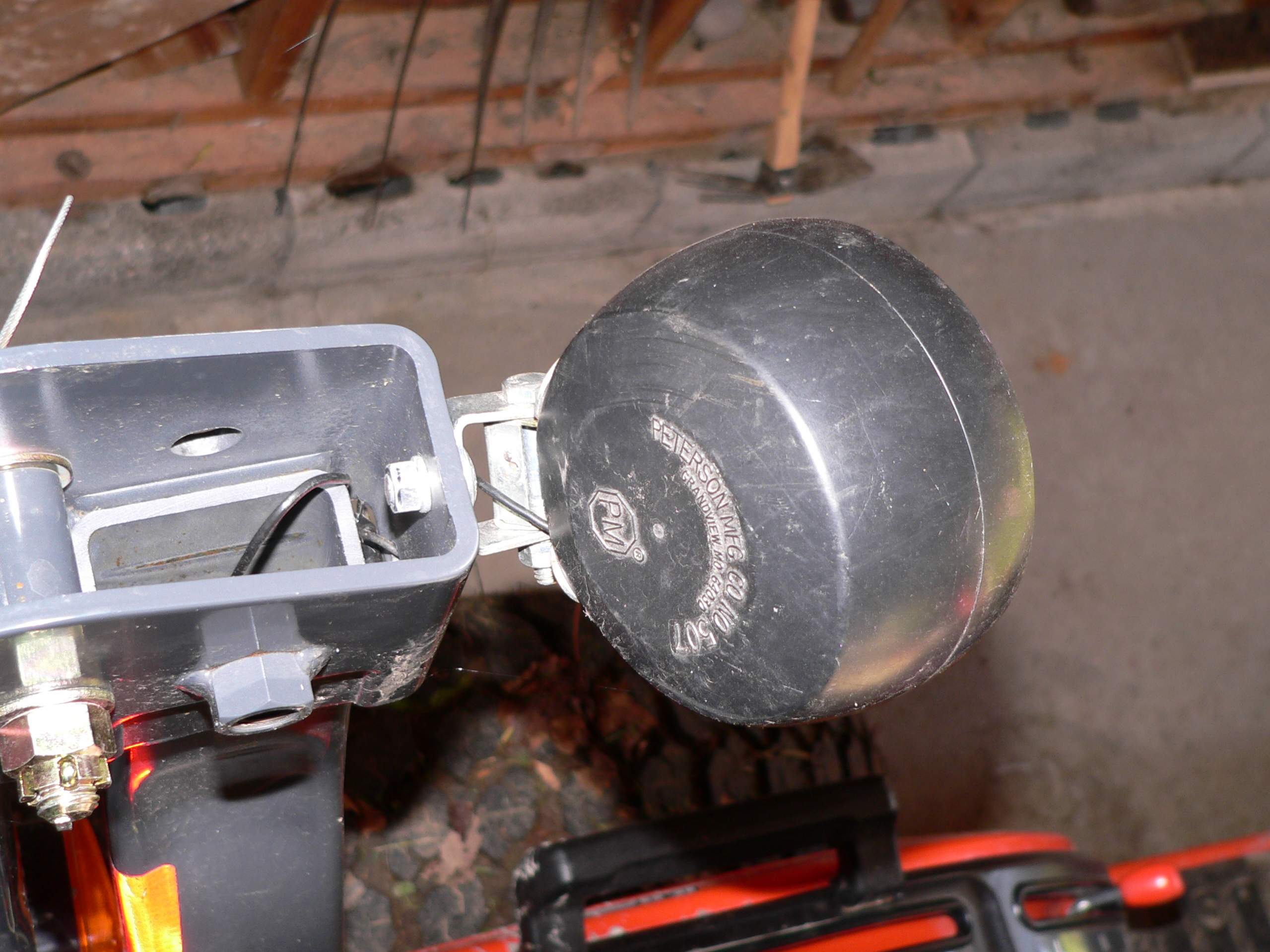

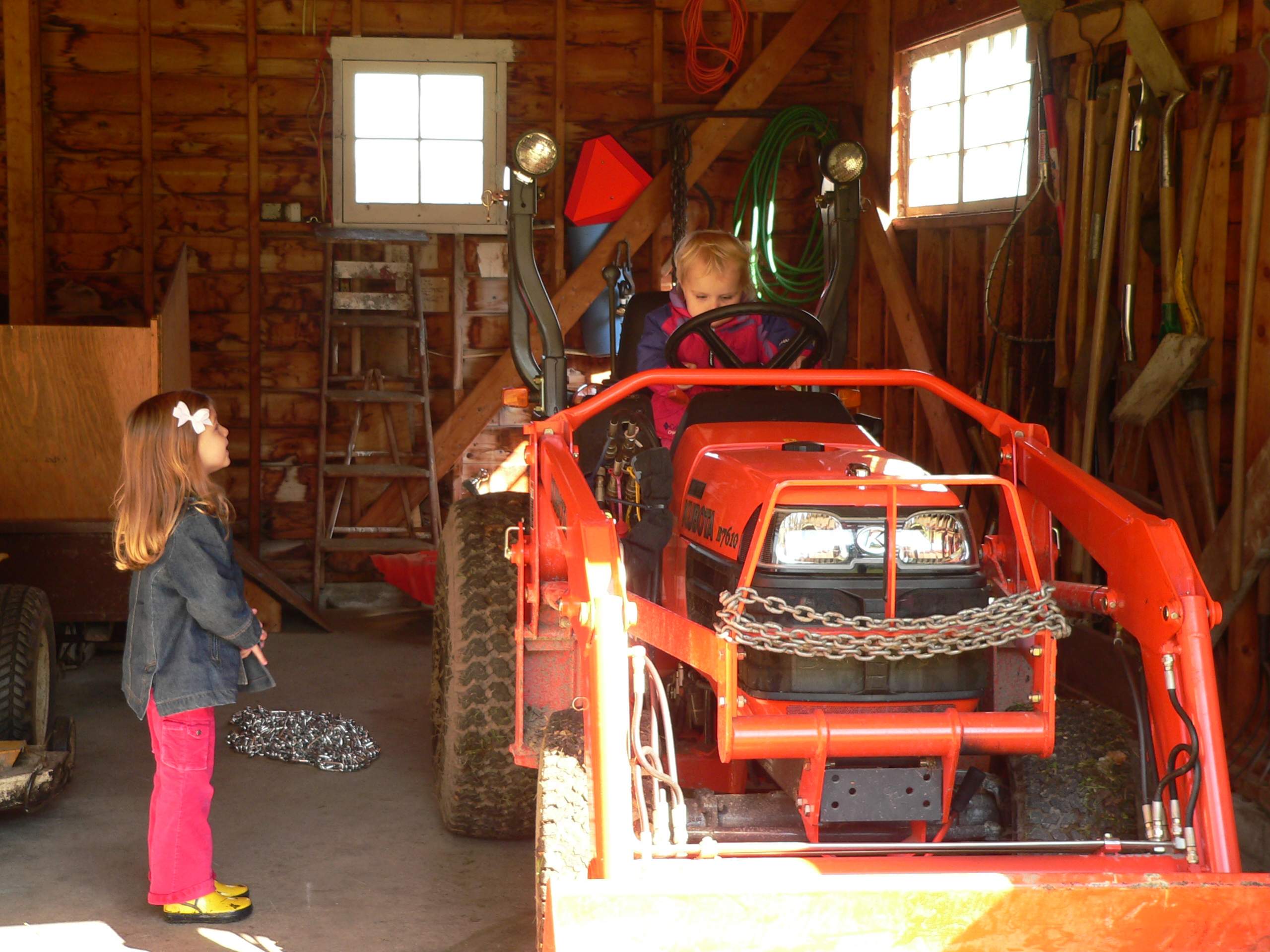

Here's my lights rigged to the Roll Bar hinge so they work whether it's folded or up...It doesn't fit in the garage in the up position....witness the chunk missing from the top jamb (people on gin and tonics shouldn't be driving tractors)
My little Kubota has a spade connector pre-wired for a rear work light. I run a rear light and just made up a "Y" connection to a switch in the kick panel below the seat. I had a marine grade push/pull swithch lying around from when I rebuilt my Boston whaler into a flats boat.
With the wire running up thru the rollbar it's protected. I wonder if your Deere has the same pre-wire to the rear. If it does it's under a 1 hour install. Just bolt the lights into the hinge (grind of the bolt so it's short enough to close the RPS). There is a stock hole in the hinge on Kubotas. The only hole I drilled was thru the plastic kick panel for the switch.
Pay attention to your available amps if you're running any other electrical add-ons.

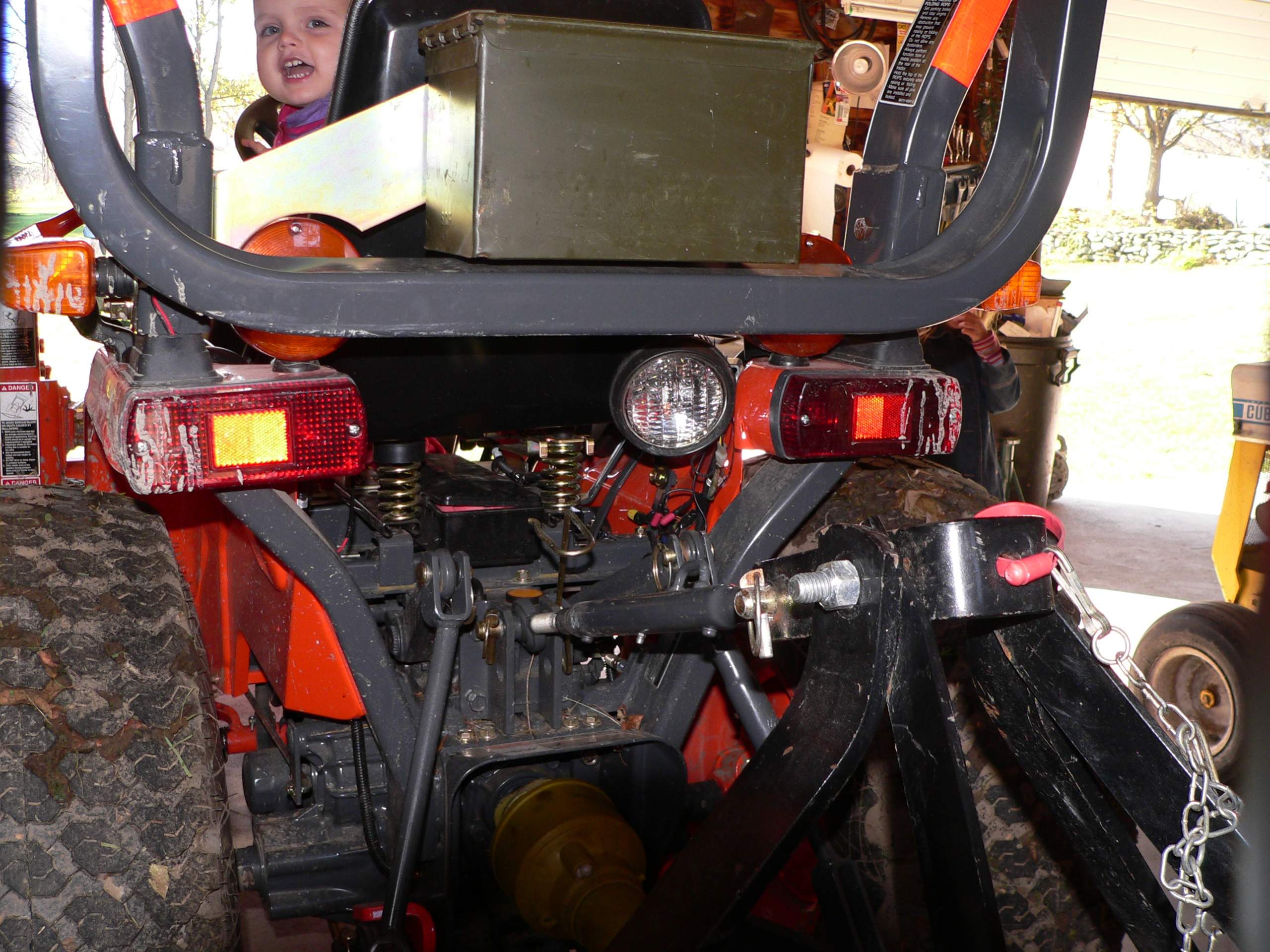

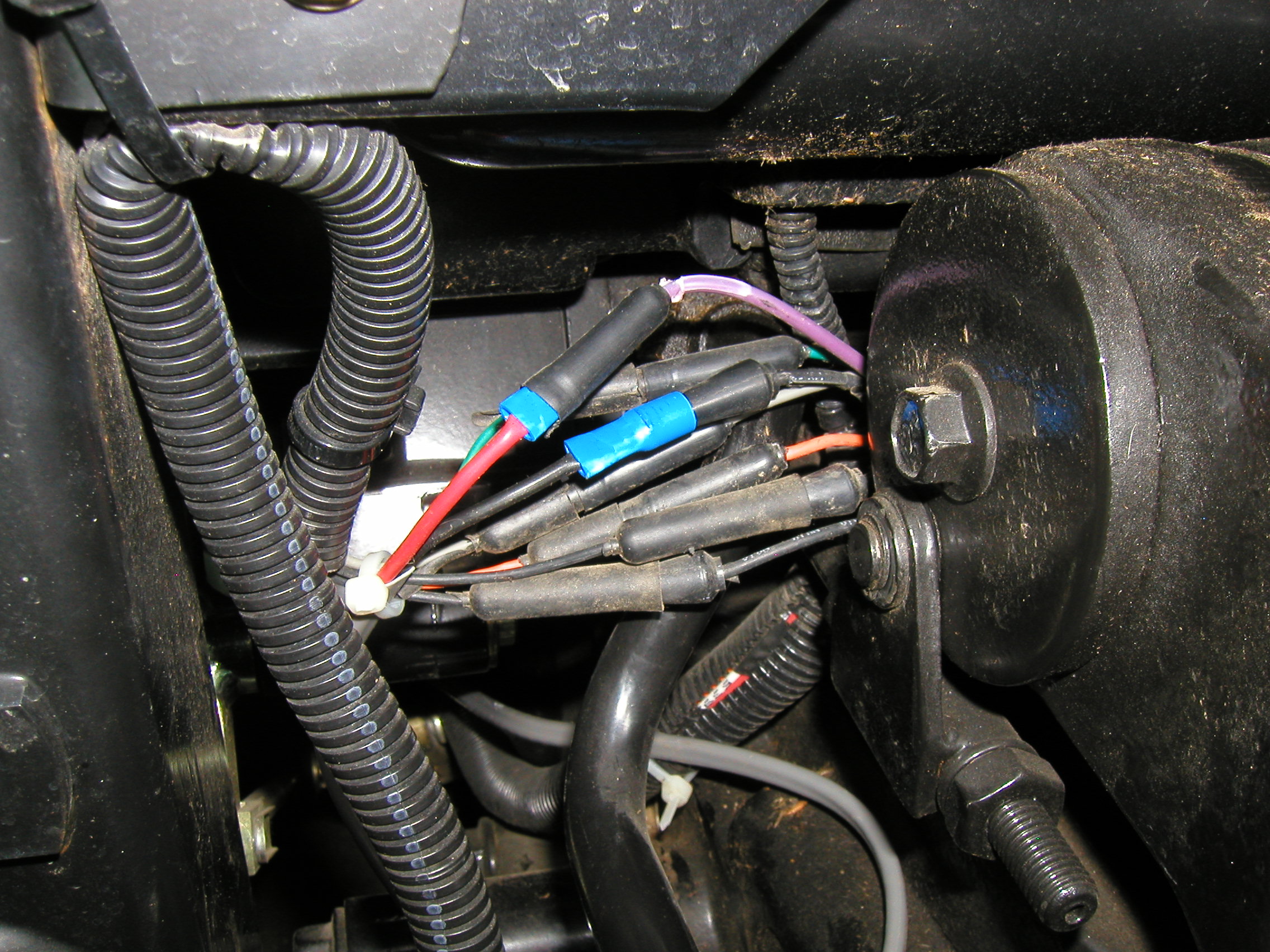

.... I've got a few spare electrical connections on the rear wiring harness.
Chuck
It's one of those!!! Should have read your post better. Get a $5 tester and just go with any free connection that is switched on/off with the ignition.
Install a rear work light for back up and changing implement. On mine there was a factory 3/8 hole in the fender to accept a generic $12 work light. Too easy!! Wire the rear light so it's always on. rig up a "Y" connector off the factory wire--one peice to the rear work light and the other wire off the "Y" goes to the switch (you supply) off of which you power both ROPS lights.
You will want the ROPS lights on a seperate switch. Trust me here. On a June night you will get a mouthfull of bugs...and you'll want to turn them off.

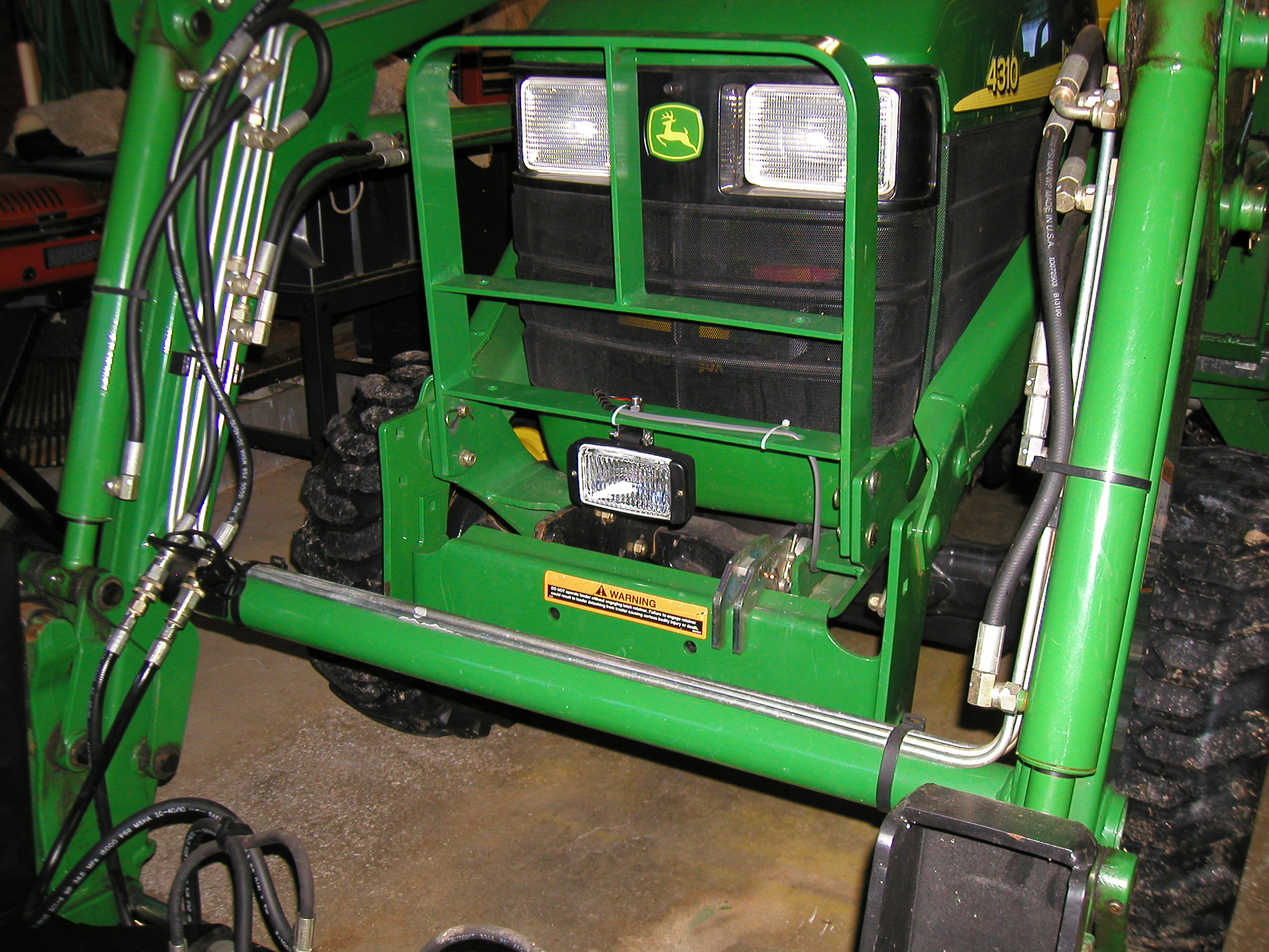

53- Thanks for the suggestion. The guys on the jd forum gave me the heads up on which electrical connections to use.

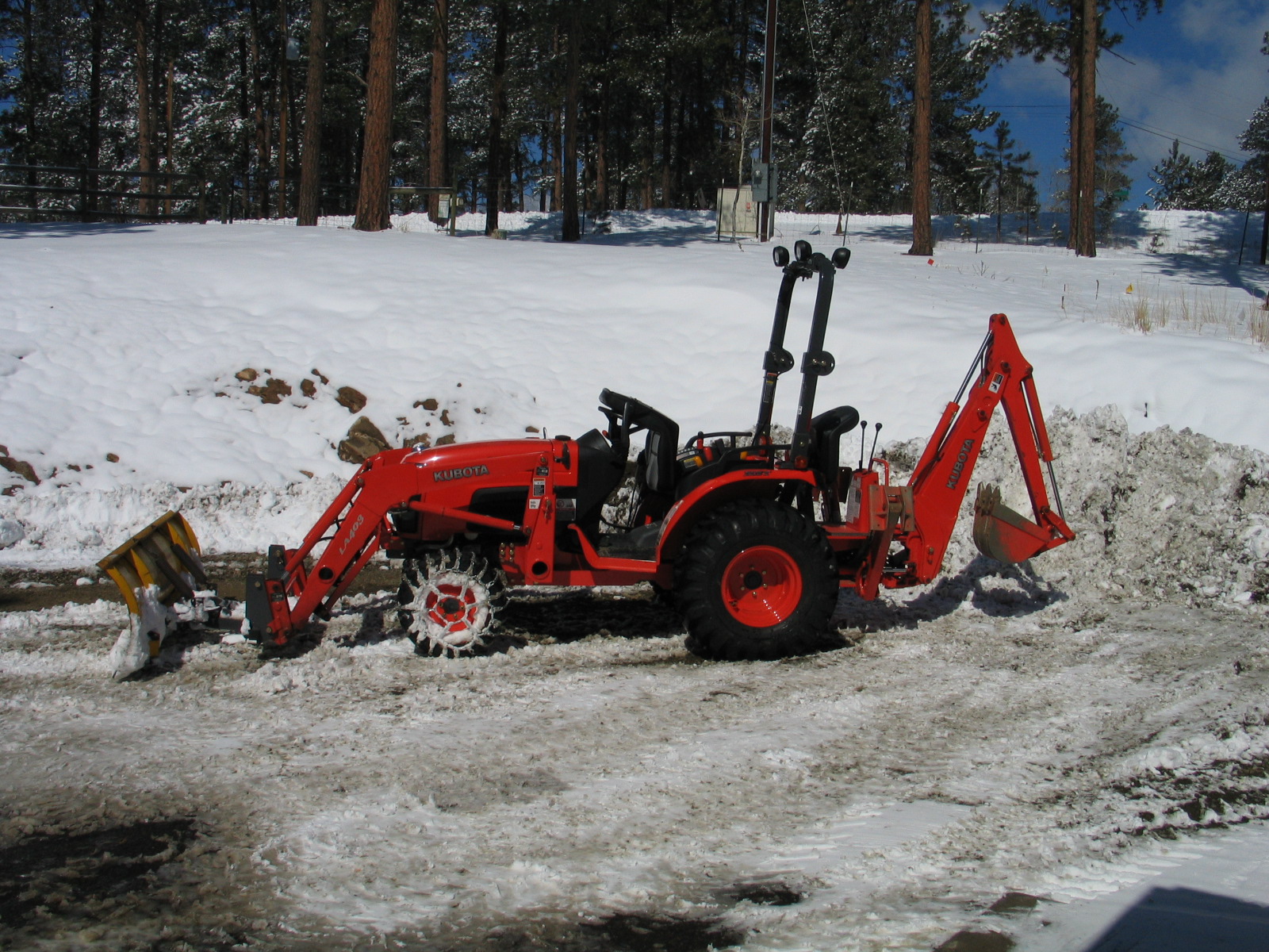

I should have mentioned that I need to keep the rops folded down to fit in the garage. It normally stays like that.
If it weren't for that, I would go with your suggestion Jim.
Why not modify the ROPS. Before I get shot down consider this:
You probably want to fit under a standard 7' (84") door way and your ROPS is currently around 92". If you had a non folding ROPS the spec height is 84" (according to JD site). Why not remove the top section of your ROPS and make a new section with a lower height? You are modifying a safety device but you can easily restore it to original.
