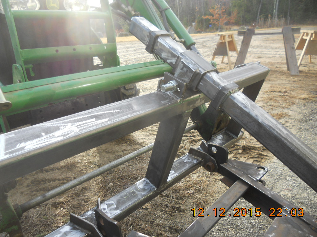

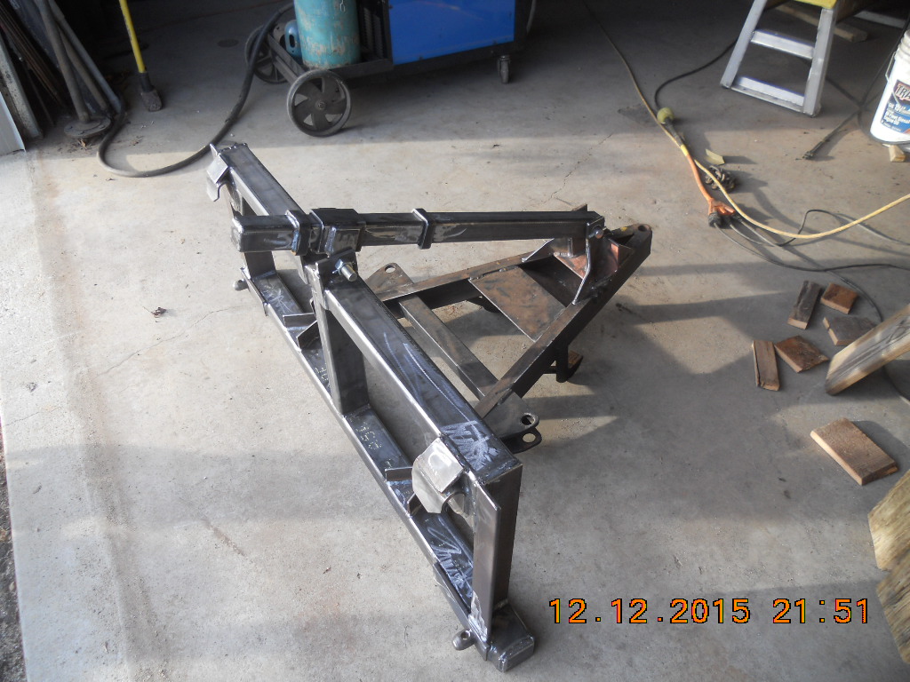

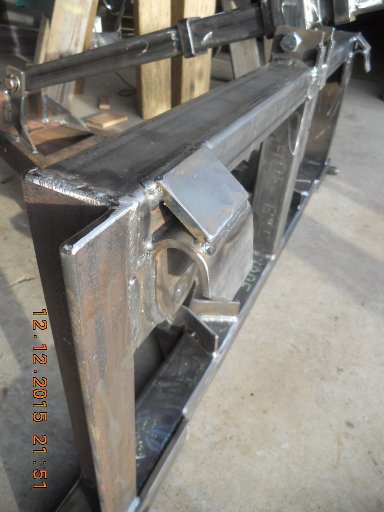

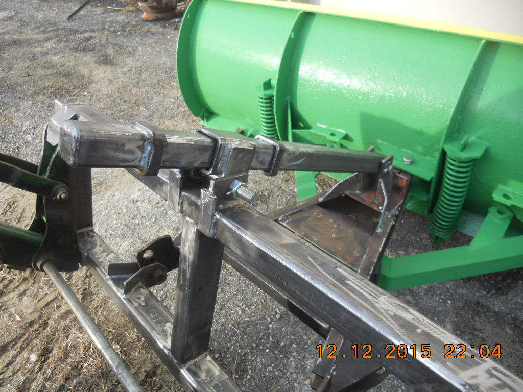

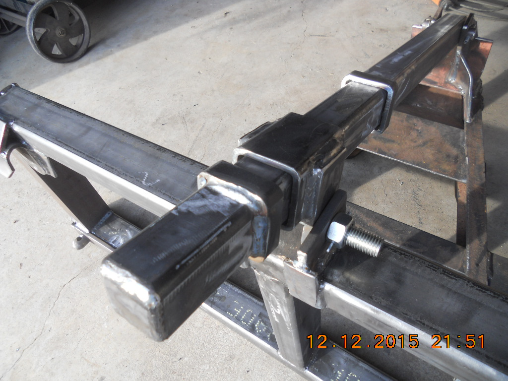

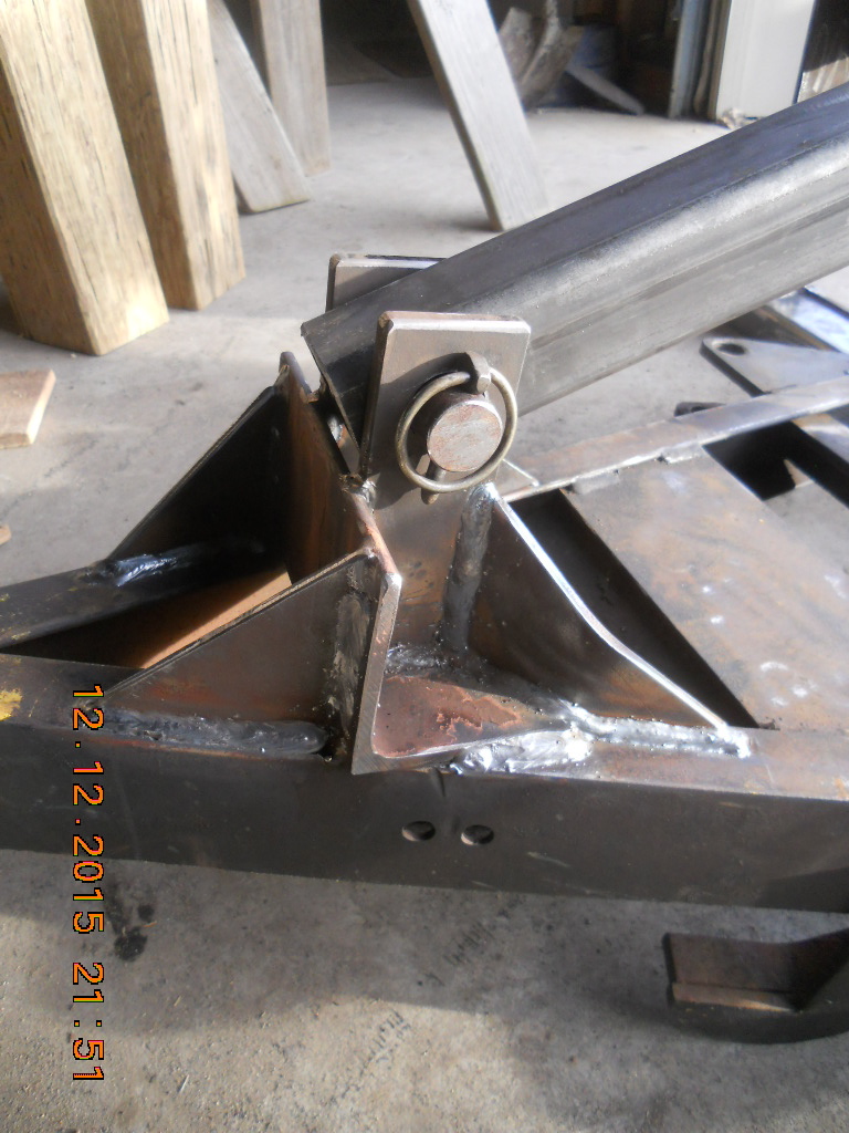

I've been making converted p/u truck snowplows for tractors & SS's for a while using this design that allows for float (normal) action along with down pressure. Notice the tube in tube with the welded stops on what could be called the "top link". If you can't see in the pics, you curl in the bucket function so that it hit's the stops and raise's the plow, and "dump" until you hit the stops for d/p.
On this particular plow I gave it 12" of plow motion before it hit either of the stops. You position the frame (bucket curl out) to a mid point between the stops, ( 3" each way to the stops) giving you 6" of travel down, and 6" up. You need to provide a pivot point at each end of this tube for the slight movement through it's arc, and it need's to be rugged. The geometry on this plow/frame worked out that each inch of travel on the diag. tube gave 2" of plow movement. The tube is 2x2x.25 wall, and the rectangular tube(s) at the loader are 2x3x.25 wall. Thought it might help someone.

Nice. One note, several people on here have had success with placing their pivot points ahead of the mounting points for the angle cylinders (so the blade is tucked in closer to the loader).
Less force on the front axle that way (because the blade is closer to the axle) and a little less risk of bending the loader frame.

I asked this guy if he was concerned about that, and he was not. It adds a lot ot time to the build (rebuilding the blade) this version is only about a half day job with only minor modifications to the plow it self. This design started out for me & 3 buddies with skid steers that had snow plows, and works fine in that application with the plow mounting only about 12" ahead of the front wheels. With the advant of tractors with ssqa in recent years……. . I think "snugging" up the blade for a tractor, esp. smaller one's is worth the effort for the sake of the tractor, loader, and performance. Frame mounting would be give the best results but most do not want to loose the higher stacking ability of loader mounting.

Basically, the lower attachment points (which look very thin on yours, btw... the truck plows seem to be 3/4" plate and I used 5/8" for mine) are set up just like yours are - they go well above the lower pin - on yours, you have a second set of holes there we can see. If a full SSQA adapter were used, when you rolled forward, the tops of those would very simply contact the plate and provide downforce. A shim can be added to lower the amount of travel before down pressure is seen. A traditional chain hanger takes care of float. This is a lot less fab work and less stuff to wear out/rust IMO.
