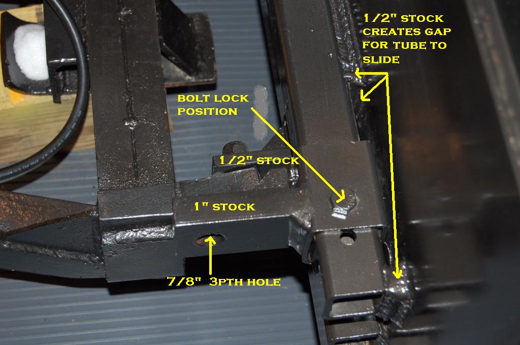

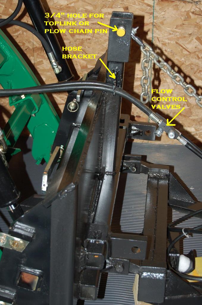

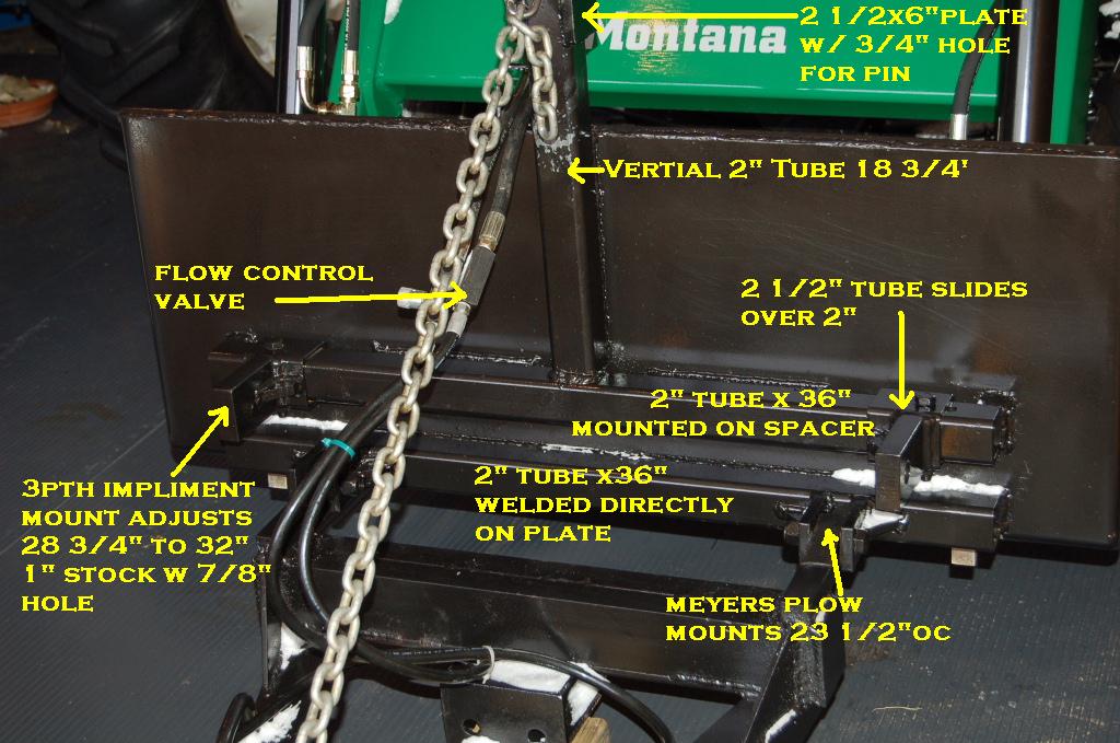

Hello. I'm back with more photos and dimensions for those who requested additional info on QA combination snowplow/3pth mounts. I also included more shots of my barn! Greg

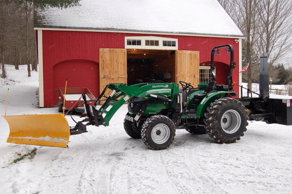

   / Snowplow mounted to QA plate #13
Great job on the plow. The barn is beautiful, it looks perfect in that setting.
How is the Montana holding up for you? It looks like a new machine.
Shane

Excellent! Thanks! :D

Thanks for the pictures and dimensions. Excellant job. :) I'll be building my version soon. Please keep the projects and pictures coming!
